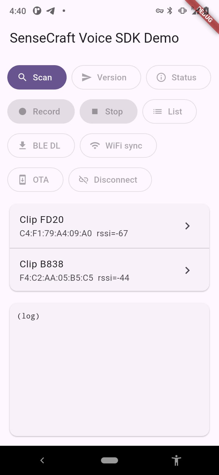

6. Using the Demo App
6.1 First connection
- Turn on the Clip device and make sure it’s not connected to another phone.
- Launch the app – you’ll see an empty device list and a log panel.
- Grant Bluetooth (and Location on Android 12L‑) permissions.
- Tap Scan – the app finds BLE devices with
"Clip"in their name. - Tap a discovered device to connect. Accept the pairing prompt if shown.
- Wait for the log to show
Connected. MTU=185– the AT channel is ready.

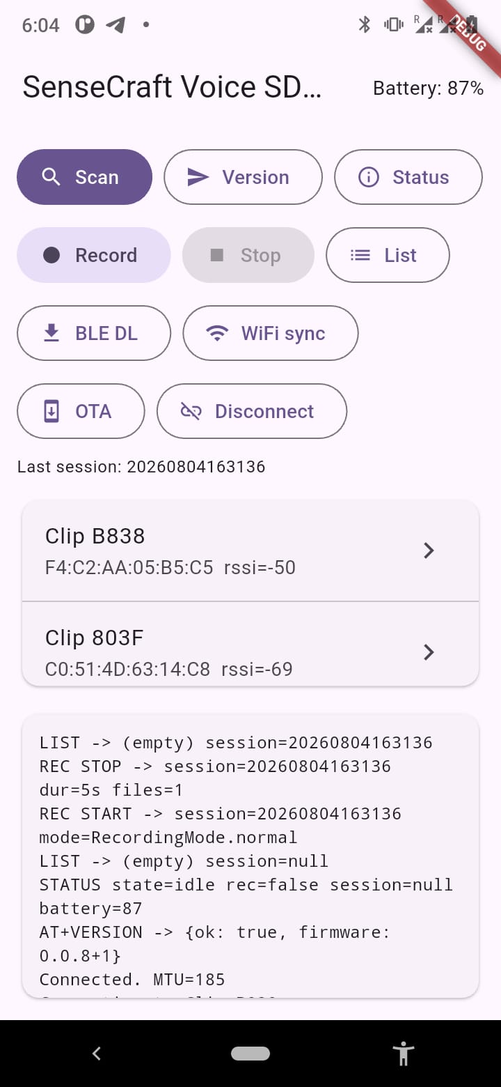

6.2 Button reference (after connection)
| Button | AT Command | Action |
| Version | AT+VERSION | Show firmware version |
| Status | AT+GSTAT | Show battery, free space, recording state |
| Record | AT+START | Start a new recording (normal mode) |
| Stop | AT+STOP | Stop recording; session ID and file count shown |
| List | AT+LIST | List recorded files for the current session |
| BLE DL | AT+DOWNLOAD | Download the last session over BLE (slower) |
| WiFi sync | AT+WIFI=ON + UDP | Enable AP, join phone, transfer over UDP (fast) |
| OTA | SMP/mcumgr | Pick a firmware file and flash it |
| Disconnect | – | Close BLE and reset UI |
Workflow: Record → Stop → WiFi sync (fastest) or BLE DL (no Wi‑Fi setup).

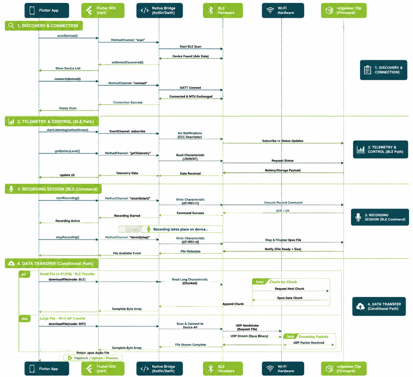

API Reference (Flutter SDK)
8. Overview & Architecture
The SenseCraft Voice SDKs communicate with a reSpeaker Clip device over BLE (AT/JSON commands + file download) and its Wi‑Fi AP (UDP binary file transfer). No API key or backend is required — the SDKs talk directly to the device.
SDK parity
All three SDKs (Flutter, Android, iOS) expose the same capabilities:
| Capability | Flutter | Android | iOS |
| BLE scan/connect/disconnect | SenseCraftVoiceClient | SenseCraftVoiceClient | SenseCraftVoiceClient |
| MTU management | MtuManager | MtuManager | MtuManager |
| AT(JSON) transport | AtTransport | AtTransport | AtTransport |
| Recording control | RecordingSession | RecordingSession | RecordingSession |
| Device events/status | DeviceEvent/DeviceStatus | DeviceEvent/DeviceStatus | DeviceEvent/DeviceStatus |
| BLE download + merge | RecordingSession.download* | RecordingSession.download* | RecordingSession.download* |
| Wi‑Fi hotspot control | WifiHotspotConnector | WifiHotspotConnector | WifiHotspotConnector |
| Wi‑Fi UDP transfer | WifiTransferClient | WifiTransferClient | WifiTransferClient |
| Wi‑Fi fast sync | WifiFastSyncSession | WifiFastSyncSession | WifiFastSyncSession |
| OTA firmware update | OtaSession | OtaSession | OtaSession |
| Permission facade | SenseCraftVoiceBlePermissions | SenseCraftVoicePermissions | SenseCraftVoiceBlePermissions |

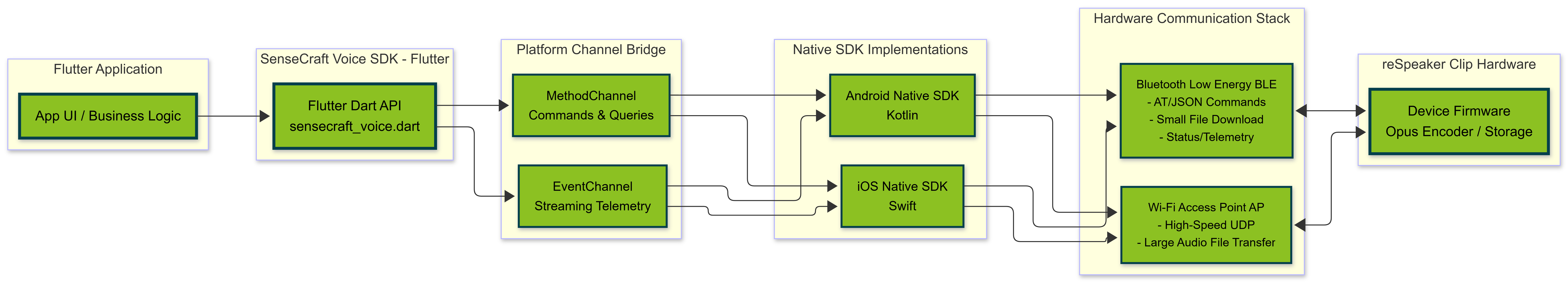

SDK layer vs product layer
| Layer | Scope | In SDK |
| Device protocol | BLE GATT, AT(JSON), UDP fast sync, OTA | Yes |
| High‑level session | RecordingSession start/stop/list/download | Yes |
| Product business | Recording DB, Portal JWT, transcription flow | No |
Platform requirements
| Platform | Constraints |
| Flutter | Dart >=3.6.0, Flutter >=3.27.0, dependency: flutter_blue_plus ^1.36.1 |
| Android | API 24+, JDK 17, Android SDK 36, Kotlin 2.1.0 |
| iOS | iOS 13+, macOS 10.15+, Swift 5.9, CoreBluetooth + Network + optional iOSMcuManagerLibrary |
