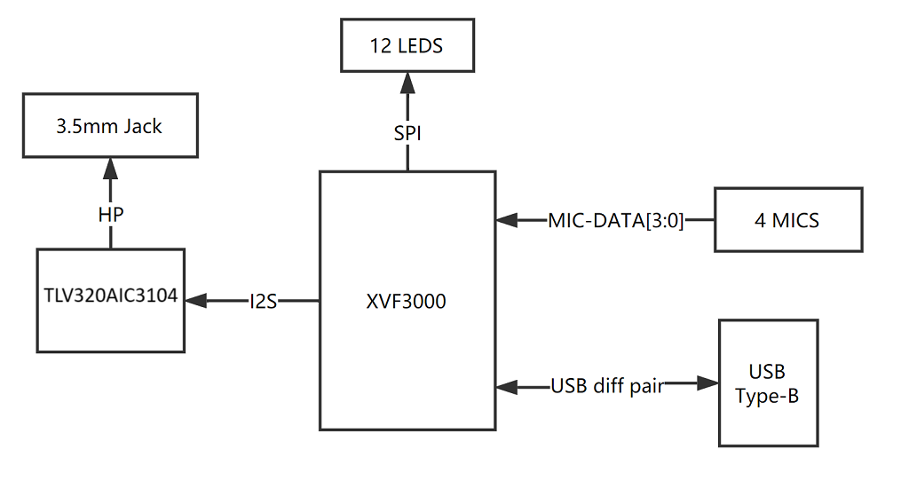

Hardware Overview
① XMOS XVF-3000: It integrates advanced DSP algorithms that include Acoustic Echo Cancellation (AEC), beamforming, dereverberation, noise suppression and gain control.
② Digital Microphone: The MP34DT01-M is an ultra-compact, lowpower, omnidirectional, digital MEMS microphone built with a capacitive sensing element and an IC interface.
③ RGB LED: Three-color RGB LED.
④ USB Port: Provide the power and control the mic array.
⑤ 3.5mm Headphone jack: Output audio, We can plug active speakers or Headphones into this port.
⑥ TLV320AIC3104: The TLV320AIC3104 is a low power stereo codec featuring Class D speaker drivers to provide 1 W per channel into 8 W loads.
System Diagram

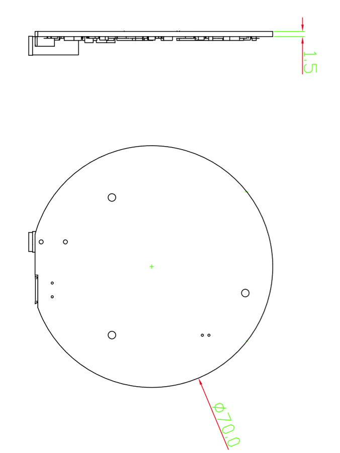

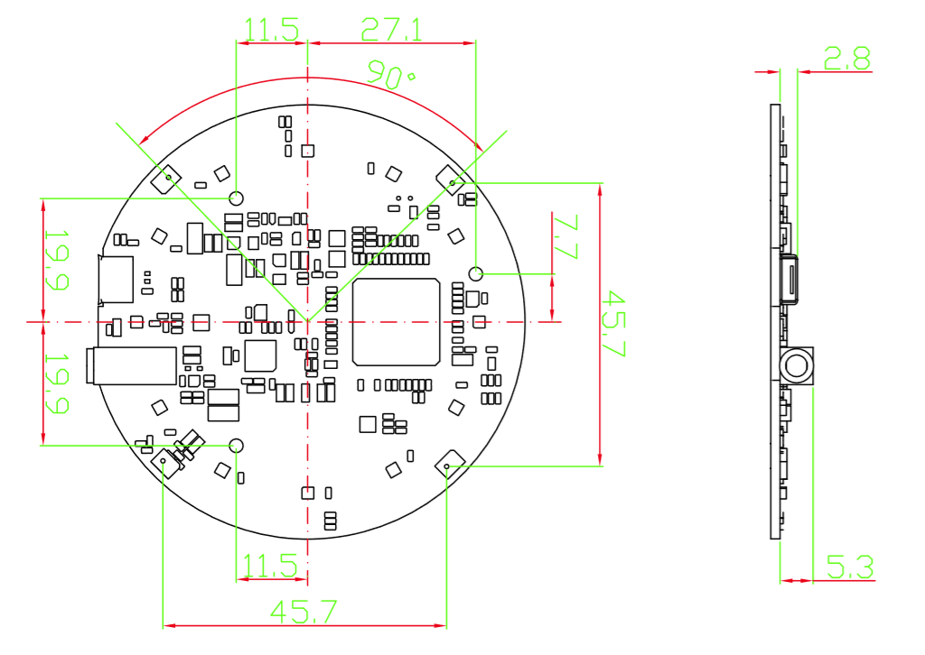

Dimensions
