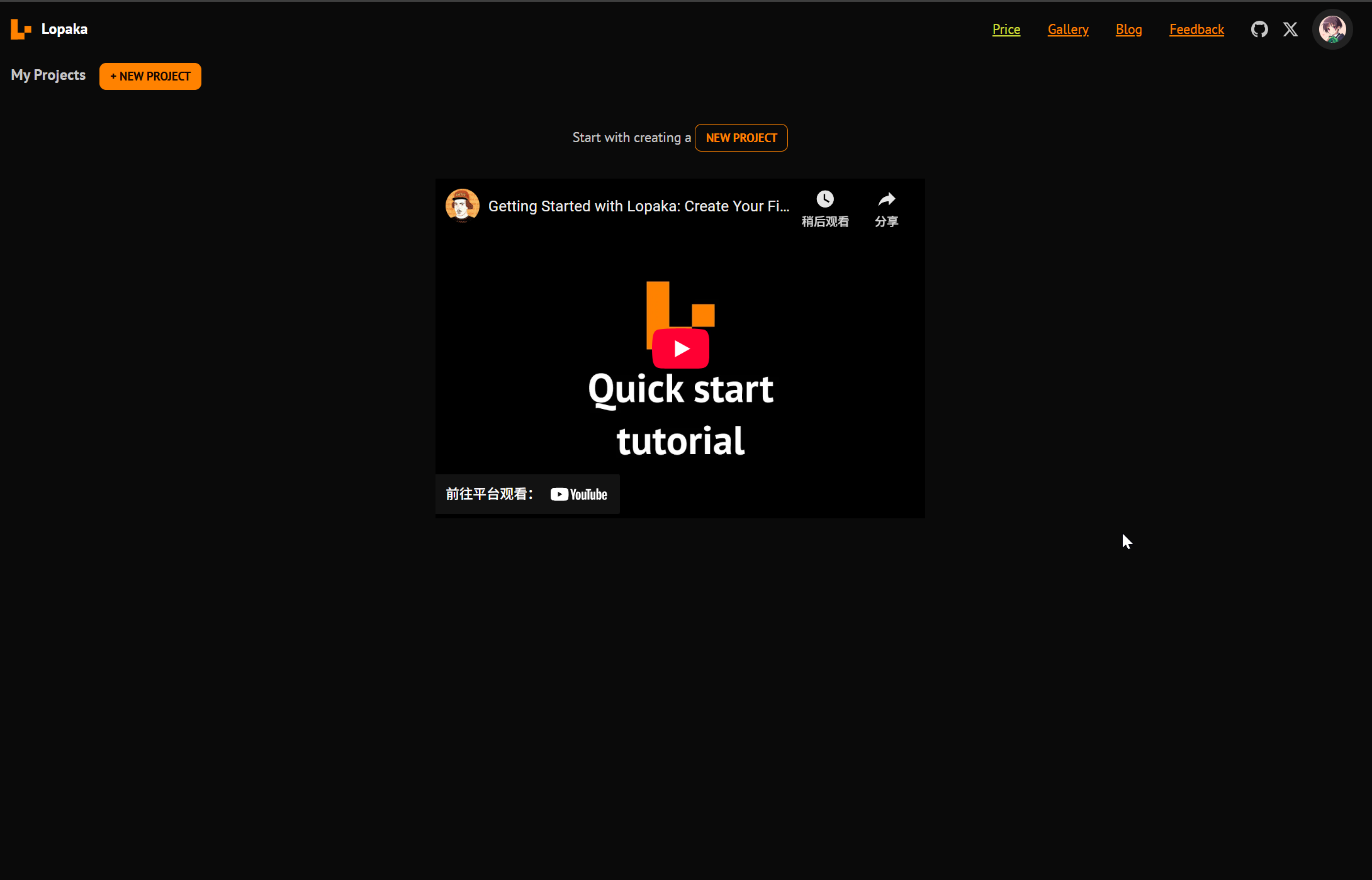

Lopaka registered and used
Lopaka is a graphic editor specifically designed for embedded graphics development. It enables users to customize the creation of their own UI interfaces, has built-in multiple font resources, and is very convenient to use when paired with Arduino or ESP32's OLED, TFT, or LCD displays. Lopaka can automatically generate C code that can be directly applied to sketches, significantly improving development efficiency.
Step 1. Registered
You can register using either Google or GitHub account.
Lopaka main interface

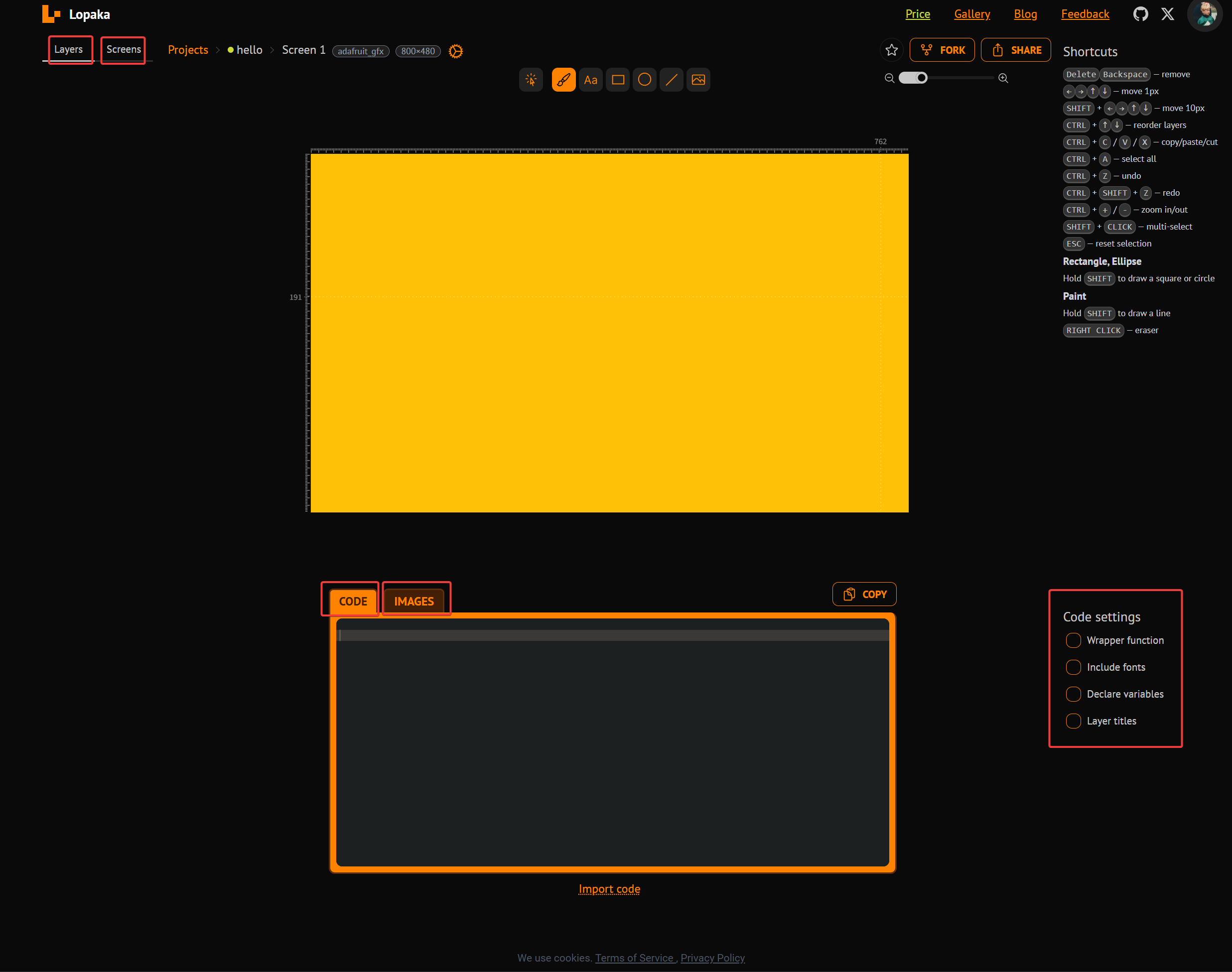

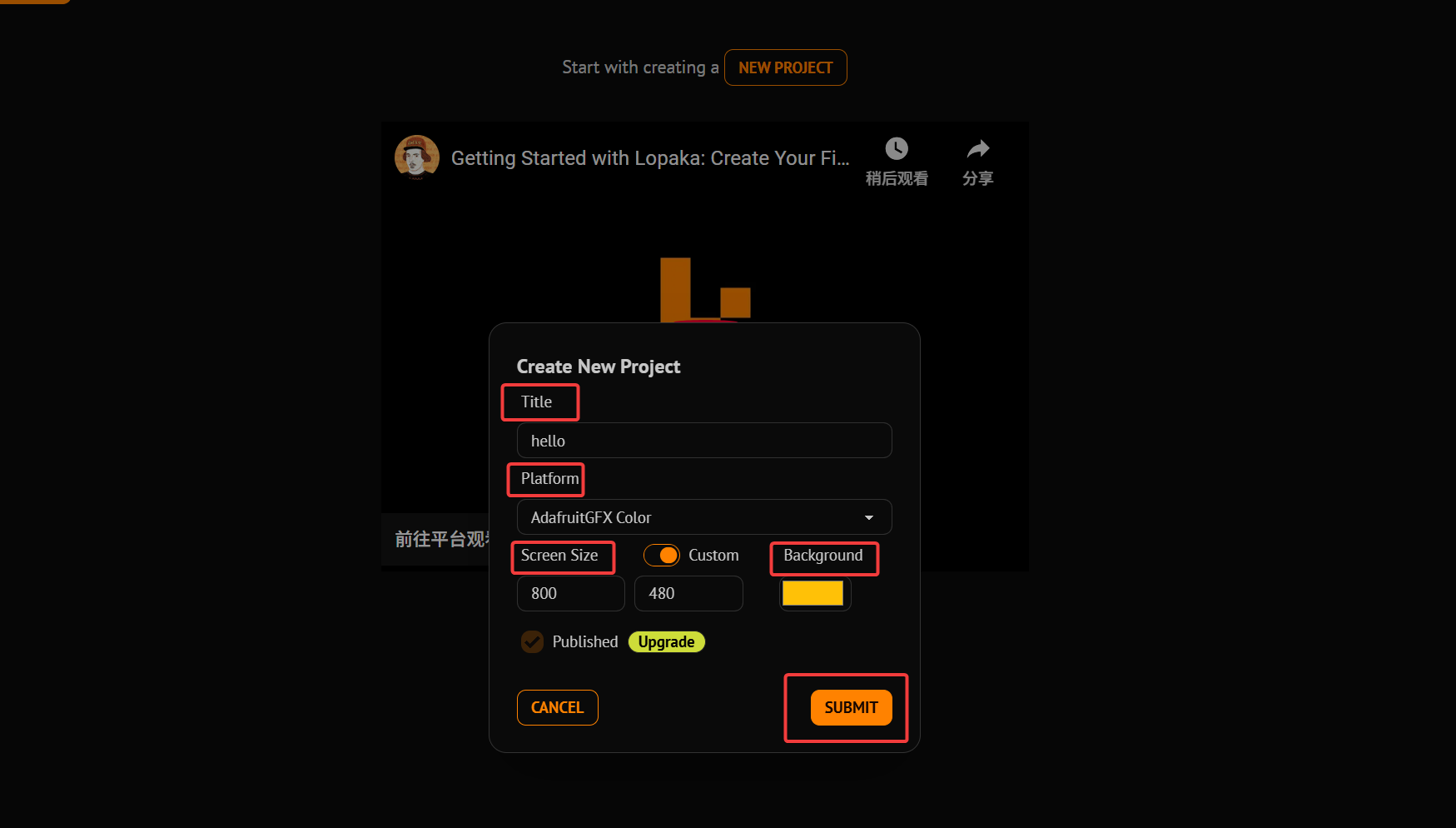

Step 2. New Project
Click on "NEW PROJECT" to create a new project. Then a window will pop up, and you will see the following screens. Fill in the project information.
- Titile: Project Name, i select hello
- Platform: The platform you chose for development, the reTeerminal E series, uses AdfruitGFX Color.
- Screen: The selection of screen size. Click "Custom" to customize the size. The screen size of the reTeerminal E series is 800×480.
- Background: The background color of the screen is black by default. To achieve better display, I have changed it to yellow. Then click "SUBMIT" to create the project.
Step 3. Introduction to Common Settings
- Layers:The name of the layer.Custom naming is supported.
- Screens:It can create multiple screens and support you in storing different ideas.
- CODE:The generated code is in C language.
- IMAGES:The official image type of Lopaka
- Code settings:Set the generated code. It is recommended that you check all the boxes.

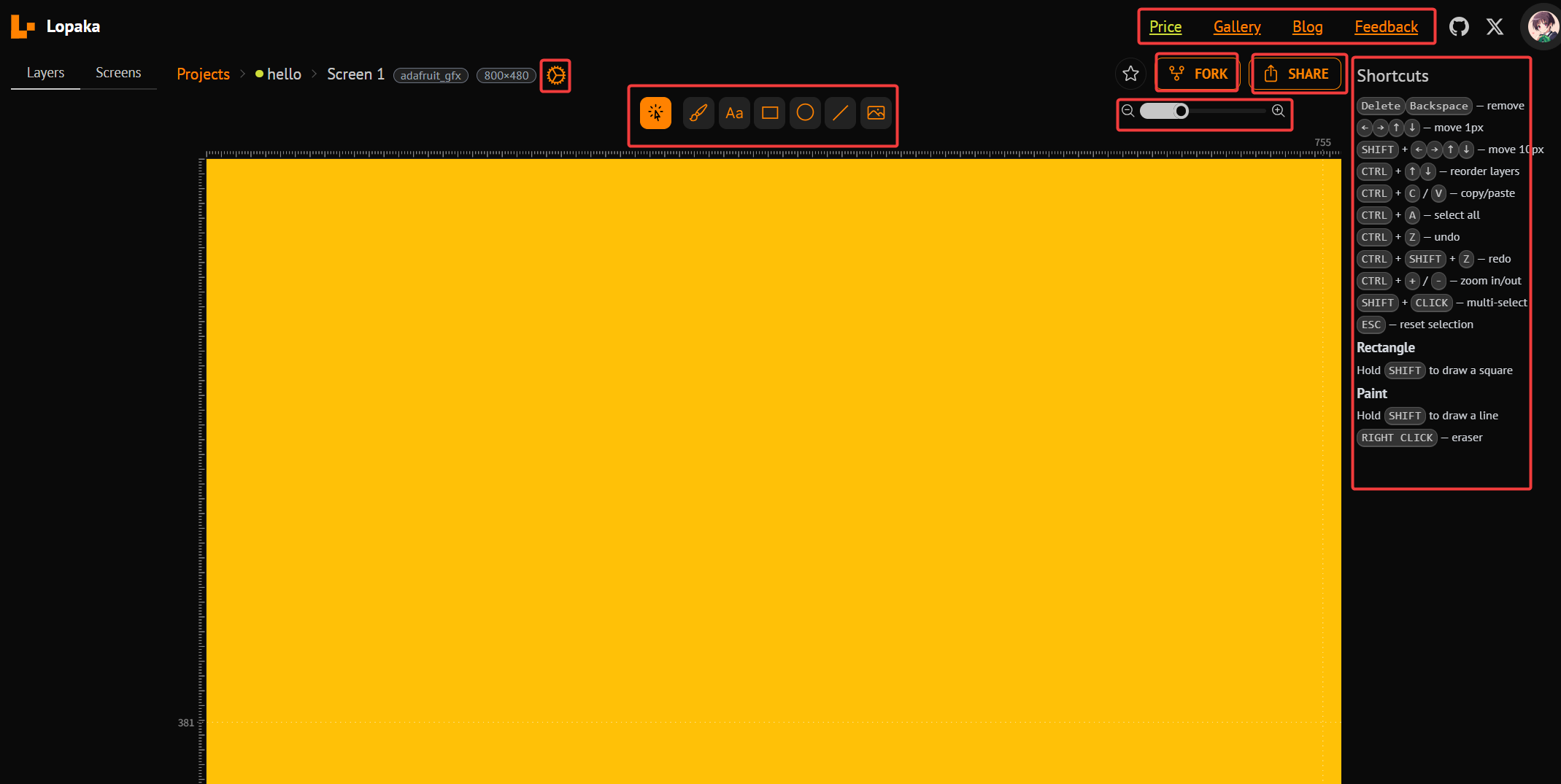

Other
From left to right
- "Gear": To manage the project, here you can redefine the project name, adjust the size of your screen and the background color, but modifying the Platform is not supported unless you delete or recreate the project.
- Toolbar: The functions of this row of toolbars are Select, Paint, String, rectangle, Circle, Line, and image.
- Slider: Here, you can adjust the size of the canvas, which enables you to perform detailed operations.
- Frok and SHARE: You can frok others' projects share your own projects.
- Price Gally Blog Feedback: Price enables you to subscribe to different levels of Lopaka to access additional features. Gally is an open-source engineering marketplace. Blog is the update log of Lopaka. Feedback provides feedback.
- Shortcuts: These are some shortcut key tips.

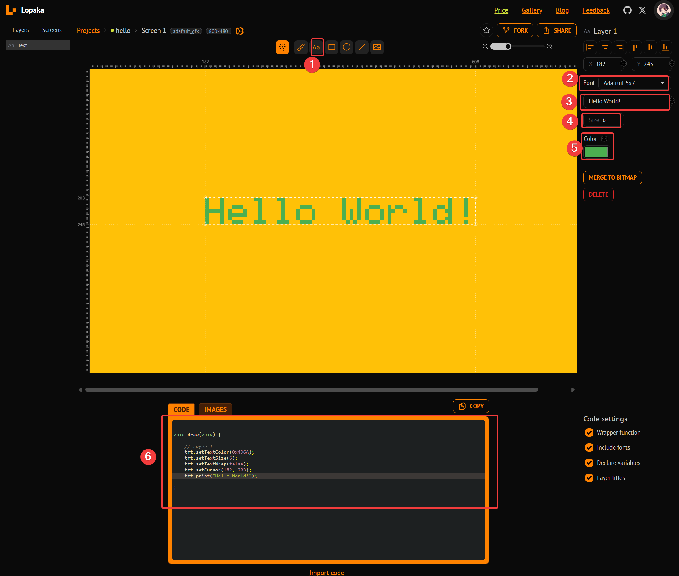

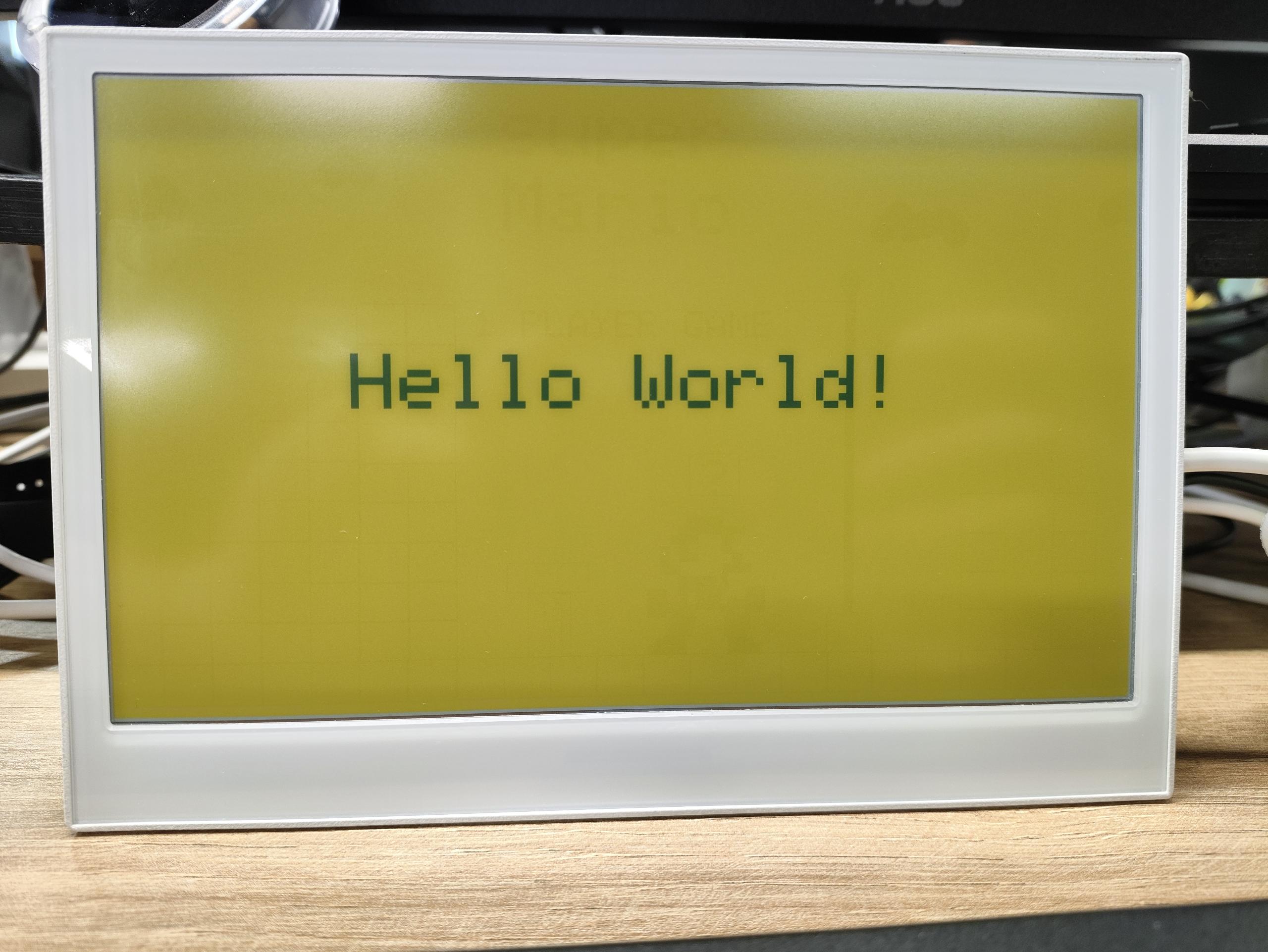

Hello World
- Select "String", then click on the canvas.
- In the right column, select "Font" and choose your font, such as Adafruit 5×7.
- Enter the content "Hello World!", select "Size" as 6, and choose the color you like. Here, I choose green.
- Then, move it to the center position of the screen. After that, the required project code will be generated within "CODE".

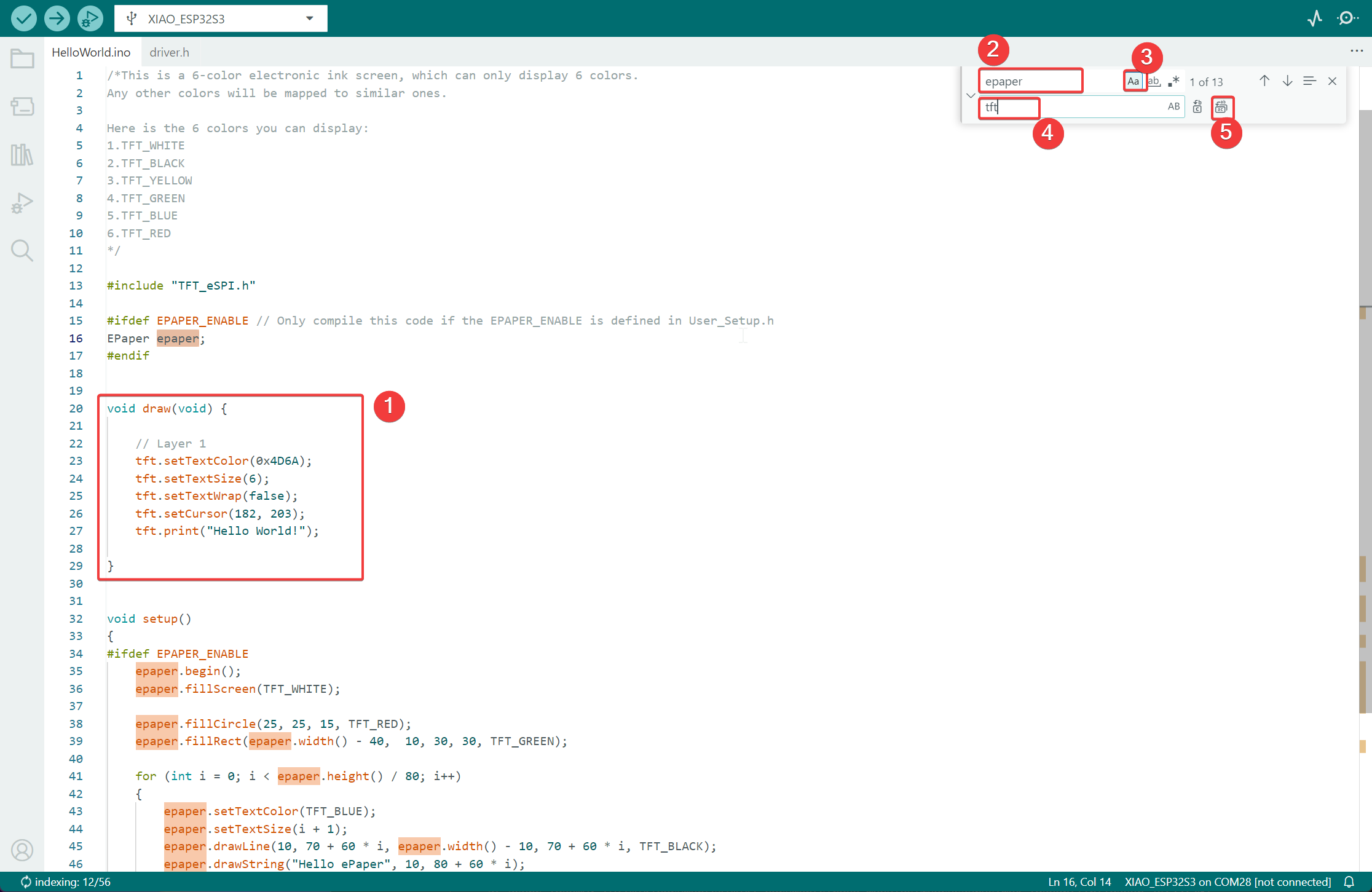

Step 5. procedure of amendment
- Copy the CODE code of the Lopaka page to the Arduino environment.
- Replace the lowercase "epaper" with "tft", open the global search using Ctrl + F, enter "epaper", then click
Aato switch to case-insensitive search, followed by entering "tft", and click "Global Replace"

Step 6. upload
The effect is shown in the following figure.

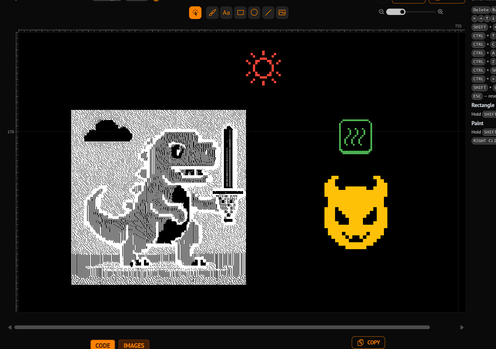

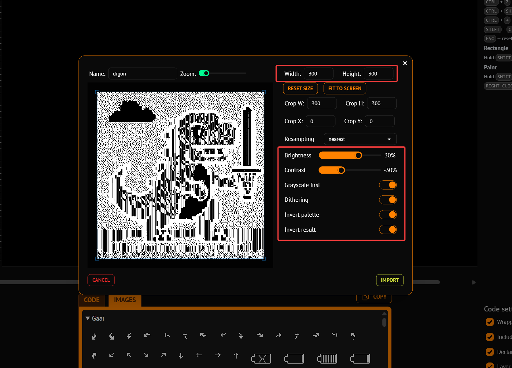

- Select "image" on the toolbar.
Adjustment parameter
Adjust the appropriate size. I set it to 300×300, then adjusted the Brightness and other parameters to make the image clearer, and then imported it.
- Adjust the position and distance to the appropriate ones, and then add some details.

If you are using the free version of Lopaka, the imported images only support color modification for the entire image, and do not support modification of a specific detail of the image.

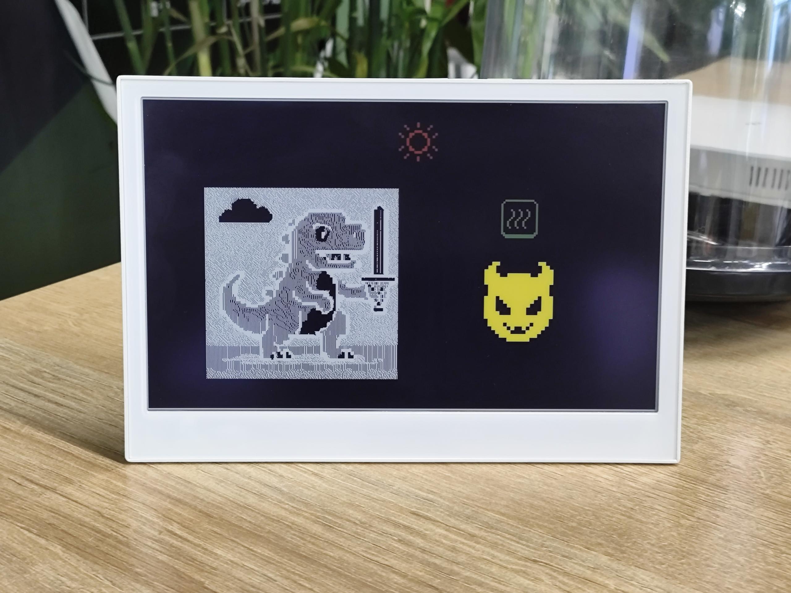

Effect presentation
Upload the program and then wait for the ink screen to refresh.

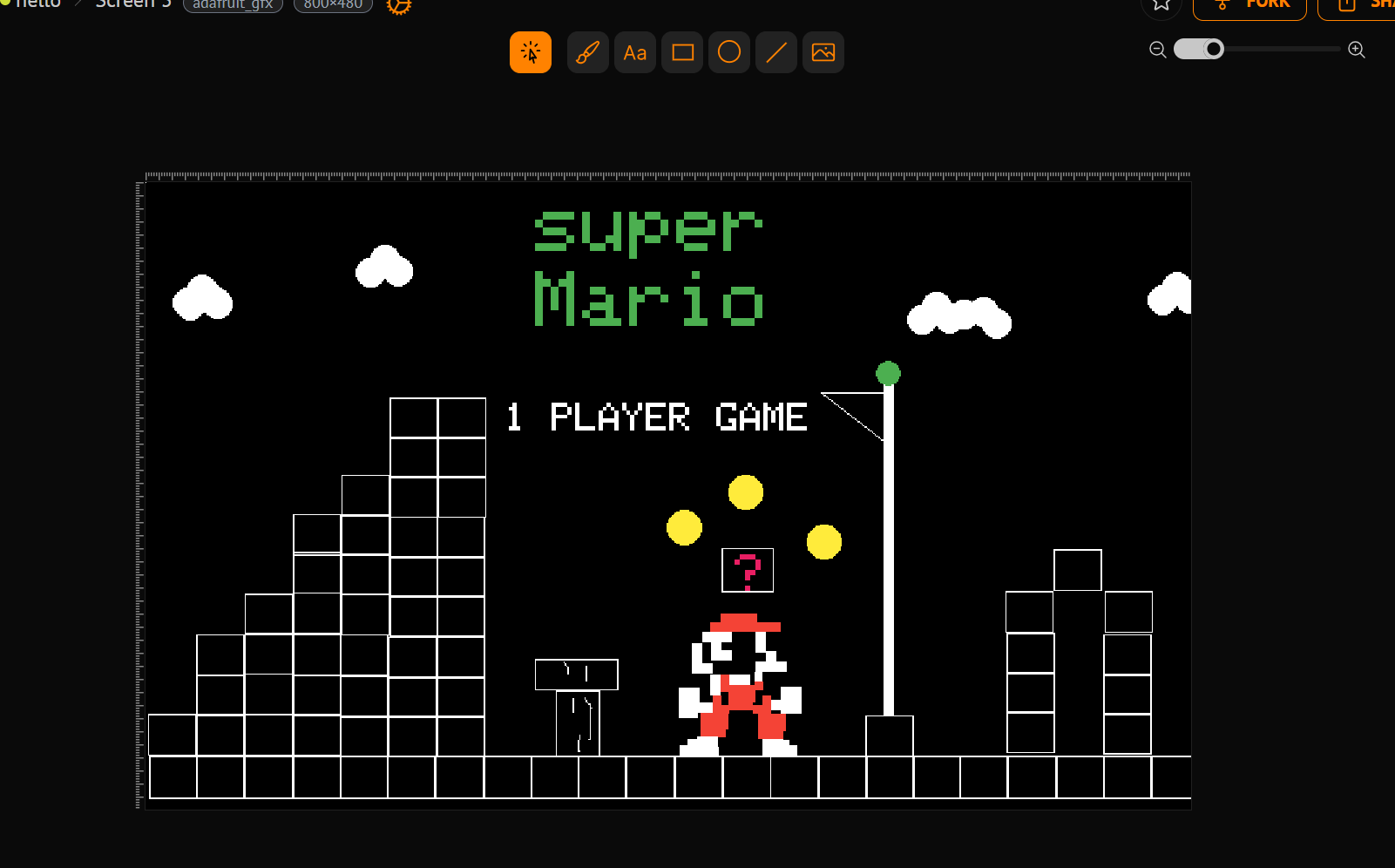

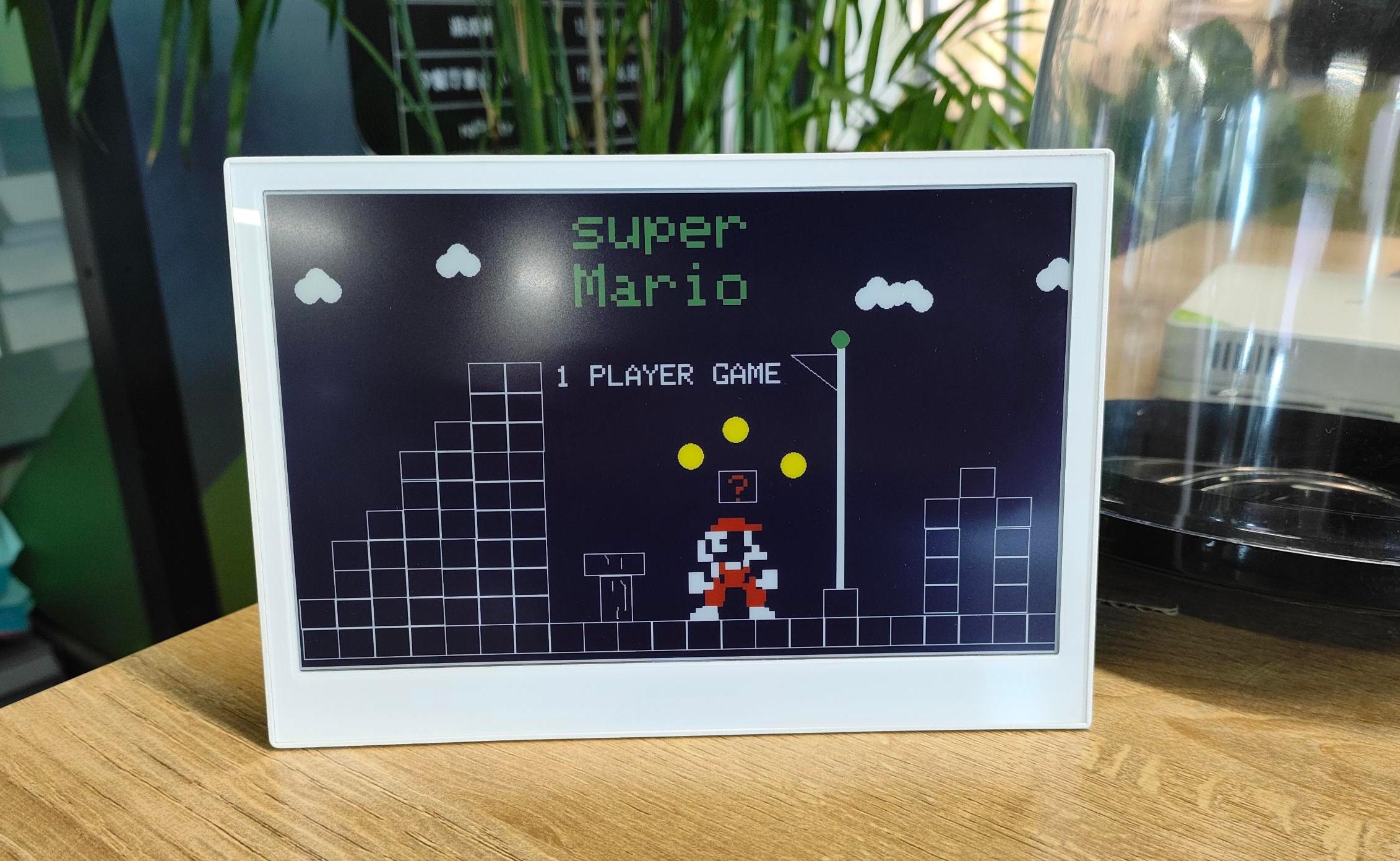

Hand-drawn example
Here, a picture of Super Mario was drawn by hand. You can also create your own drawing based on your own ideas
Hardware
To complete this tutorial, please prepare reTerminal E1002 devices:
| reTerminal E1002 |
Software
- Choose the appropriate tools for drawing, such as rectangles, strings, circles and Paint.
- The drawing effect is as follows
- Upload program

- The final result is as follows
