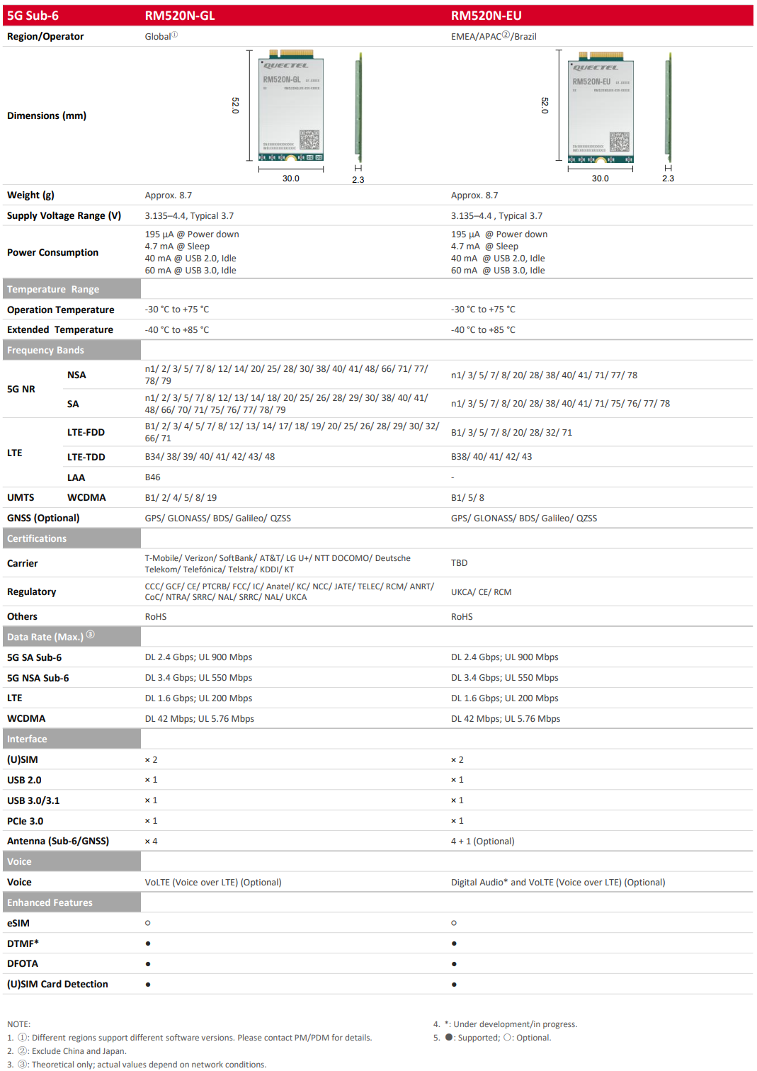

The RM520N is a series of 5G IoT modules specially optimized for IoT/eMBB applications, designed in an M.2 form factor in accordance with the 3GPP Release 16 specification, which supports both 5G NSA and SA modes. The RM520N is compatible with Quectel’s 5G module series RM50xQ, LTE-A Cat 6 module EM06, Cat 12 module series EM12/EM12xR/EM120K, and Cat 16 module EM160R-GL, facilitating migration from LTE-A to 5G.
The RM520N is an industrial-grade module for industrial and commercial applications only. It covers nearly all the mainstream carriers worldwide and supports Qualcomm® IZat location technology Gen9C Lite (GPS, GLONASS, BDS and Galileo). The integrated GNSS receiver greatly simplifies the product design and provides quicker, more accurate and dependable positioning capability.
Thanks to a rich set of Internet protocols, industry-standard interfaces and abundant functionalities (USB and PCIe drivers for Windows 10, Linux, and Android) the module can be adopted in a wide range of eMBB and IoT applications including industrial routers, home gateways, STB, industrial laptops, consumer laptops, industrial PDAs, rugged tablet PCs, video transmission, and digital signage.
Features
- 5G/4G/3G multi-mode module in M.2 form factor, optimized for IoT and eMBB applications
- Worldwide 5G and LTE-A coverage
- Supports NSA and SA modes
- Multi-constellation GNSS receiver available for applications requiring fast and accurate positioning in any environment
- Feature refinements: DFOTA and VoLTE (optional)

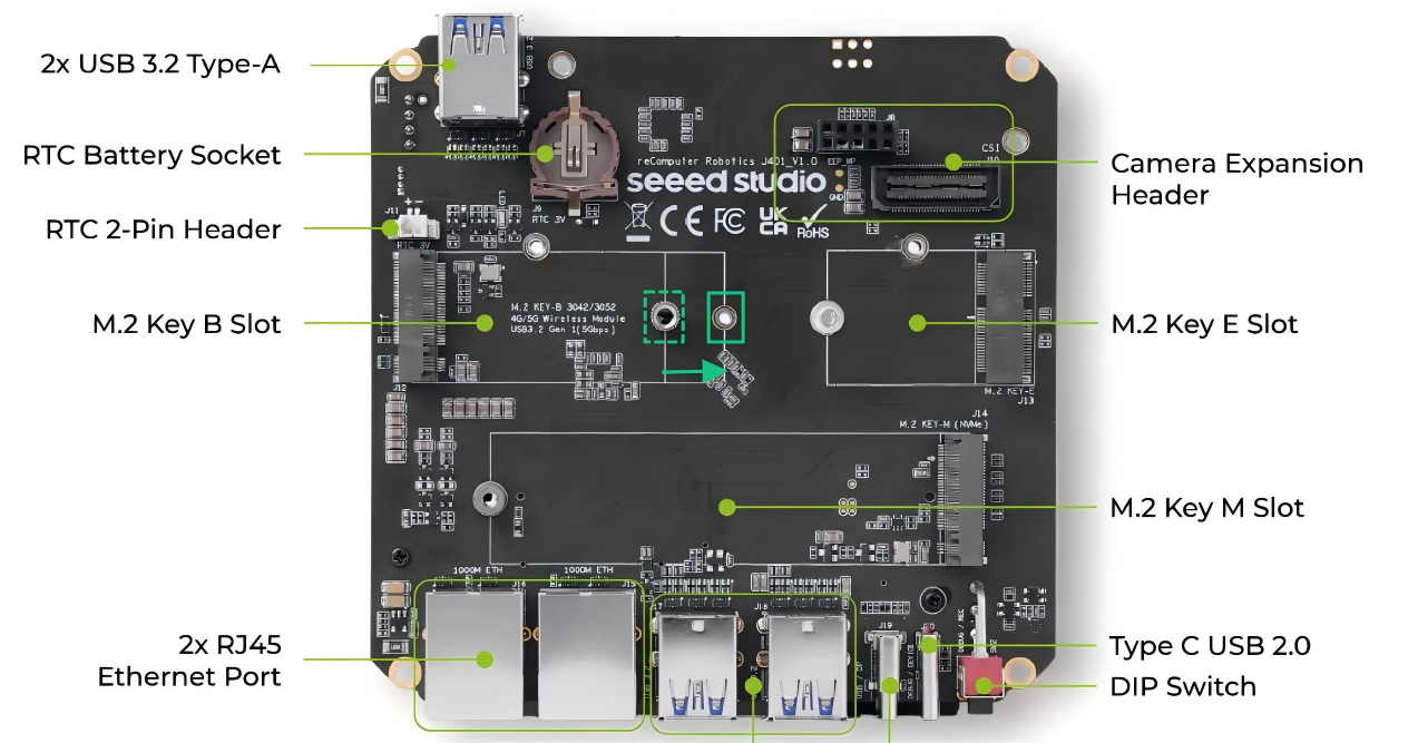

Step 3. Insert the 5G module into the M.2 Key B port.
Step 4. Tighten the fixing screws and install the antenna.

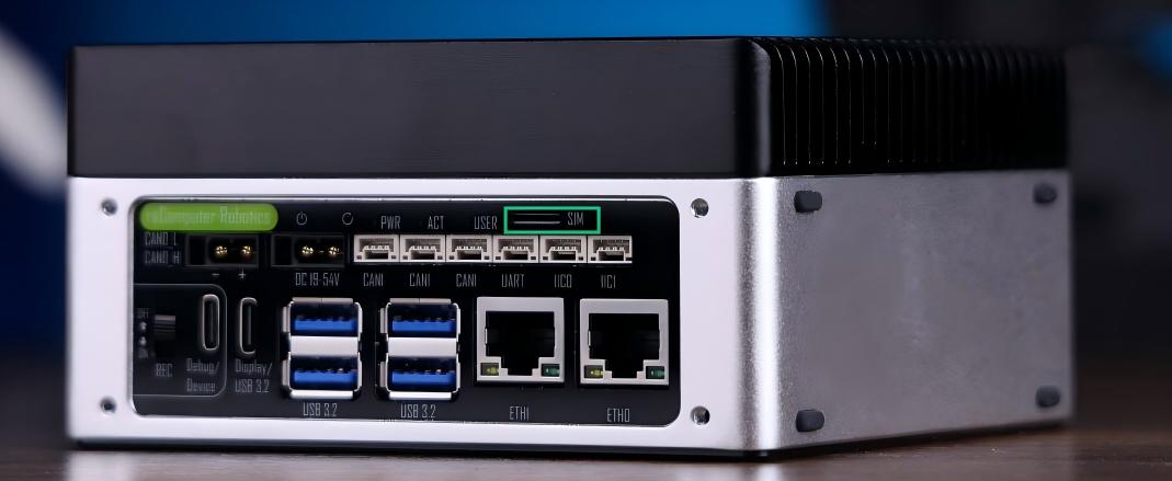

Step 5. Install the 5G SIM card in the front panel.

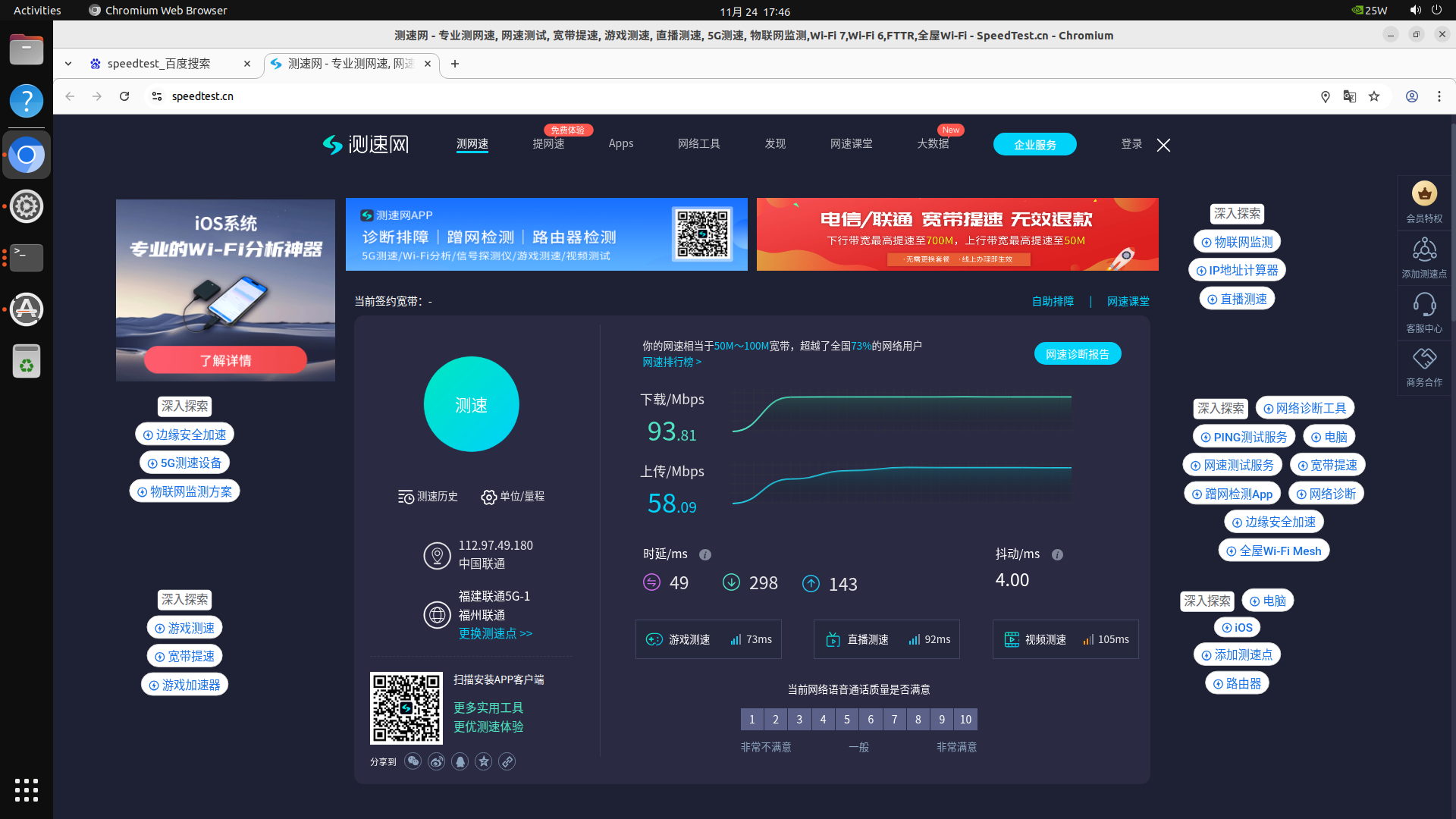

To verify the network quality, you can use a speed test tool to test the network speed.

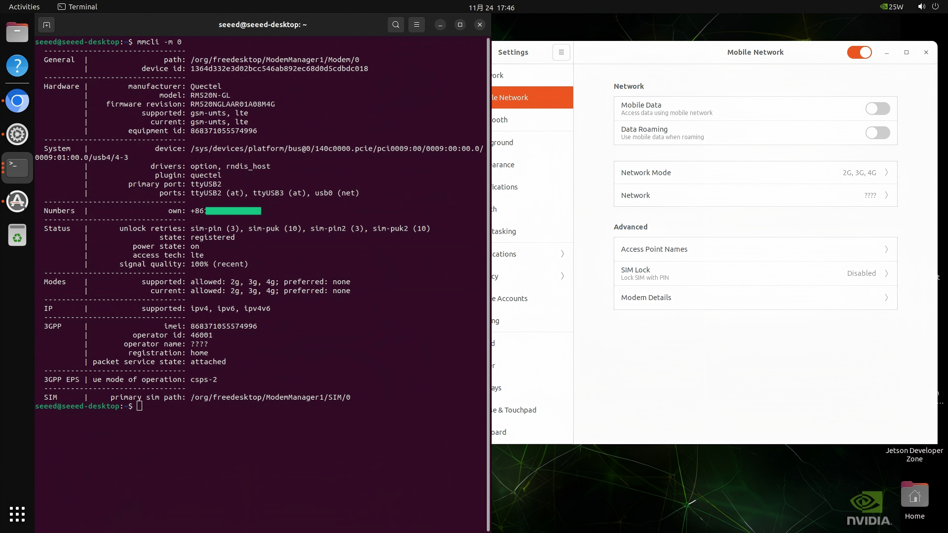

Known issue: We have found that this configuration method allows the 5G module to connect to the network normally, but the mmcli information displays anomalies.
