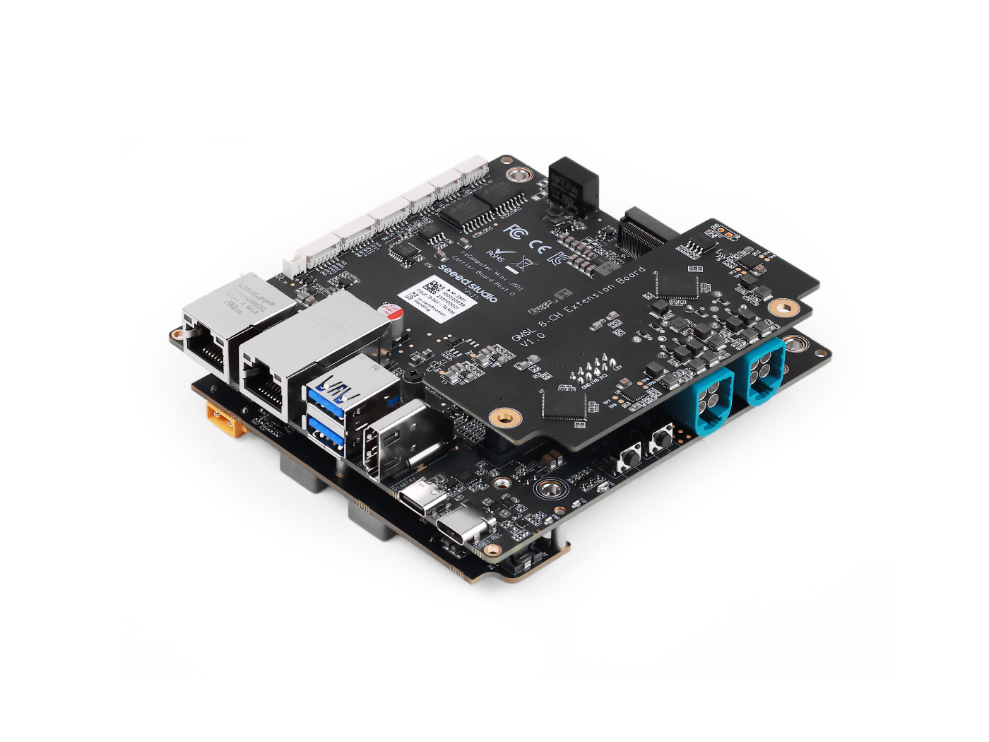

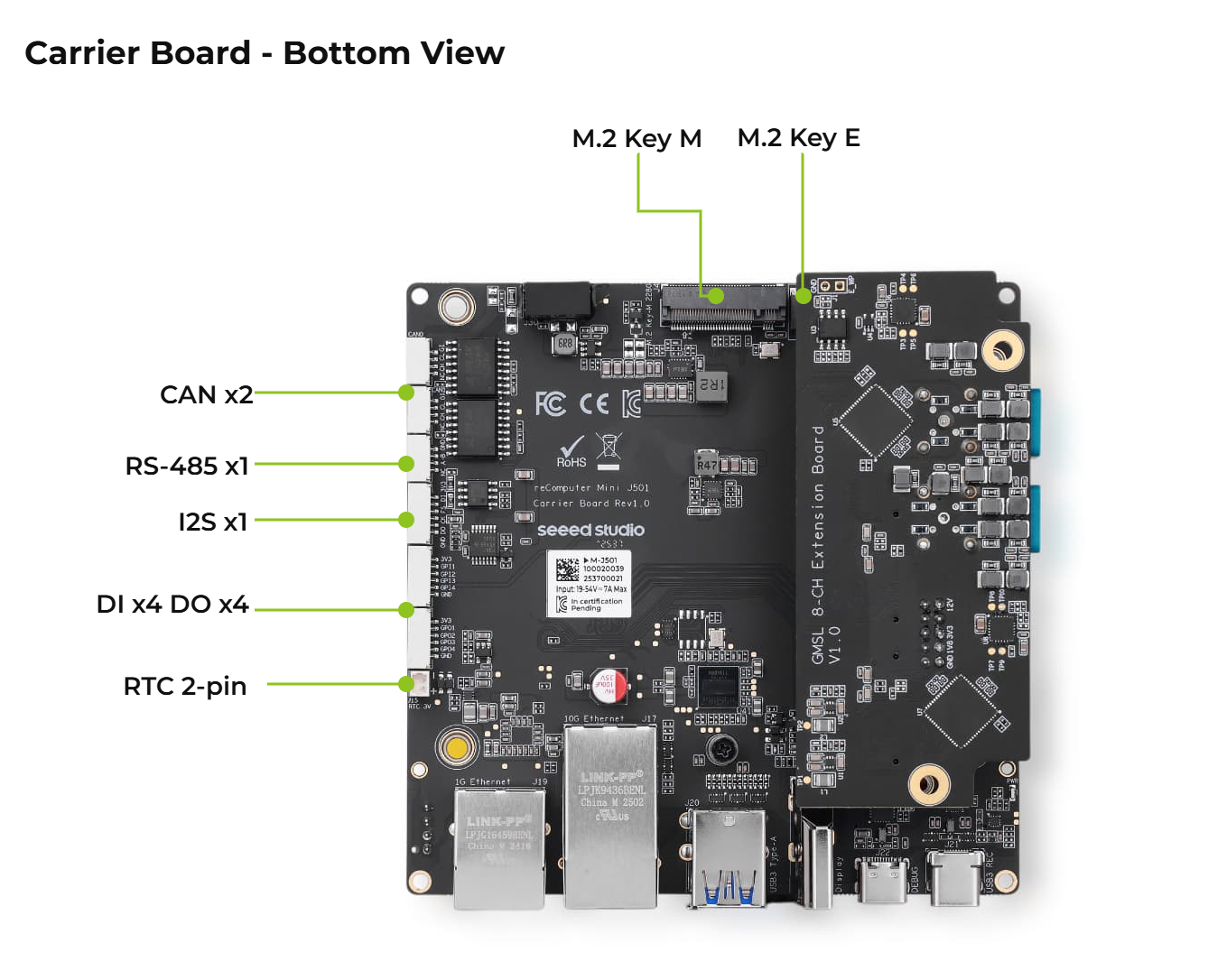

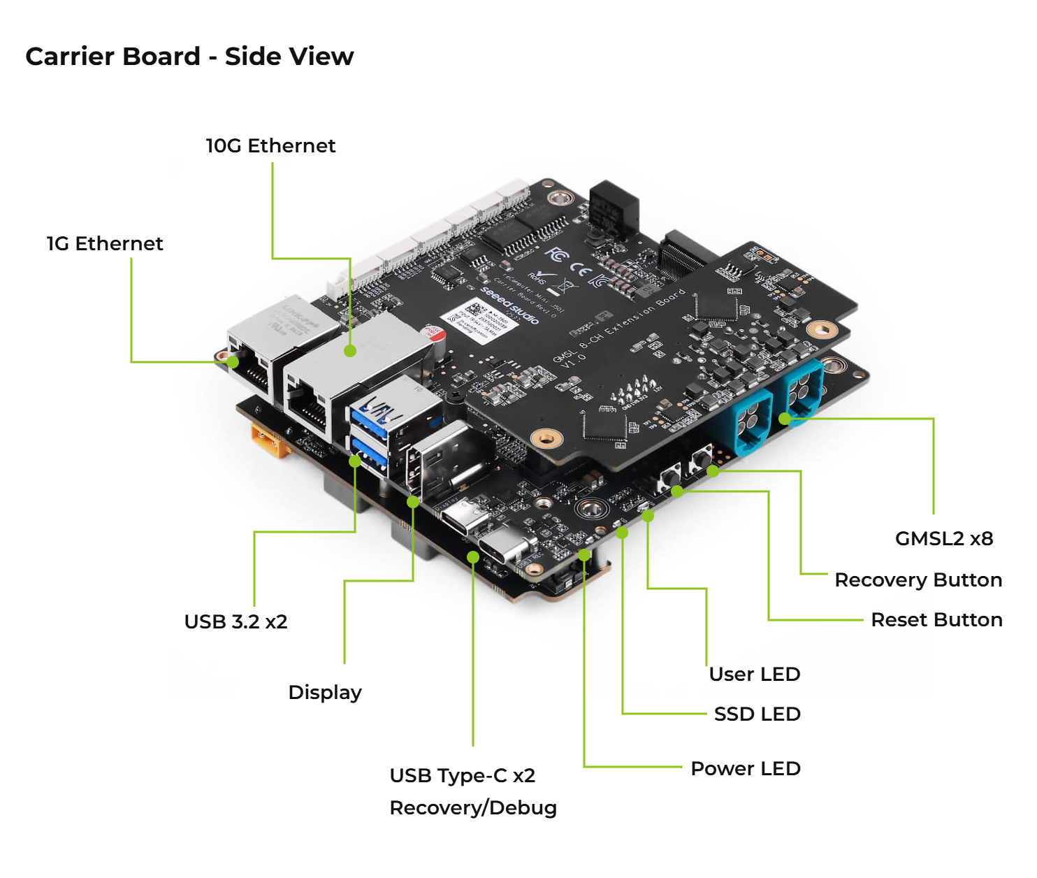

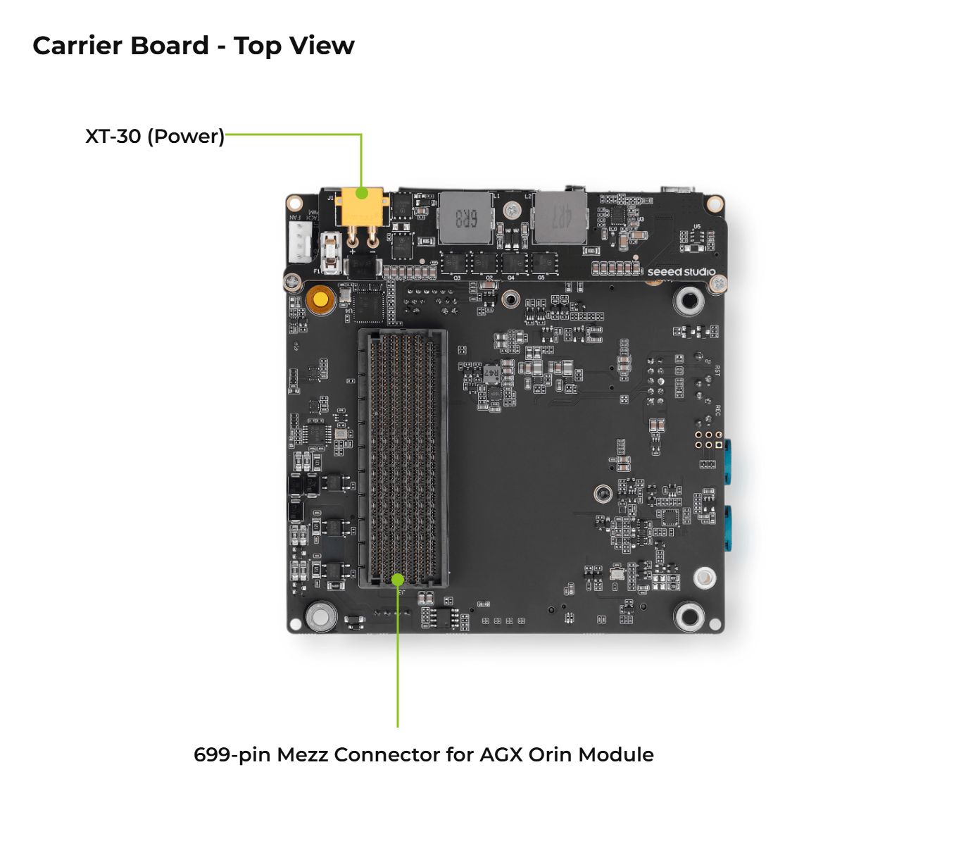

reComputer Jetson Robotics J501-Mini Carrier Board overview
| Top View |
| side View |
| bottom View |

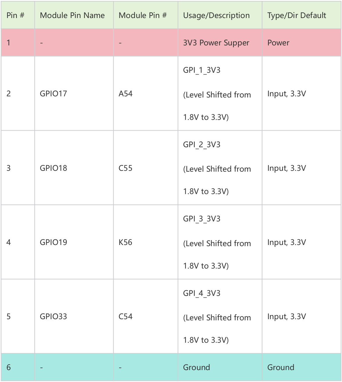

| CAN | 2x CAN JST 4-Pin Connector(GH 1.25); | |

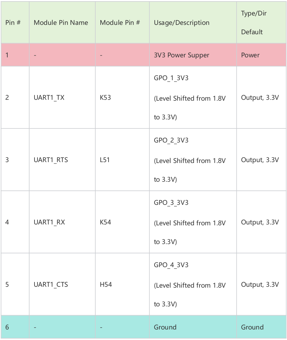

| DI/DO | 1x DI JST 5-Pin Connector(GH 1.25); 1x DO JST 5-Pin Connector(GH 1.25); | |
| I2S | 1x I2S JST 5-Pin Connector(GH 1.25) | |

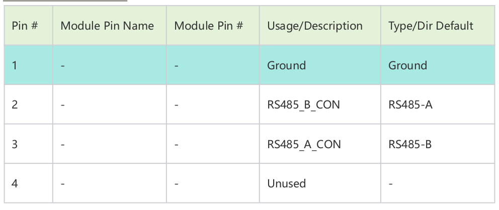

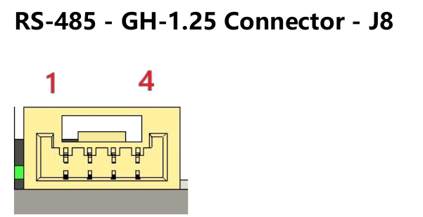

| RS485 | 1x RS-485 JST 4-Pin Connector(GH 1.25) | |

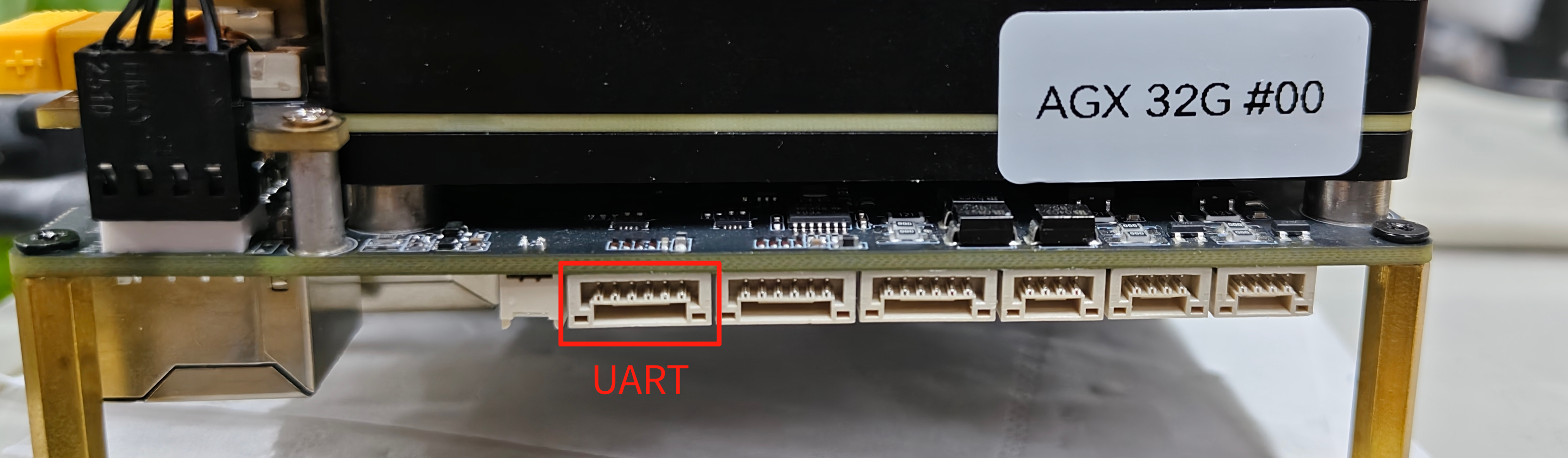

| UART | 1x UART JST 4-Pin Connector (Multiplexed with DI) | |

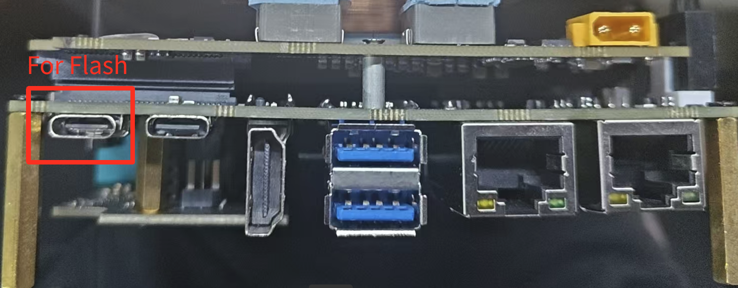

Enter Force Recovery Mode
Before we can move on to the installation steps, we need to make sure that the board is in force recovery mode.
Step-by-Step

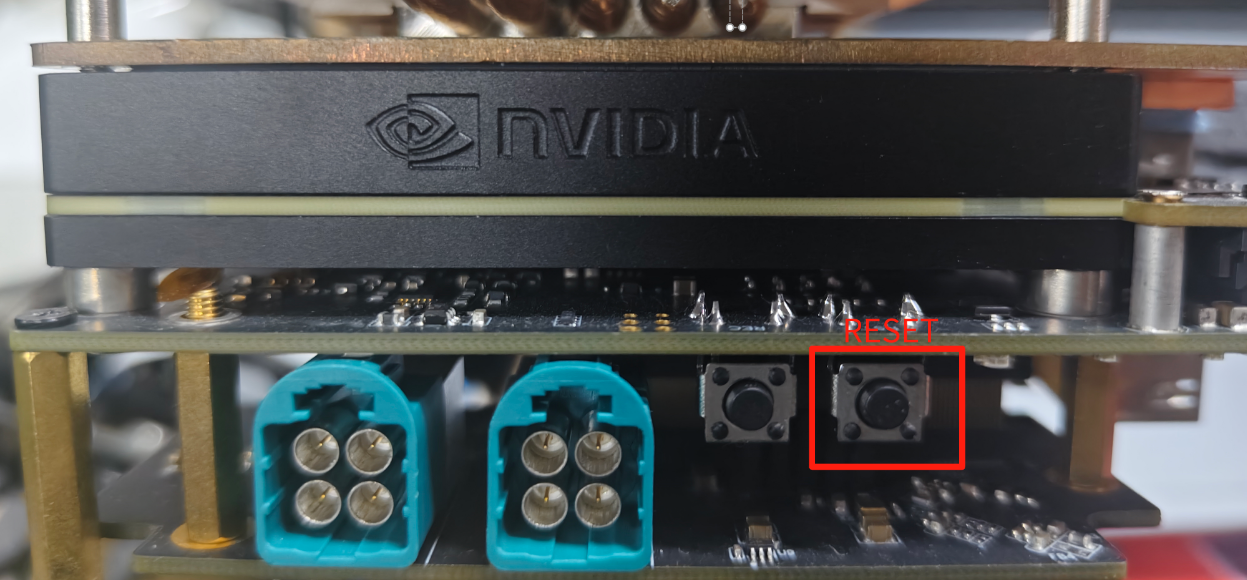

Step 1. Keep pressing button to the RESET mode.
Step 2. Power up the carrier board by connecting the power cable, then release REST button .
Step 3. Connect the board to the Ubuntu host PC with a USB Type-C data transmission cable.
Step 4. On the Linux host PC, open a Terminal window and enter the command lsusb. If the returned content has one of the following outputs according to the Jetson SoM you use, then the board is in force recovery mode.
- For AGX Orin 32GB: 0955:7223 NVidia Corp
- For AGX Orin 64GB: 0955:7023 NVidia Corp
The below image is for AGX Orin 32GB:

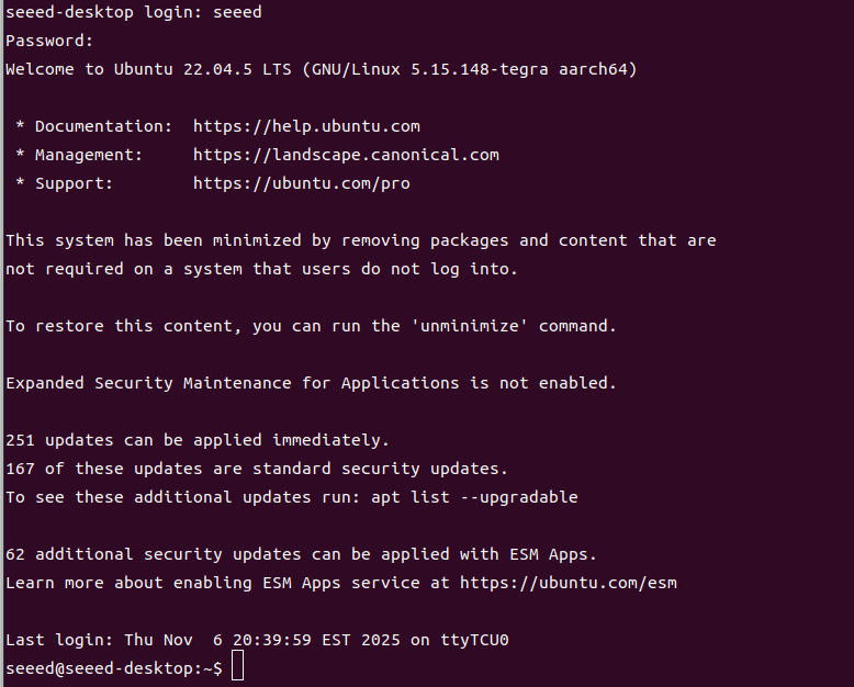

Step 3: Connect the Robotics J501-Mini to a display use the PD to HDMI adapter to connect to a display that supports HDMI input, or directly connect to a display that supports PD input using the PD cable, and finish the initial configuration setup:
Please complete the System Configuration according to your needs.

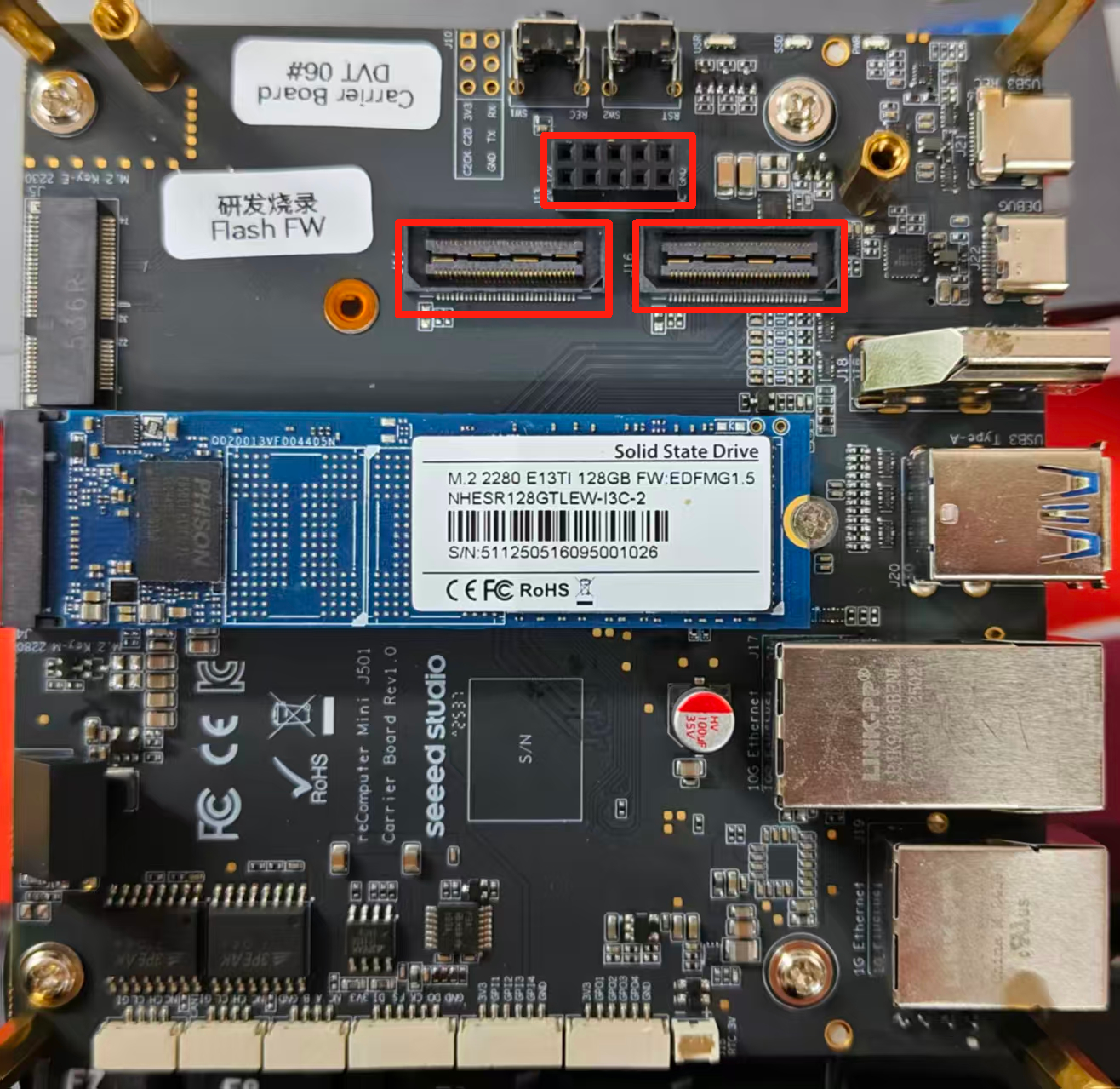

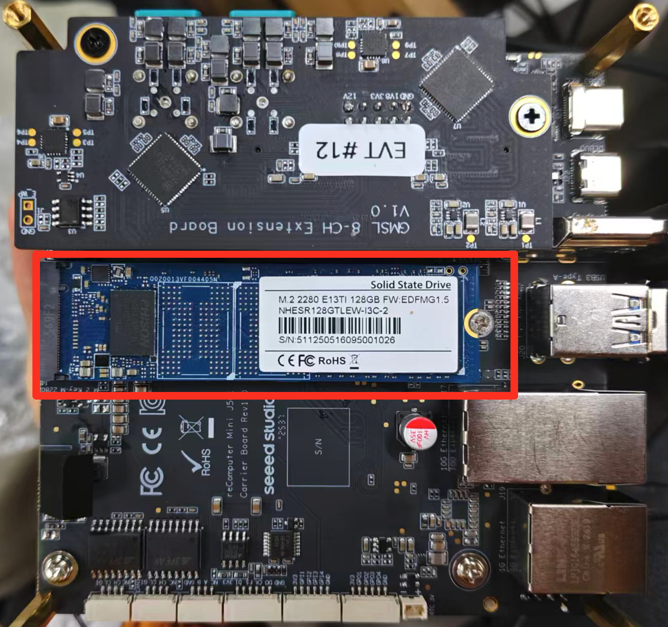

M.2 Key M
M.2 Key M is designed for high-speed NVMe SSDs, providing ultra-fast data transfer for robotics applications.
Supported SSD are as follows
- 128GB NVMe M.2 PCle Gen3x4 2280 Internal SSD
- 256GB NVMe M.2 PCle Gen3x4 2280 Internal SSD
- 512GB NVMe M.2 PCle Gen3x4 2280 Internal SSD
- 1TB NVMe M.2 PCle Gen3x4 2280 Internal SSD
- 2TB NVMe M.2 PCle Gen3x4 2280 Internal SSD
Hardware Connection
Usage Instruction

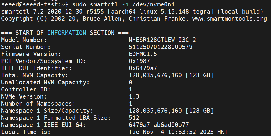

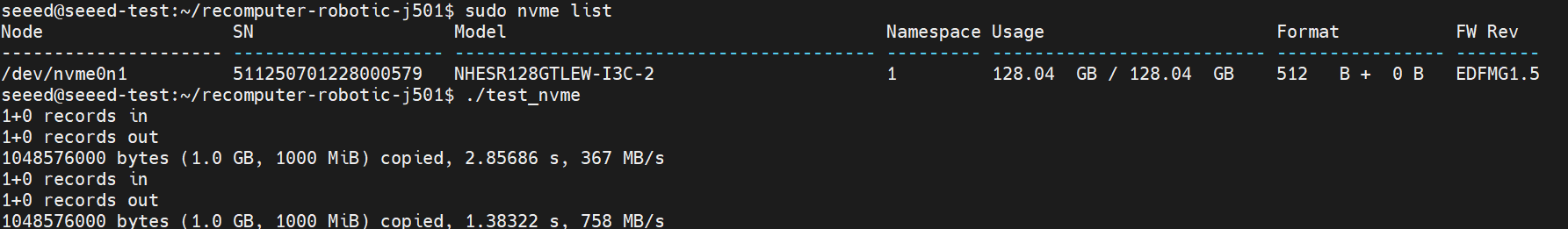

Before testing the SSD read/write speed, you need to enter the following in the Jetson terminal:
sudo apt update
sudo apt install smartmontools
sudo smartctl -i /dev/nvme0n1
Create a script file to test SSD read/write speed:
#You need to create a blank test file first
cat <<'EOF' | sudo tee test_nvme.sh >/dev/null
#!/usr/bin/env bash
set -e
sudo dd if=/dev/zero of=test bs=1000M count=1 conv=fdatasync
sleep 1
sudo sh -c "sync && echo 3 > /proc/sys/vm/drop_caches"
sleep 1
sudo dd if=test of=/dev/null bs=1000M count=1
sudo rm -rf test
EOF
Run the script to test SSD read/write speed:
sudo chmod +x test_nvme.sh
./test_nvme

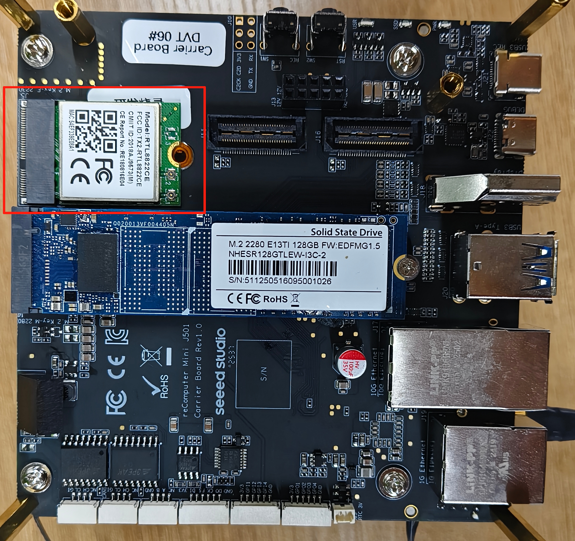

M.2 Key E
The M.2 Key E interface is a standard M.2 connector primarily used for connecting wireless modules, such as Wi-Fi and Bluetooth, to expand wireless communication capabilities.
Hardware Connection
Usage Instruction
To test Wi-Fi performance, use the following command (replace the IP address with your test server):
iperf3 -c 192.168.6.191
Bluetooth functionality is available via the M.2 Key E slot.

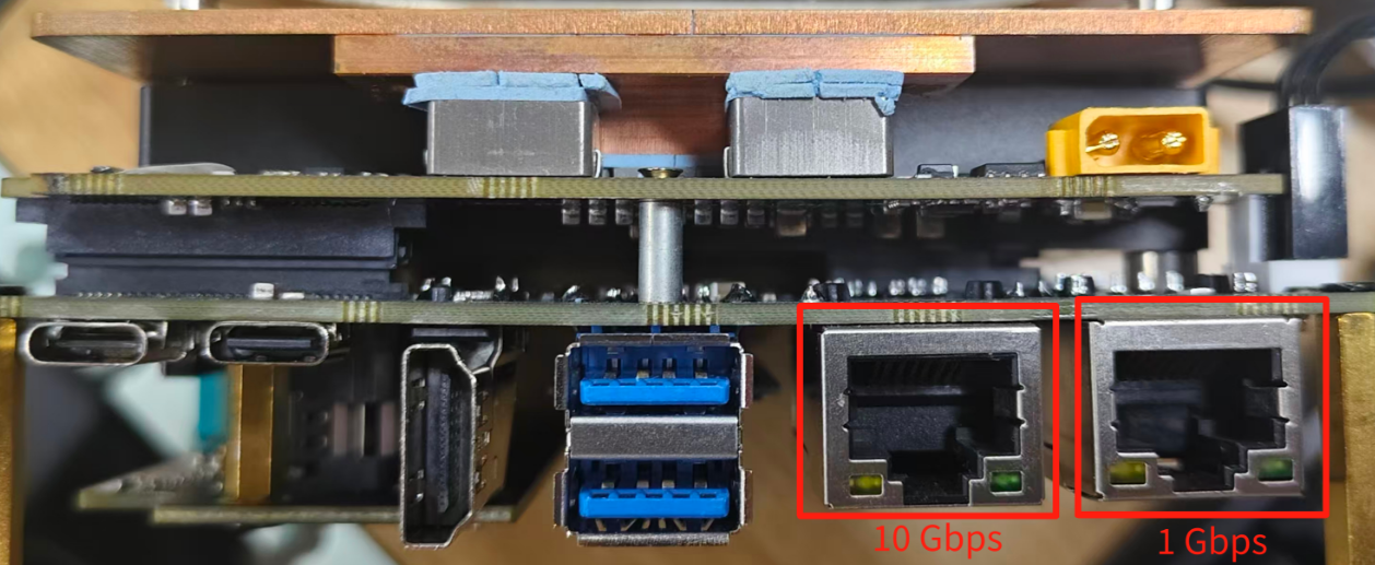

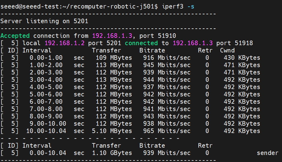

The Robotics j501-Mini carrier board features 2 1Gbps RJ45 Ethernet ports for high-speed wired network connectivity.
To test Ethernet port speed, use iperf3 as follows :
iperf3 -c <server_ip> -B <bind_ip>
<server_ip> is the IP address of the iperf3 server. The client will connect to this server to perform a bandwidth test.
<bind_ip> binds the specified local IP address as the source of the test traffic.

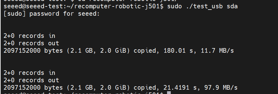

USB-A Speed Test
Create a script to test USB device speed:
sudo vim test_usb
Paste the following content:
cat <<'EOF' | sudo tee test_usb.sh >/dev/null
#!/bin/bash
sudo dd if=/dev/zero of=/dev/$1 bs=1000M count=2 conv=fdatasync
sleep 1
sleep 1
sudo dd if=/dev/$1 of=/dev/null bs=1000M count=2
EOF
Make the script executable and test:
sudo chmod +x test_usb
./test_usb

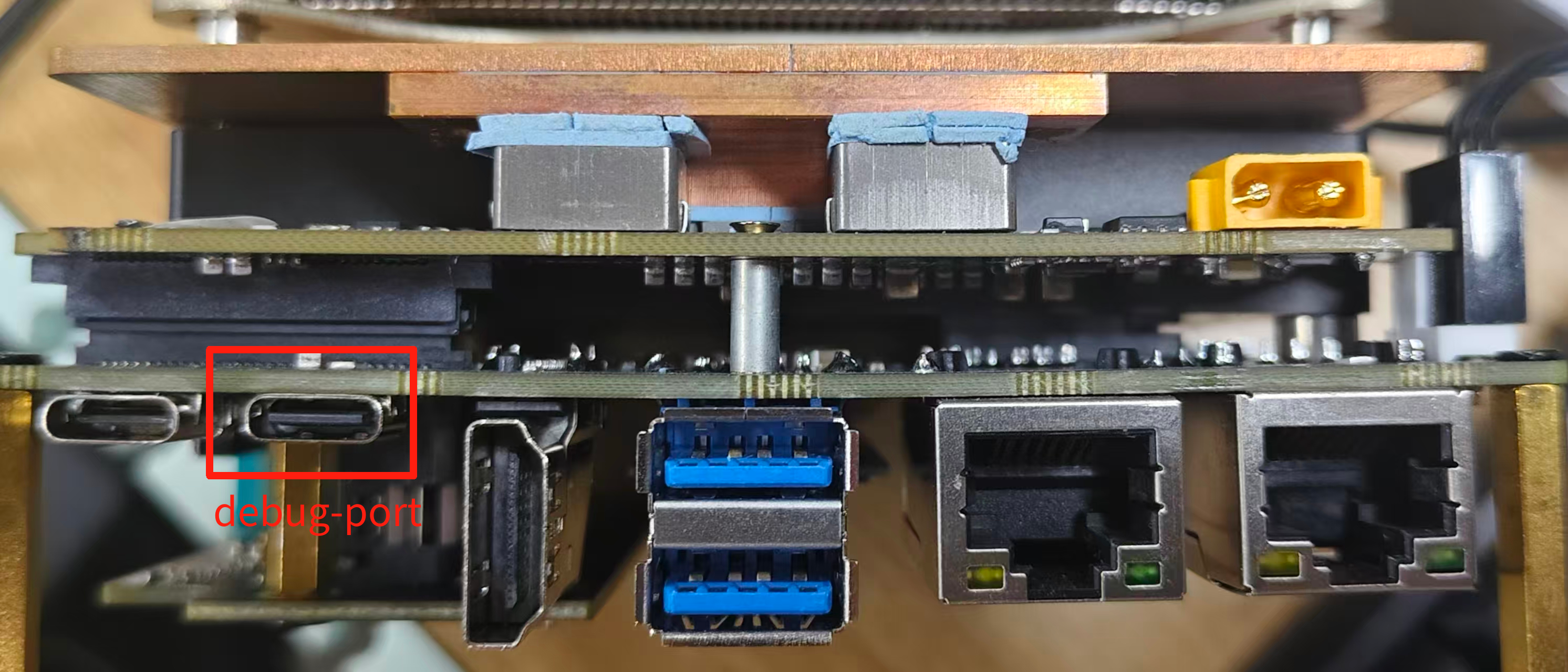

USB 2.0 Type-C port
Using this serial port, via the USB-C data cable, you can monitor the debugging information of input and output on the PC side.
On your PC (not the Jetson), install a serial port login tool and log in to /dev/ttyUSB0 (it might also be ttyUSB1, 2):
sudo apt update
sudo apt install screen
screen /dev/ttyUSB0 115200
You can then control the Jetson's terminal via the serial port on another Linux host, as shown below:

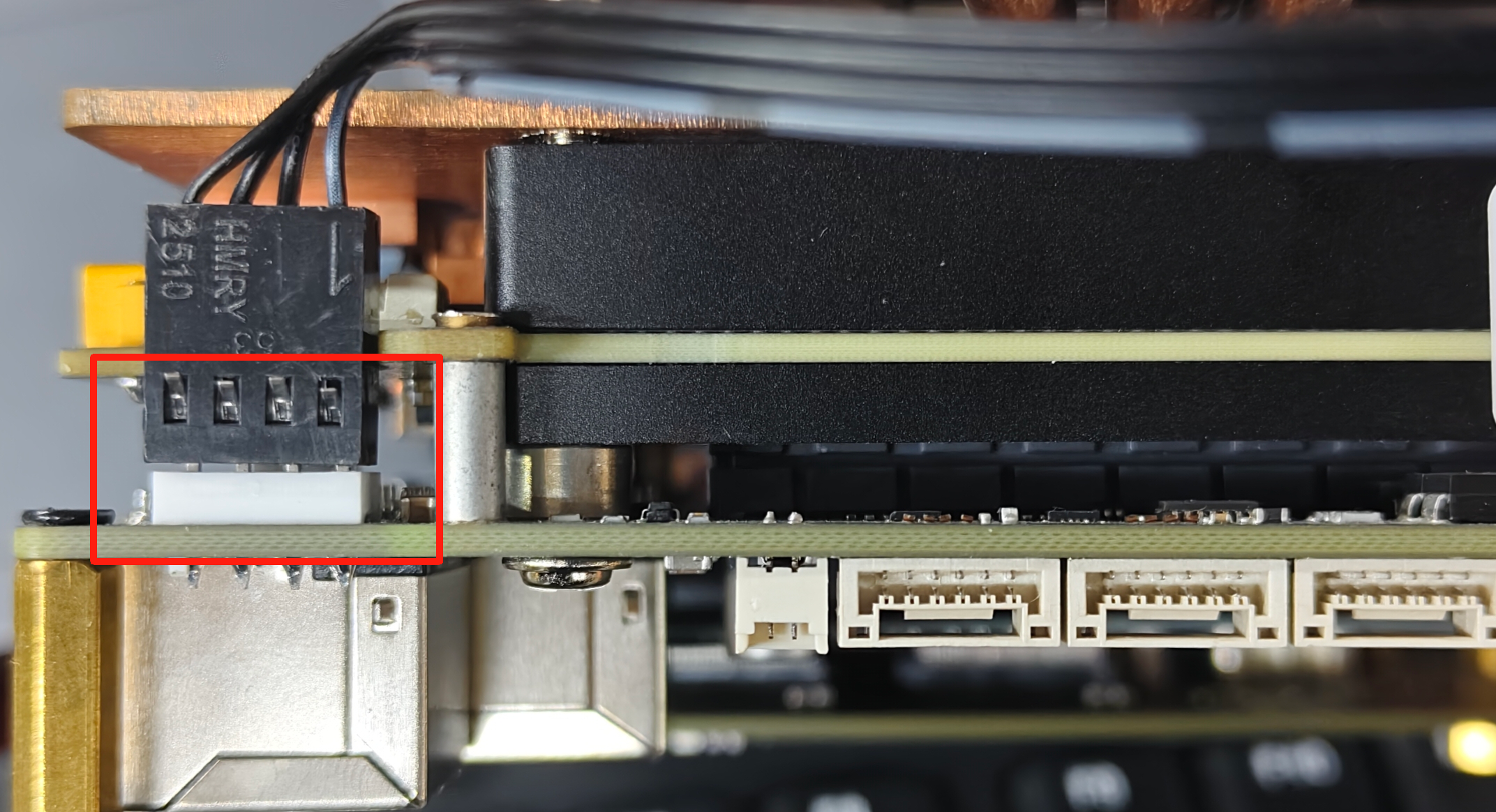

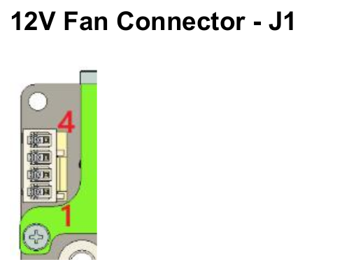

Fan
The reComputer Jetson Robotics j501-Mini is equipped with:
- 1x 4-Pin Fan Connector (12V PWM): Compatible with standard 12V PWM fans, it also supports precise speed control, making it ideal for high-performance cooling requirements.
Hardware Connection

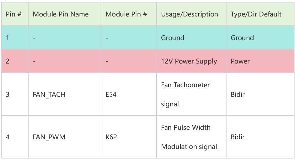

The Robotics J501 Mini provides a standard 4-pin header for Fan.
The Fan datasheet schematic is shown below:
The pin definitions for J1 are as follows:
For more information, please check here.

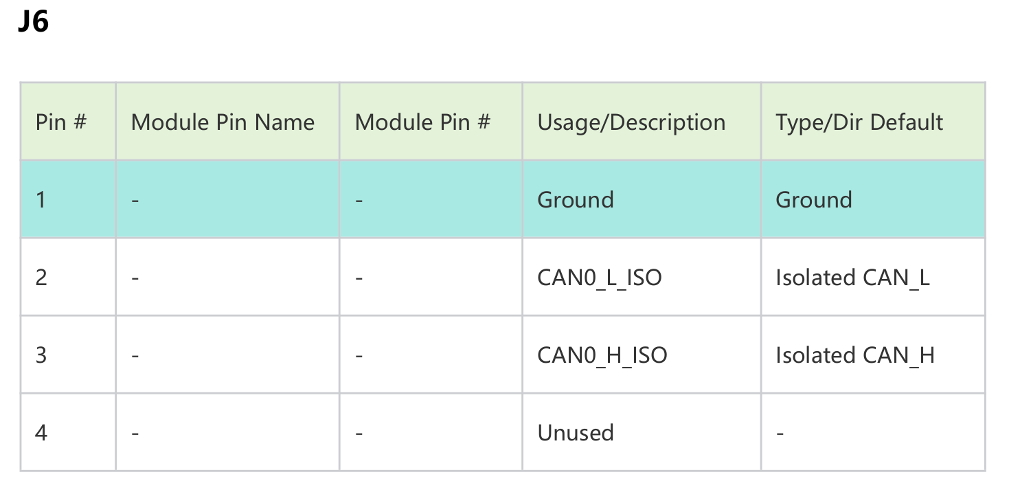

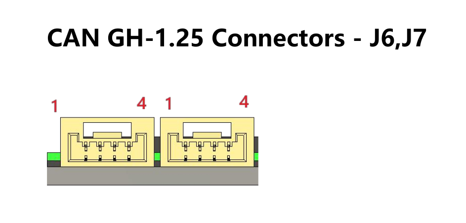

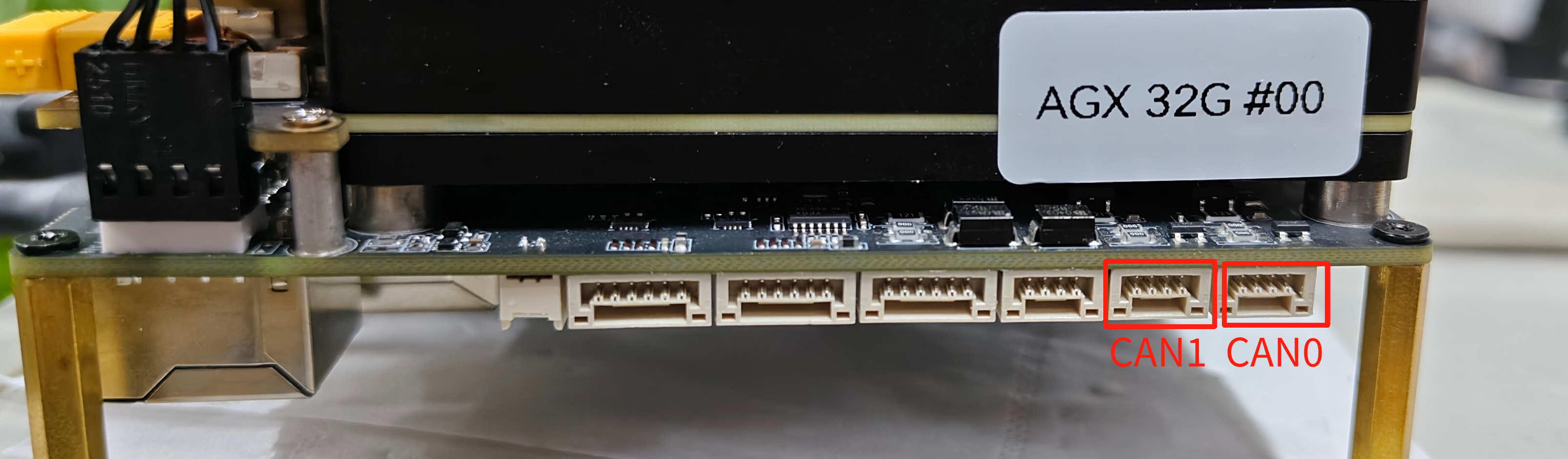

CAN
CAN (Controller Area Network) is a robust vehicle bus standard that enables microcontrollers and devices to communicate with each other without a host computer.
The J501 Mini provides two CAN interfaces integrated into the JST 4-pin(GH1.25). Additionally, both CAN interfaces support CAN-FD, with CAN0 and CAN1 shown below:
The pinout definitions for CAN0 and CAN1 are similar, and the interface diagram is shown below:

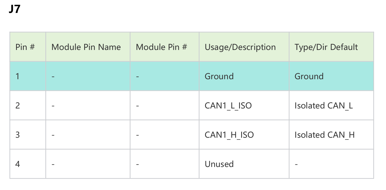

CAN0 corresponds to J6, and the pin definitions are as follows:
CAN1 corresponds to J7, and the pin definitions are as follows:

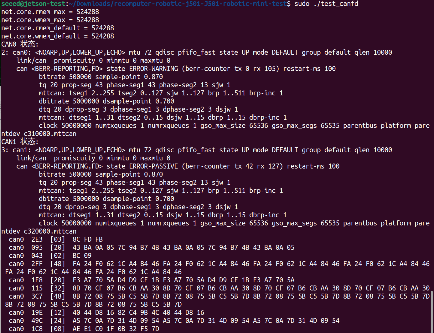

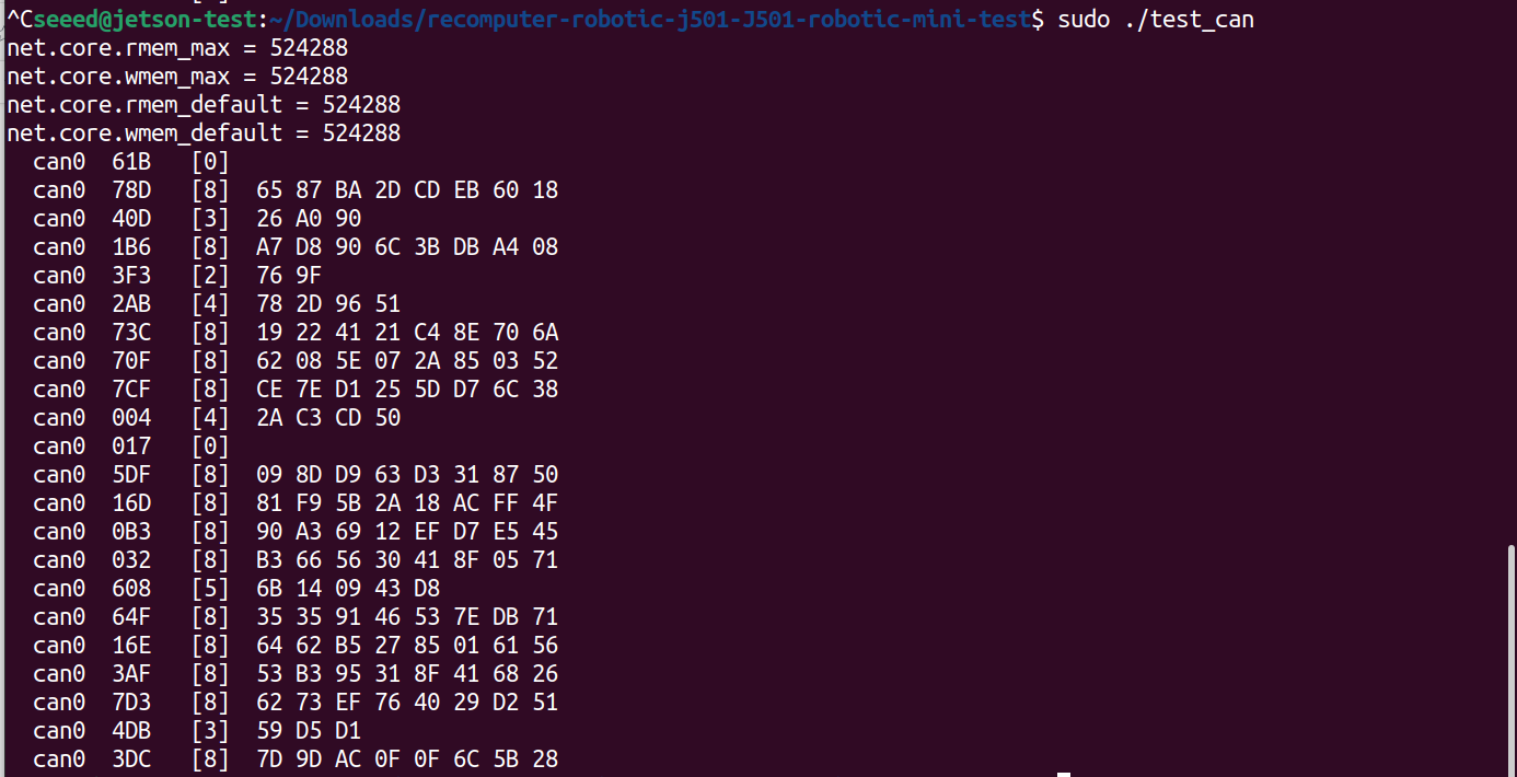

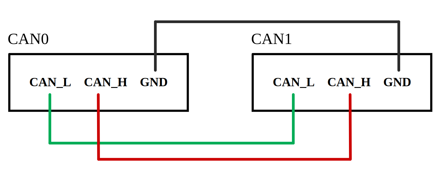

CAN Communication

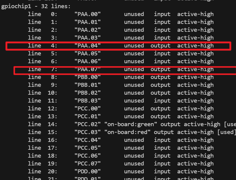

This section connects CAN0 and CAN1 on the Jetson to demonstrate how to send and receive data between CAN0 and CAN1 in Classic CAN mode and CAN-FD mode.
The termination resistors for CAN0 and CAN1 can be controlled via two pins: PAA.04, located at gpiochip1 line4, and PAA.07, located at gpiochip1 line7.
Termination resistor control follows these rules:
When `PAA.04 = 1`, the 120 Ω termination resistor of CAN0 is **disconnected**;
when `PAA.04 = 0`, the 120 Ω termination resistor of CAN0 is **connected**.
When `PAA.07 = 1`, the 120 Ω termination resistor of CAN1 is **disconnected**;
when `PAA.07 = 0`, the 120 Ω termination resistor of CAN1 is **connected**.
Enter the following command to view the pins on gpiochip 1:
gpioinfo gpiochip1
Refer to the following commands to set PAA.04 and PAA.07 to 0:
sudo gpioset --mode=wait gpiochip1 4=0
sudo gpioset --mode=wait gpiochip1 7=0
Refer to the following commands to set PAA.04 and PAA.07 to 1:
sudo gpioset --mode=wait gpiochip1 4=1
sudo gpioset --mode=wait gpiochip1 7=1
Classic CAN mode
Create test_can.sh to test data transmission and reception between CAN0 and CAN1 in standard mode:
touch test_can.sh
chmod +x test_can.sh
./tets_can.sh
The script code for test_can.sh is as follows:
test_can.sh
#!/bin/bash
echo "000000" | sudo -S ip link set can0 down
echo "000000" | sudo -S ip link set can1 down
# set buffer size
echo "000000" | sudo -S sysctl -w net.core.rmem_max=524288
echo "000000" | sudo -S sysctl -w net.core.wmem_max=524288
echo "000000" | sudo -S sysctl -w net.core.rmem_default=524288
echo "000000" | sudo -S sysctl -w net.core.wmem_default=524288
#set to 2M bps
echo "000000" | sudo -S ip link set can0 type can bitrate 2000000
echo "000000" | sudo -S ip link set can0 up
echo "000000" | sudo -S ip link set can1 type can bitrate 2000000
echo "000000" | sudo -S ip link set can1 up
sleep 2
#Enable 5s to test
sudo pkill -f gpioset
gpioset --mode=time --sec=200000 gpiochip1 7=0 &
GPIO1_PID=$!
gpioset --mode=time --sec=200000 gpiochip1 4=0 &
GPIO2_PID=$!
cangen can1 &
candump can0
Data transmission and reception between CAN0 and CAN1 will be completed:
CAN-FD mode
In the datasheet, you can find the wiring diagram for the CAN0/CAN1 interface as shown below:
Create test_canfd.sh to test data transmission and reception between CAN0 and CAN1 in CAN-FD mode:
touch test_canfd.sh
./tets_can.sh
The script code for test_canfdfd.sh is as follows:
test_canfd.sh
#!/bin/bash
# configure CAN FD mode
#CAN bus rate set to 500 kbps, data rate set to 5 Mbps.
echo "000000" | sudo -S sudo ip link set can0 type can bitrate 500000 dbitrate 5000000 berr-reporting on fd on restart-ms 100
echo "000000" | sudo -S sudo ip link set can1 type can bitrate 500000 dbitrate 5000000 berr-reporting on fd on restart-ms 100
# config buffer size
# check CAN FD status
echo "CAN0 status:"
ip -details link show can0
echo "CAN1 status:"
ip -details link show can1
#Enable 5s to test
GPIO1_PID=$!
GPIO2_PID=$!
candump can0 &
cangen can1 -f

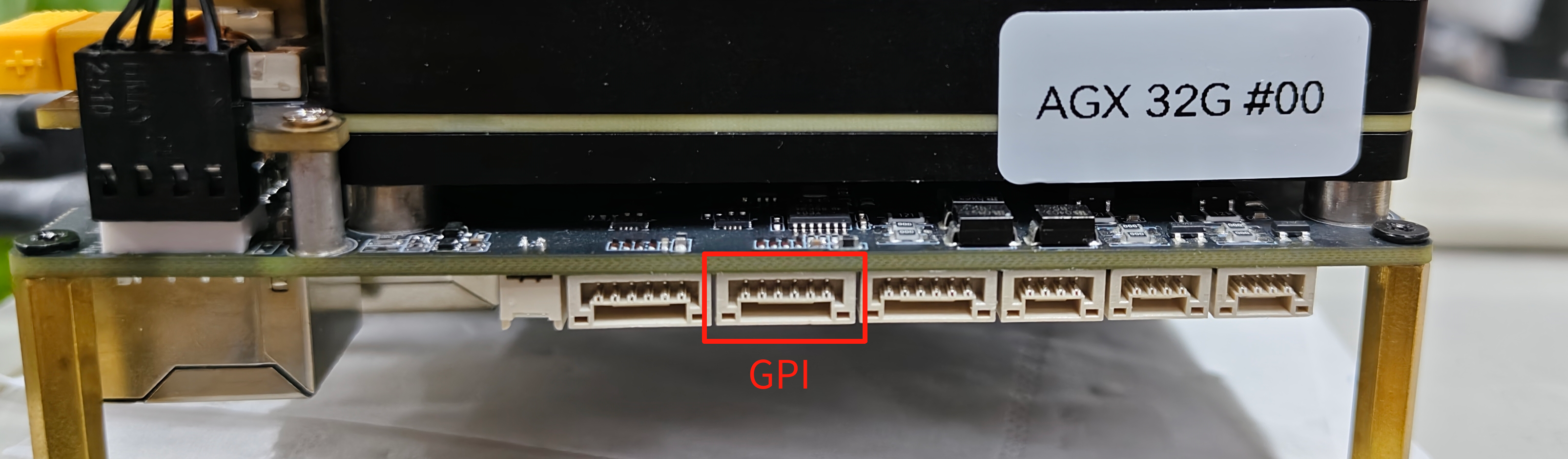

GPI && GPO

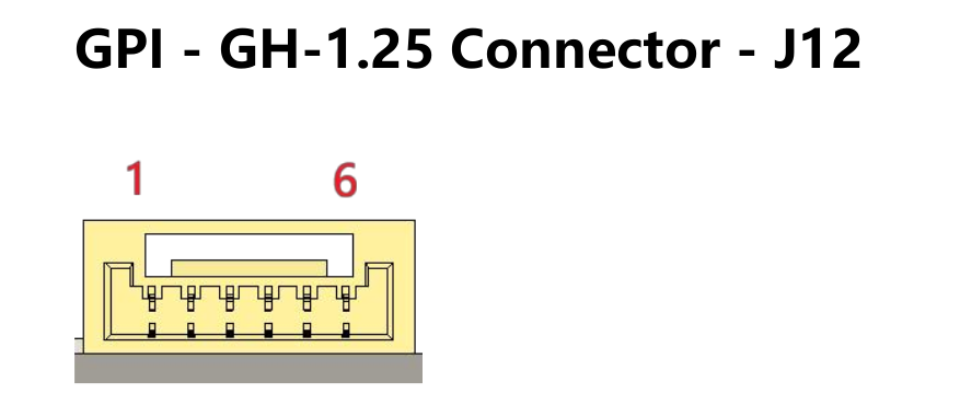

GPI
The Robotics J501 Mini provides a standard 6-pin JST header for GPI.
The GPI datasheet schematic is shown below:
The pin definitions for J12 are as follows:
Enable GPI 1 to GPI 4 for reading input status:
sudo gpioset --mode=wait 0 131=0
To read the input of GPI 1 to GPI 4, refer to the following commands:
sudo gpioget 0 96 #read the input of GPI 1
sudo gpioget 0 104 #read the input of GPI 2
sudo gpioget 0 86 #read the input of GPI 3
sudo gpioget 0 83 #read the input of GPI 4
When a high level is read, it will return 1; when a low level is read, it will return 0.

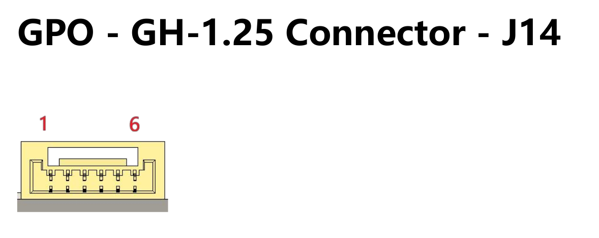

GPO
The Robotics J501 Mini provides a standard 6-pin JST header for GPO.
The GPO datasheet schematic is shown below:
The pin definitions for J14 are as follows:
Enable GPO 1 to GPO 4 for output status:
sudo gpioset --mode=wait 0 79=1
To set the output of GPO 1 to GPO 4, refer to the following commands:
sudo gpioset --mode=wait 0 110=1 #set output of GPO 1 to high voltag
sudo gpioset --mode=wait 0 112=1 #set output of GPO 2 to high voltag
sudo gpioset --mode=wait 0 111=1 #set output of GPO 3 to high voltag
sudo gpioset --mode=wait 0 113=1 #set output of GPO 4 to high voltag
sudo gpioset --mode=wait 0 110=1 #set output of GPO 1 to low voltag
sudo gpioset --mode=wait 0 112=1 #set output of GPO 2 to low voltag
sudo gpioset --mode=wait 0 111=1 #set output of GPO 3 to low voltag
sudo gpioset --mode=wait 0 113=1 #set output of GPO 4 to low voltag
UART
The Robotics J501 Mini provides a standard 6-pin JST header for UART serial communication. UART and GPO use the same JST interface. This interface defaults to GPO functionality. If you need to switch to UART functionality, you must point to a new device tree and restart the device for the change to take effect.
For UART communication, please follow the following wiring. Here, we use the USB to TTL tool as an example.
The UART datasheet schematic is shown below:
UART and GPO share the same physical interface. By default, this interface functions as GPO. If you need to switch to UART, please refer to the content of this section.
For different modules, you need to download the corresponding device tree file.
.dtb download link for AGX Orin 32G:
https://files.seeedstudio.com/wiki/recomputer-j501-mini/tegra234-j501x-0000%2Bp3701-0004-recomputer-mini.dtb
.dtb download link for AGX Orin 64G:
https://files.seeedstudio.com/wiki/recomputer-j501-mini/tegra234-j501x-0000%2Bp3701-0005-recomputer-mini.dtb
Copy the device tree to the specified path:
# AGX Orin 32G
sudo cp tegra234-j501x-0000%2Bp3701-0004-recomputer-mini.dtb /boot/
# AGX Orin 64G
sudo cp tegra234-j501x-0000%2Bp3701-0005-recomputer-mini.dtb /boot/

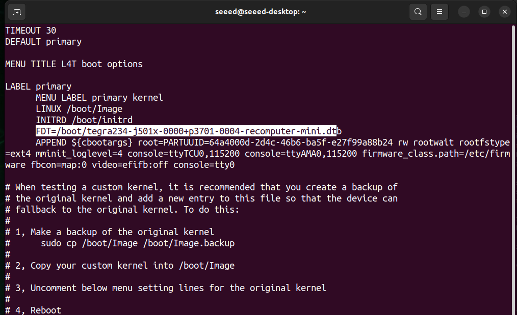

Back up and modify /boot/extlinux/extlinux.conf, adding a line to point to the new .dtb file:
sudo cp /boot/extlinux/extlinux.conf /boot/extlinux/extlinux.conf.bak
sudo vim /boot/extlinux/extlinux.conf
Based on the device tree file name you are using, add a line FDT=/your_path in extlinux.conf. Taking AGX Orin 32G as an example:
LABEL primary
MENU LABEL primary kernel
LINUX /boot/Image
INITRD /boot/initrd
FDT=/boot/tegra234-j501x-0000+p3701-0004-recomputer-mini.dtb
The 6-pin JST header UART is mapped to /dev/ttyTHS1 on the Jetson. You can use minicom to view serial port data transmission and reception:
sudo apt install minicom
sudo minicom -D /dev/ttyTHS1
RS485
The RS485 interface provides a robust and noise-resistant differential communication channel commonly used in industrial environments. It supports long-distance, multi-drop serial communication and is ideal for connecting sensors, motor controllers, PLCs, and other industrial devices.
Hardware Connection
Robotics J501-Mini provides a JST 4-pin(GH 1.25) headers for RS485.
The RS485 datasheet schematic is shown below:
The pin definitions for J8 are as follows:

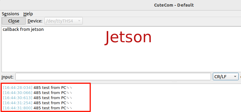

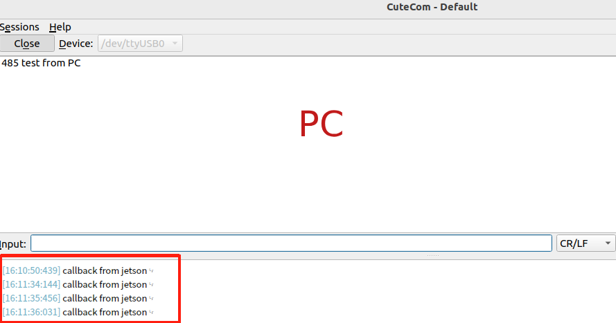

The RS485 interface is mapped to /dev/ttyTHS4 on the Jetson. You can use cutecom to test serial data transmission and reception with a PC:
sudo apt install cutecom
sudo cutecom
Select /dev/ttyTHS4, set both Jetson and PC to a baud rate of 9600, and connect the Jetson and PC via an RS485 to USB module.
The serial data transmission and reception effect is shown in the figure below:

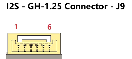

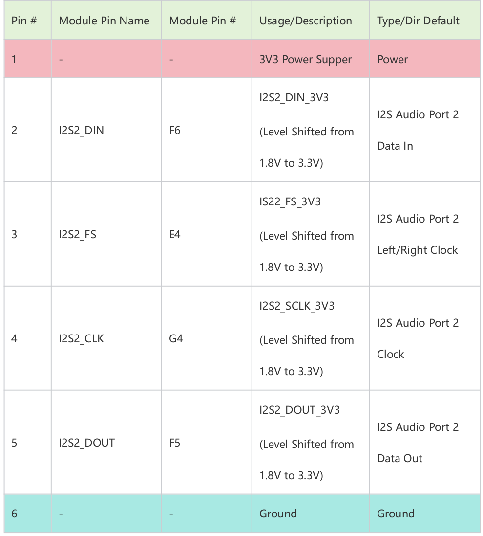

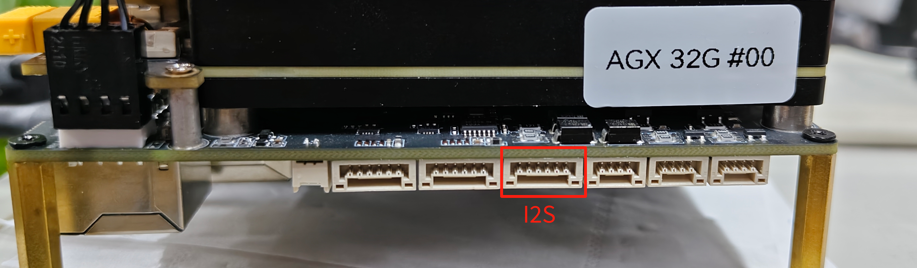

I2S
The I2S interface provides a digital audio communication bus designed for transmitting stereo audio data between devices. The Robotics J501-Mini supports standard I2S signaling, allowing high-quality, low-latency audio input and output for applications such as voice interaction, sound localization, and real-time audio processing.
Hardware Connection
Robotics J501-Mini provides a 1x JST 5-Pin Connector(GH 1.25) for I2S.
The I2S datasheet schematic is shown below:
The pin definitions for J9 are as follows:

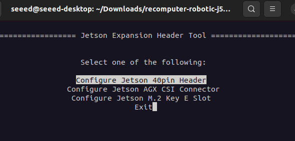

Usage Instruction

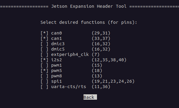

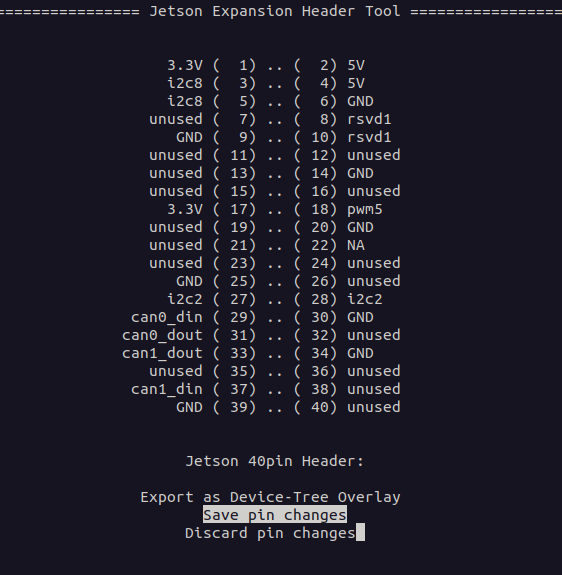

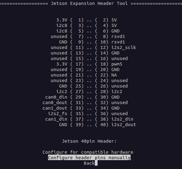

To enable I2S, you need to configure it in jetson-io.py. Run the following in the terminal:
sudo python /opt/nvidia/jetson-io/jetson-io.py
Then, refer to the four steps below to enable the I2S interface:
- step1: Select the Jetson 40-pin header option
- step2: Select Configure header pins manually
- step3: Select
i2s2; after selection, it will be marked with[*] - step4: Save the settings and reboot the Jetson

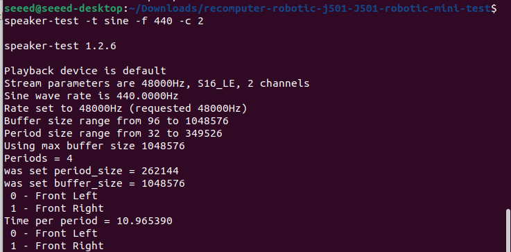

After enabling I2S, this section demonstrates how to use I2S to drive a dual-channel speaker. First, enter the following in the terminal:
amixer -c APE cset name="I2S2 Mux" "ADMAIF1" # Speaker
If you are using a microphone:
amixer -c APE cset name="ADMAIF2 Mux" "I2S2" # Microphone
Refer to the command below to drive the speaker, where -c should be changed to the number of speaker channels you are using:
speaker-test -t sine -f 440 -c 2
You can see the output in the terminal when the speaker is driven normally, as shown in the figure below.

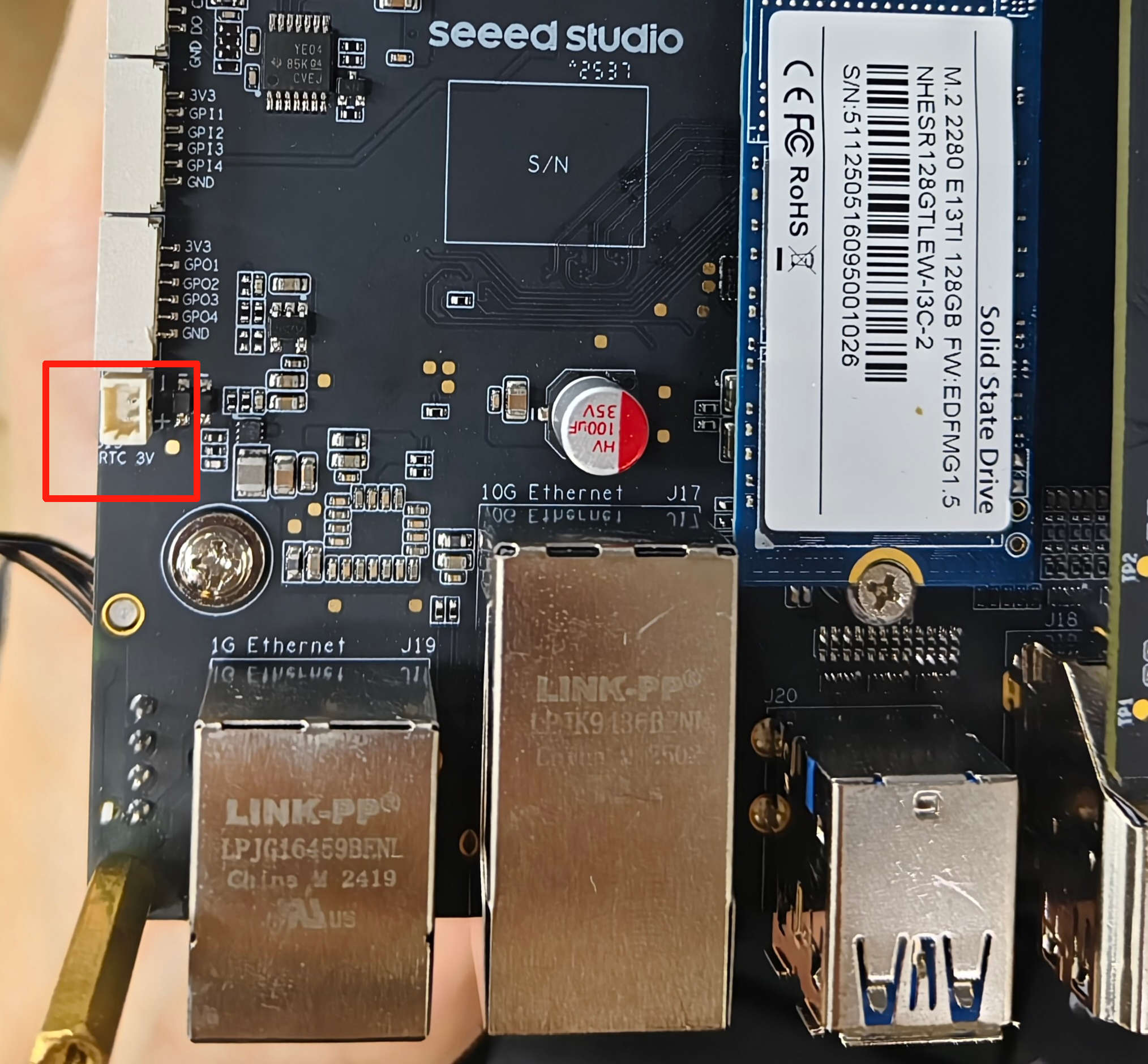

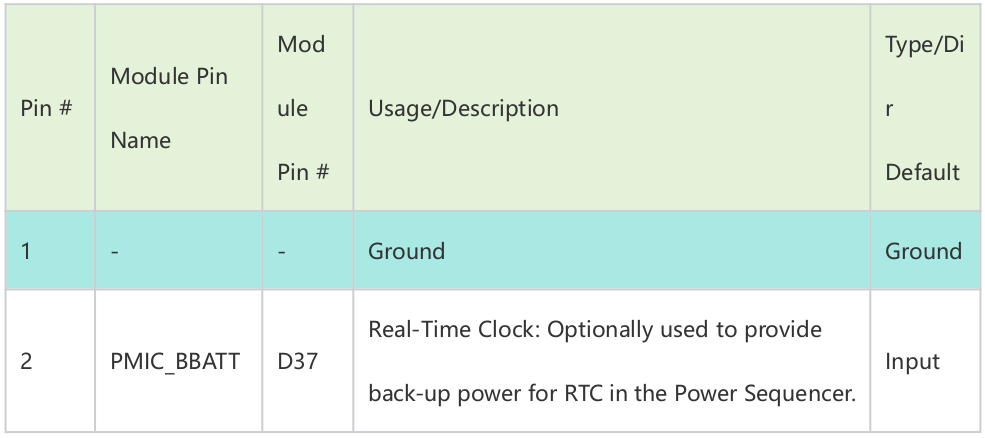

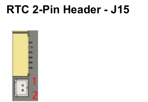

RTC
The Robotics J501-Mini provides a standard 2-pin header for RTC (3V).
The RTC datasheet schematic is shown below:
The pin definitions for J15 are as follows:
After plugging in the external battery, you can check the operating status of rtc0 (main RTC, corresponding to the onboard battery) in the terminal:
cat /sys/class/rtc/rtc0/power/runtime_status

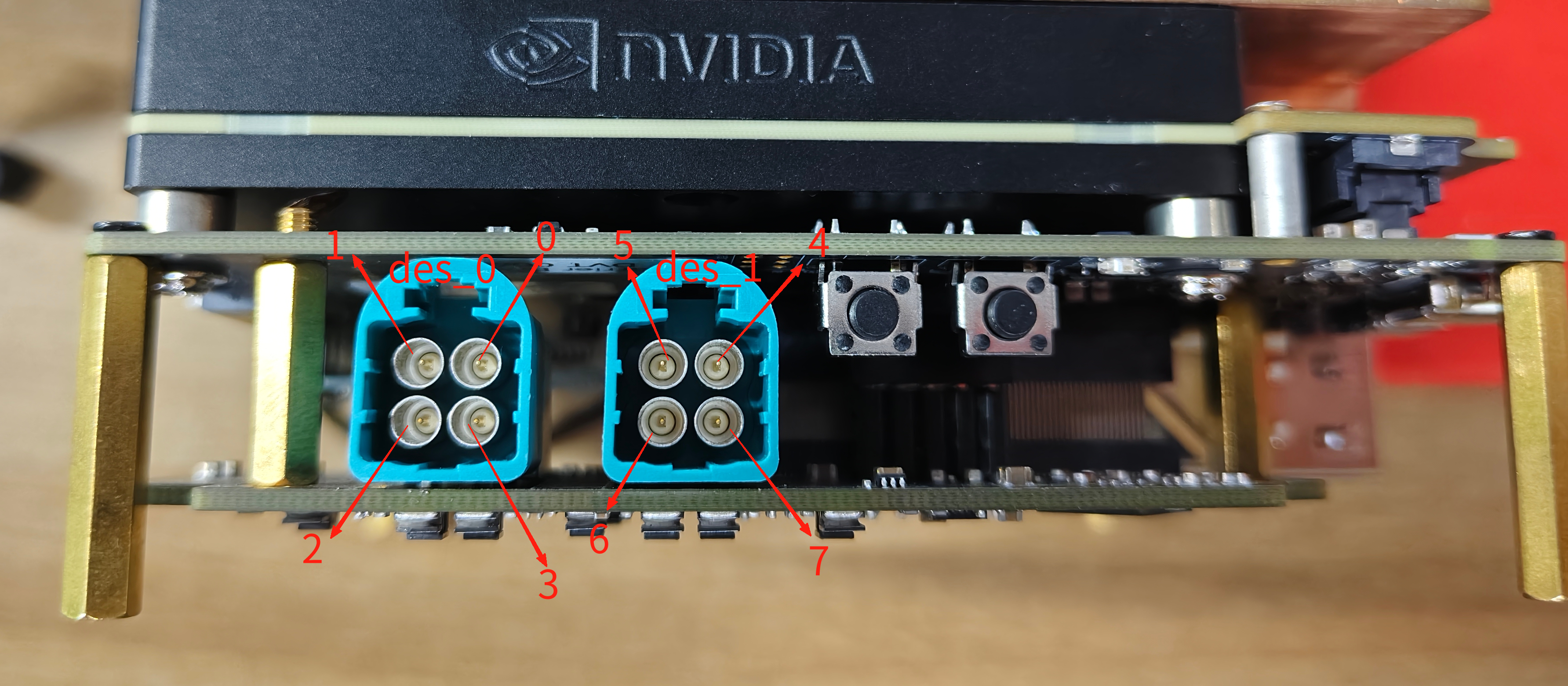

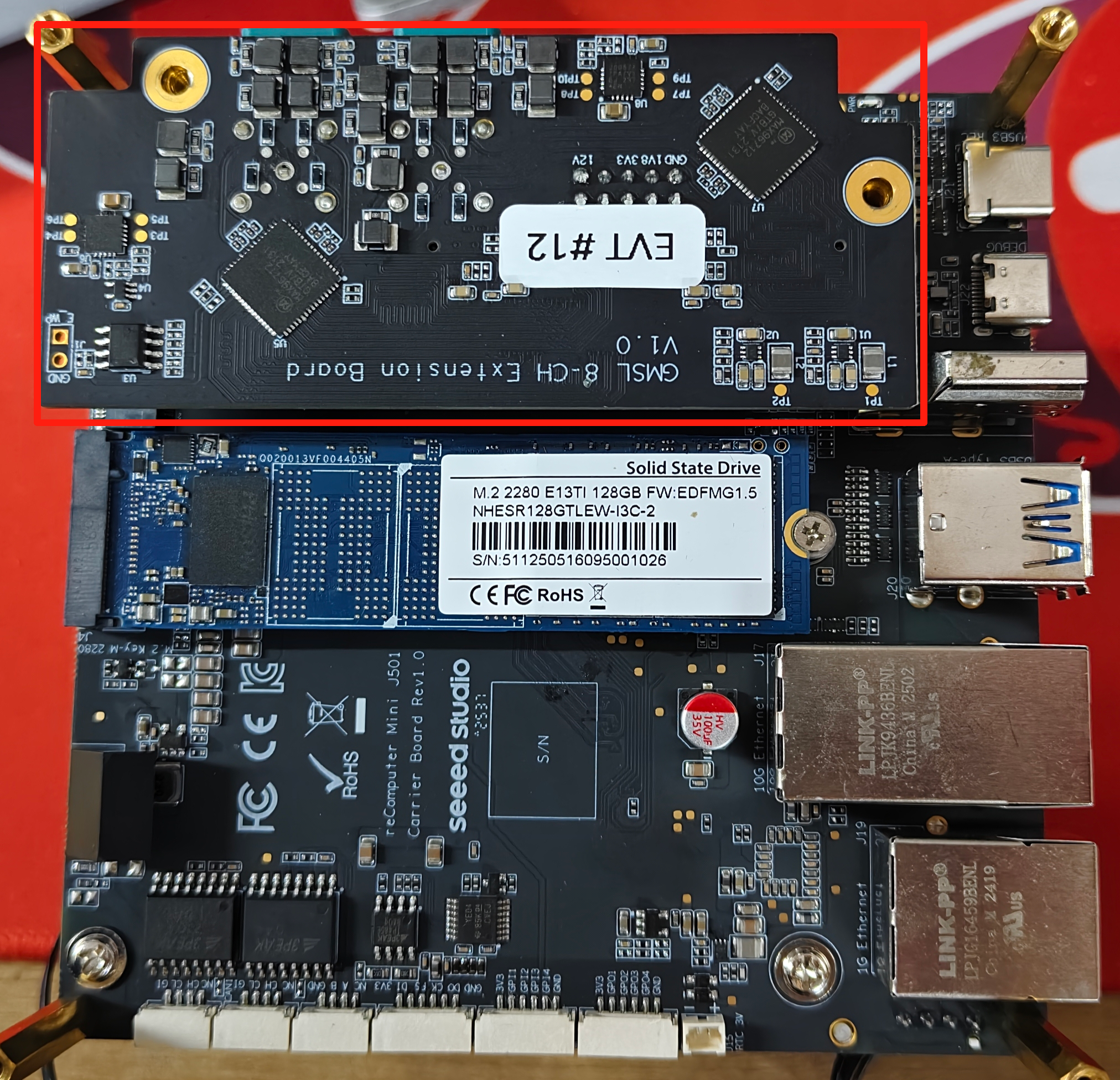

Extension Port - GMSL
The Robotics j501-Mini carrier board features a Camera Expansion Header for GMSL extension board. It can simultaneously connect and operate four GMSL cameras at the same time.
Hardware Connection
Here are the Robotics j501-Mini carrier board GMSL camera expansion board connection slot(need to prepare an extension board in advance):
The following are the GMSL camera models that we have already supported:
- SG3S-ISX031C-GMSL2F
- SG2-AR0233C-5200-G2A
- SG2-IMX390C-5200-G2A
- SG8S-AR0820C-5300-G2A
