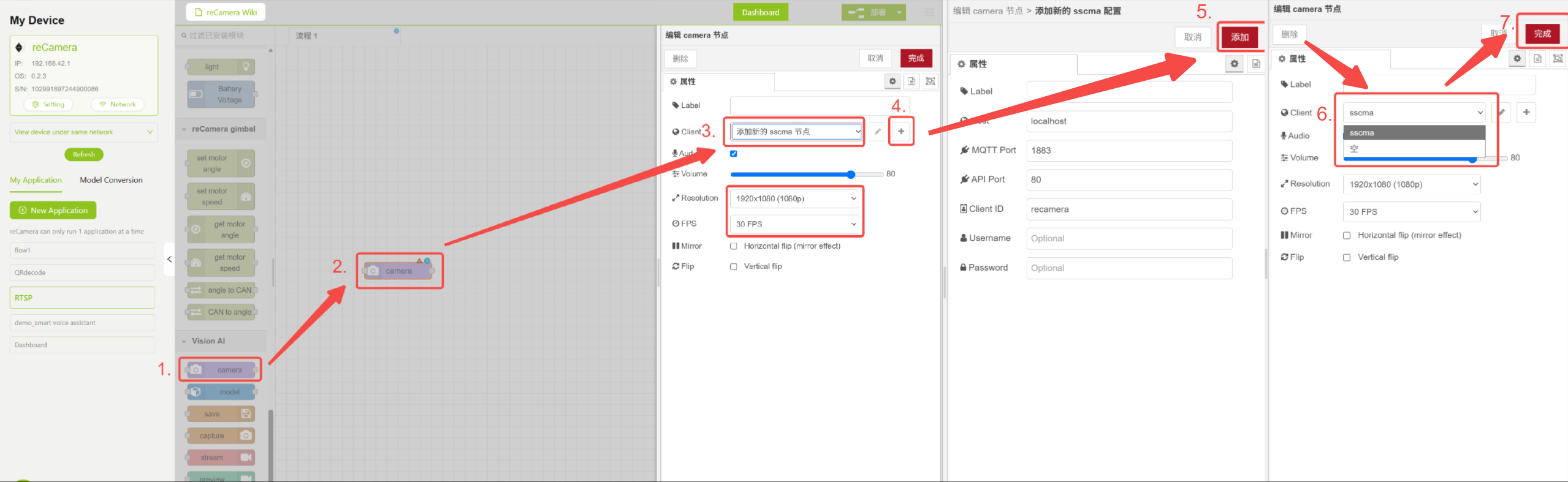

2.1 Import and Configure the Camera Node
Drag the Camera Node from the left side to the workspace, and double-click to enter the configuration interface. You can set parameters such as resolution and frame rate as needed. Import and configure the camera node according to the workflow shown below.
Camera Parameter Configuration

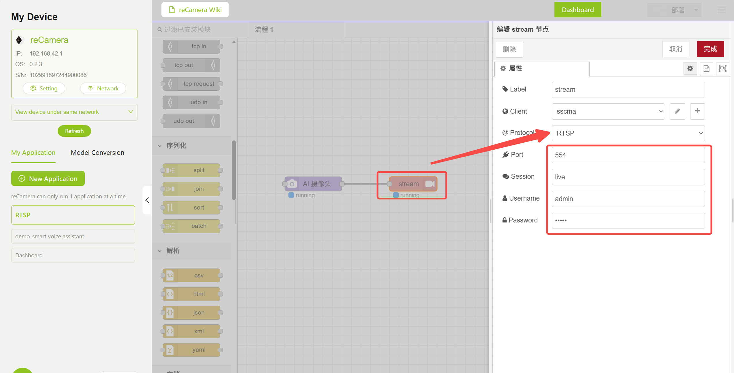

2.2 Import and Configure the Stream Node
Drag the Stream Node from the left side to the workspace, select the RTSP protocol and configure the stream address and port. The default RTSP stream address for reCamera is:
rtsp://admin:admin@192.168.42.1:554/live
RTSP Streaming Parameter Configuration

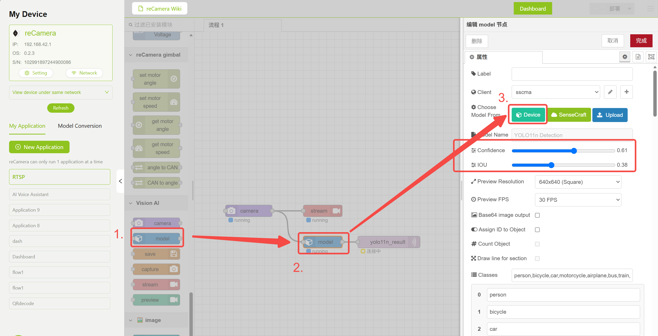

2.3 Import the Model Node
Drag the Model Node from the left side to the workspace, click Device and select the YOLO11n Detection model.

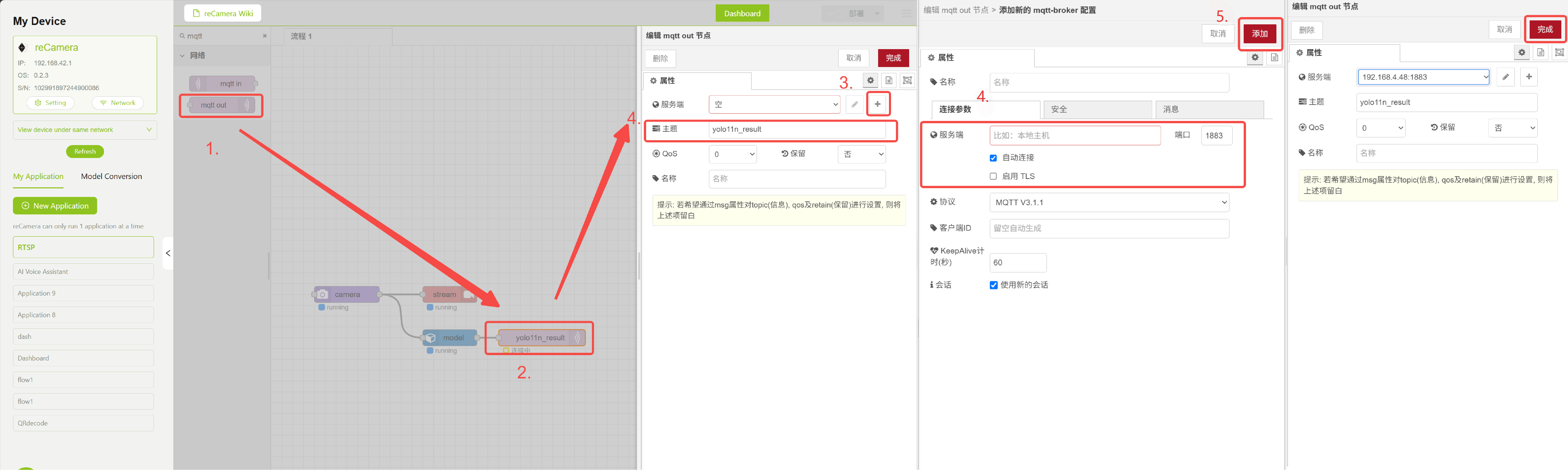

2.4 Import the MQTT Out Node
Drag the MQTT Out Node from the left side to the workspace, and follow the diagram below to set the MQTT broker address and the topic for communicating with the server.
After configuration is complete, click Deploy in the upper right corner to deploy the workflow, and reCamera will start streaming via the RTSP protocol.

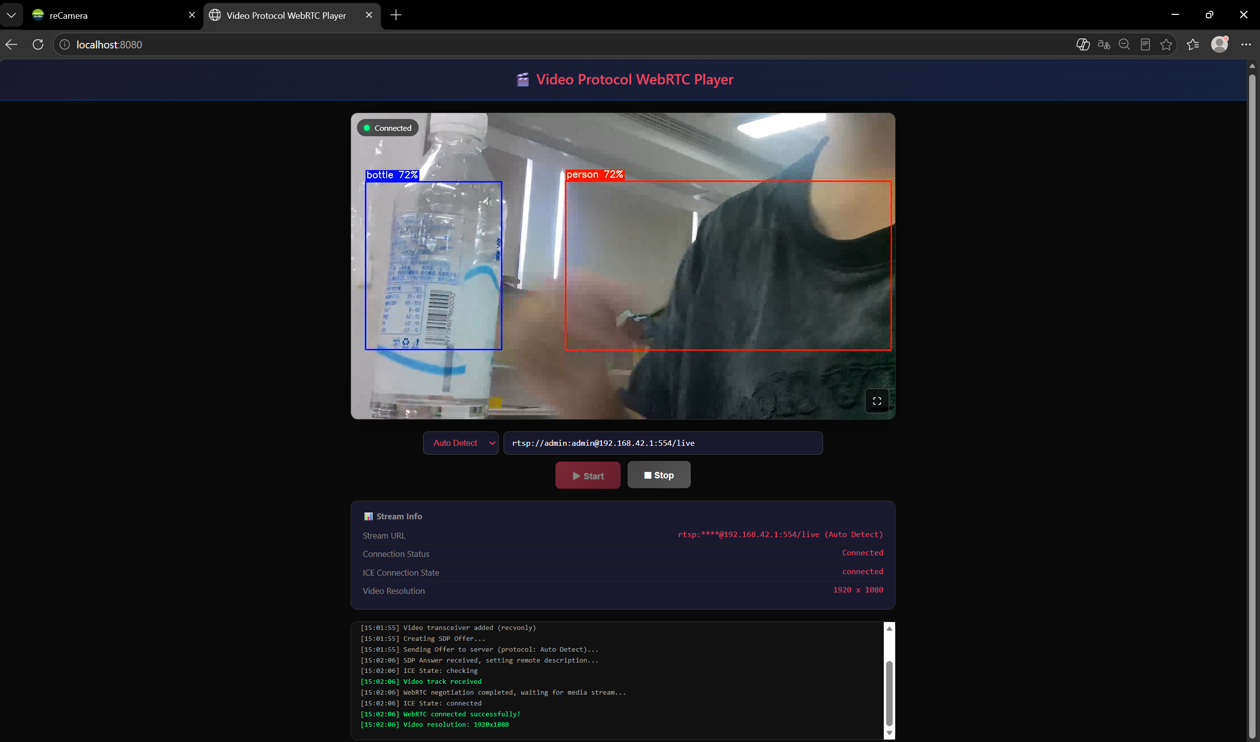

http://localhost:8080in the PC browser - Select the protocol (RTSP) on the page and enter the reCamera's RTSP stream address (filled in by default)
- Click the "Start Playing" button

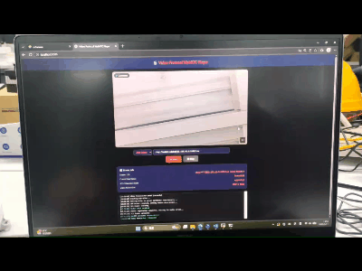

Real-time playback of reCamera video in browser
After a successful connection, the page will display the following information:
- Video Feed: Real-time display of reCamera's video
- Connection Status: Green connection status indicator in the upper left corner of the page
- Stream Information: Displays video stream address, connection status, ICE connection status, and video resolution
- Operation Log: Detailed connection logs displayed at the bottom of the page
