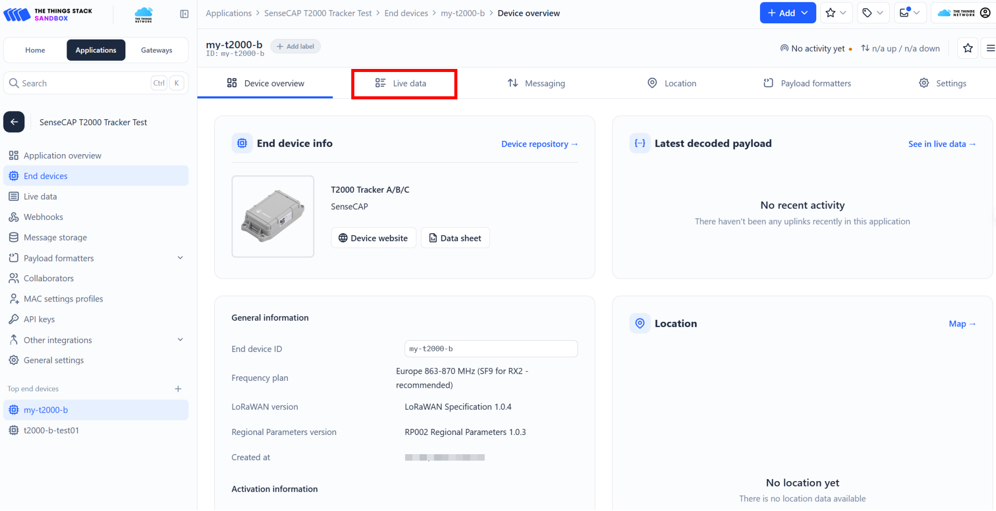

Step 1: Create an Application​
Navigate to Applications page, click Add application.
pir
Enter an Application ID, Application name, click Create application to save your changes.
pir

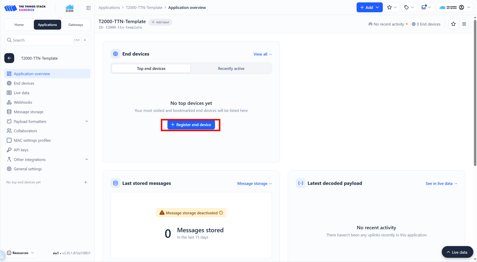

Step 2: Register the Device​
After the application was created, click Register end device.
pir

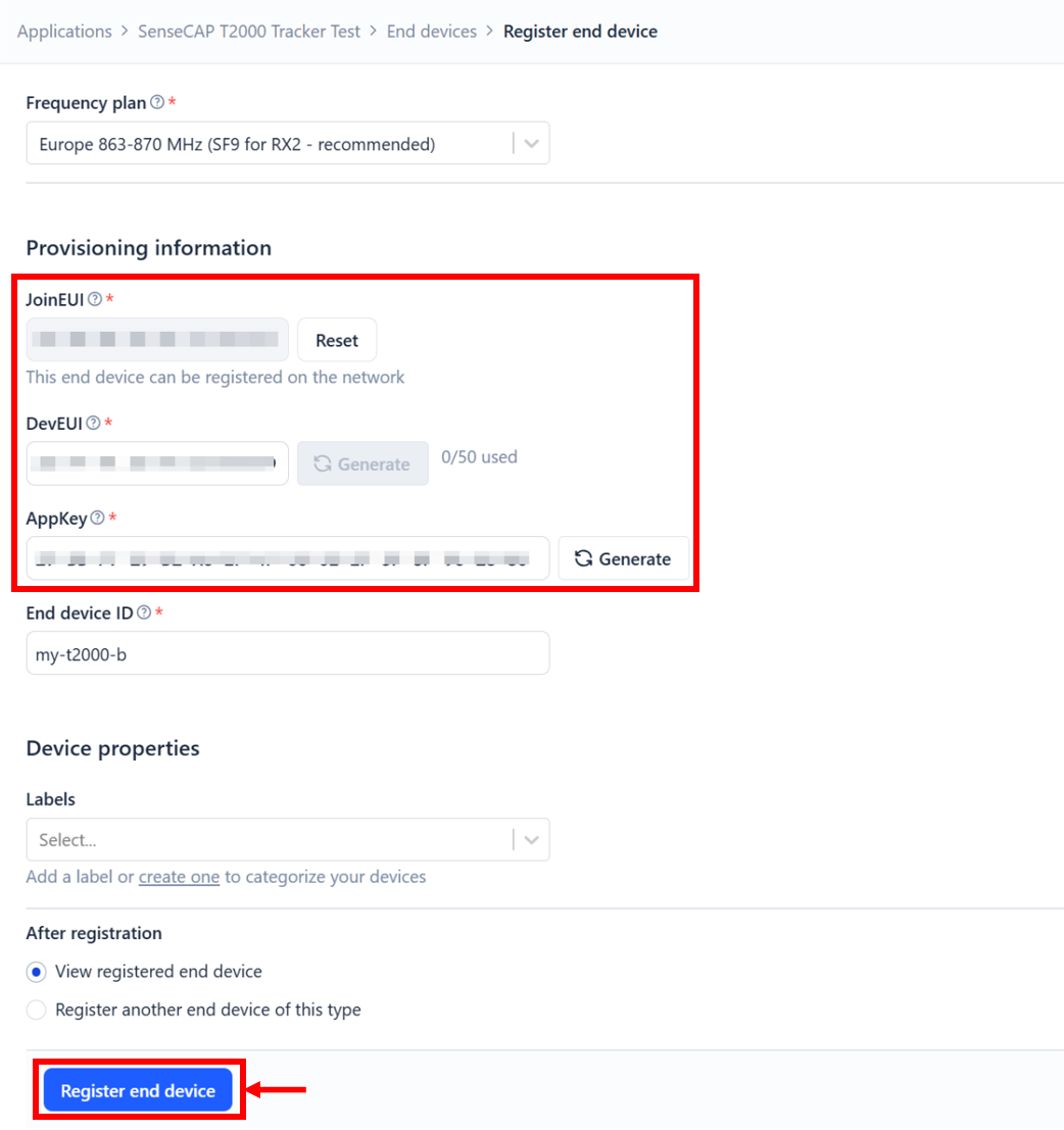

Choose an appropriate Frequency Plan. Your device and gateway must use the same frequency plan to communicate.
Paste the Device EUI / AppEUI / AppKey from the SenseCraft App, and then click Register end device.
note
The "JoinEUI" above is simliar to "AppEUI".

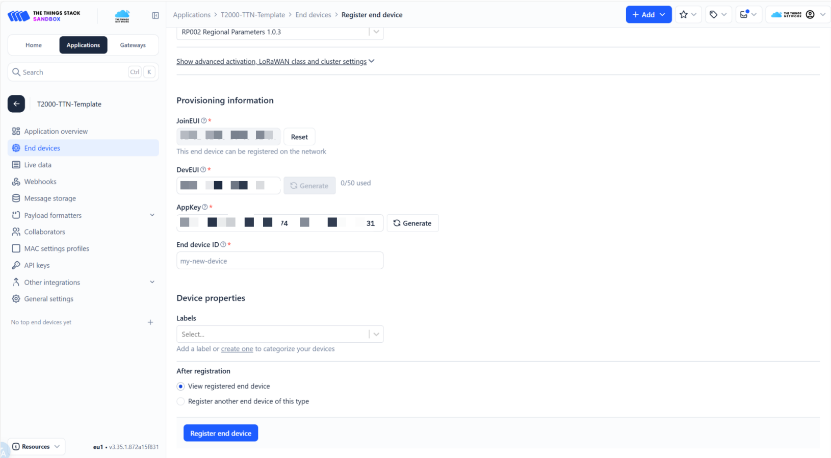

2. Enter end device specifics manually​
Alternatively, you can choose the Enter end device specifics manually. And please refer to the information below to ensure entering the following information correctly.
pir
info
Select LoRaWAN Version and Regional Parameters version fields for your specific device.
LoRaWAN version: LoRaWAN Specification 1.0.4
Regional Parameters version: RP002 Regional Parameters 1.0.3

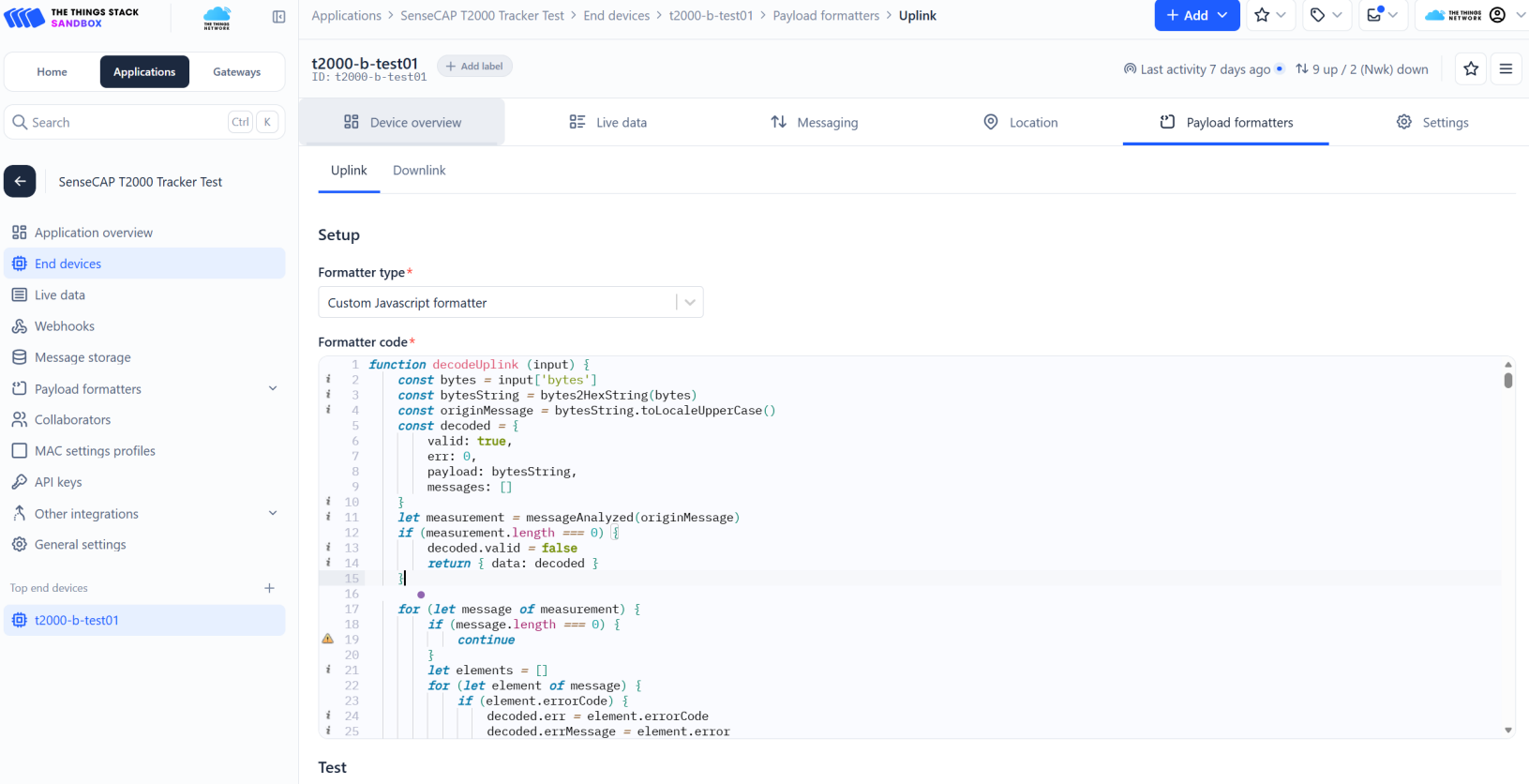

Then upload the Payload Formatter.
Navigate to Payload Formatters page, choose Custom Javascript Formatter. Fill in the Formatter code with the decoder below and save changes:
For TTN(ChirpStack V4)

Step 3: Check the Data​
When the device tries to connect to the network, the green breathing light will flash. If the device joins the network successfully, the green light will flash 5 times quickly.
You can check the device's activity in the Application overview page.
pir

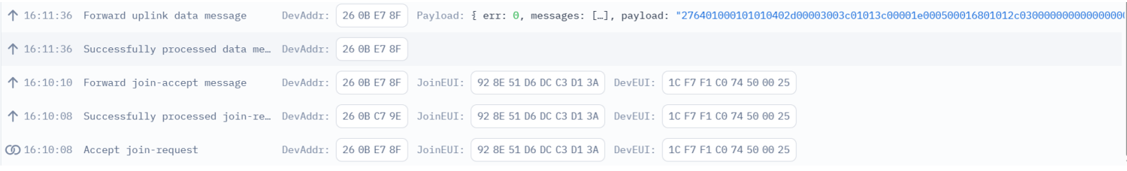

Click the end device, then check the Live data. When you see the message below, your device has successfully join the network.
pir
pir

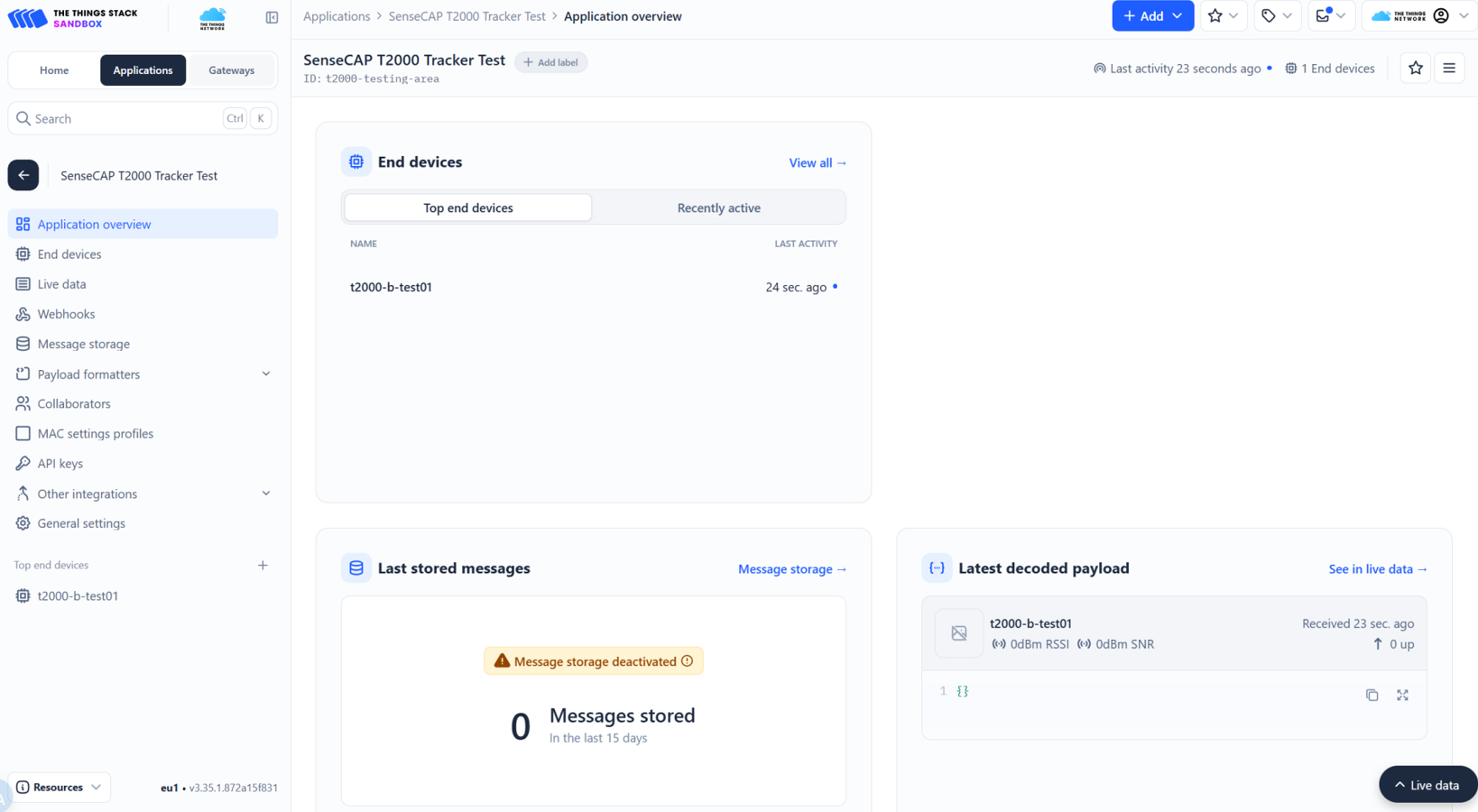

Then you can check the data on the TTS console.
pir
