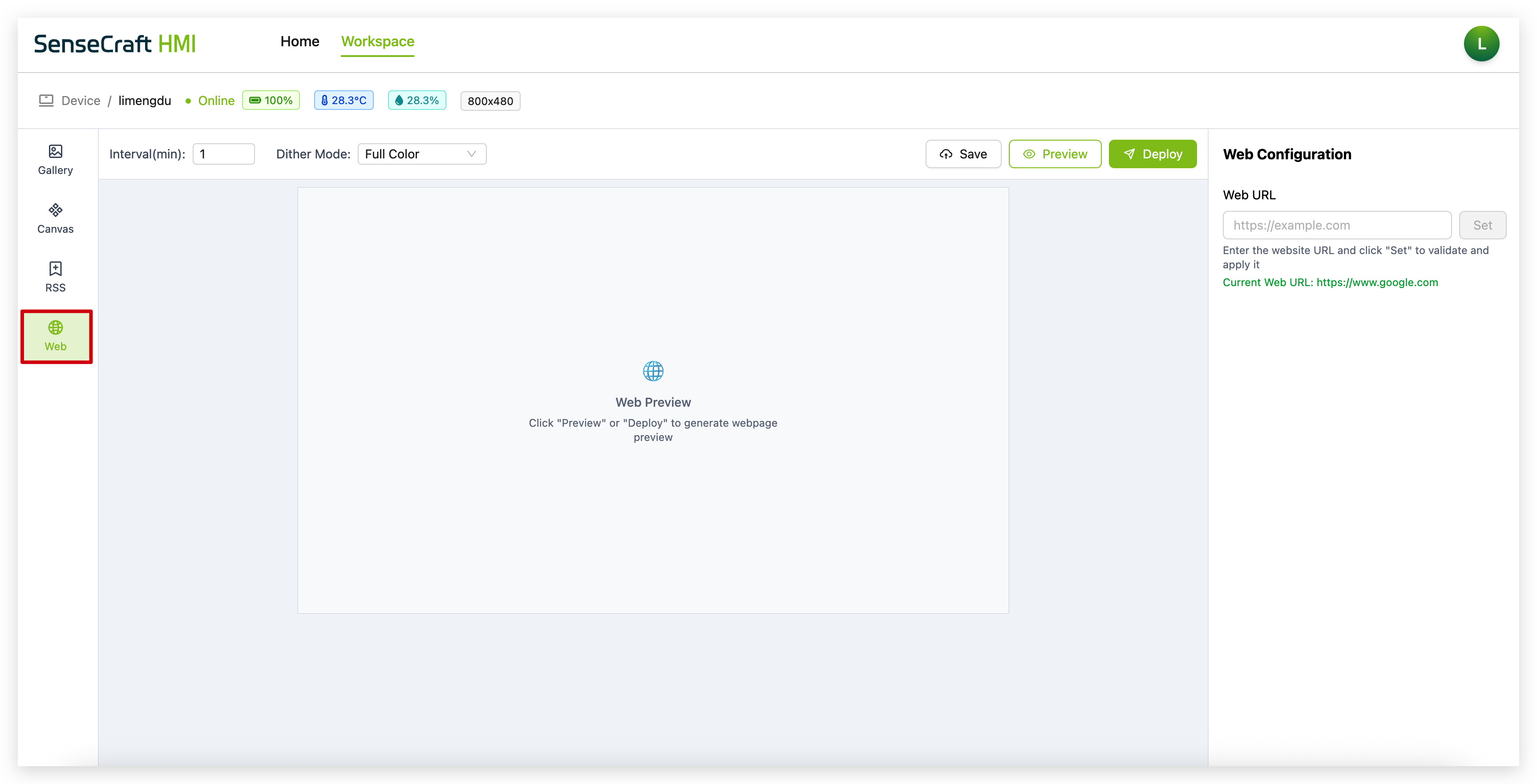

Accessing the Web Function
Step 1. Navigate to the SenseCraft HMI platform below.
Step 2. Connect your device or select an already paired device to use.
Step 3. Click on the "Web" tab in the left sidebar

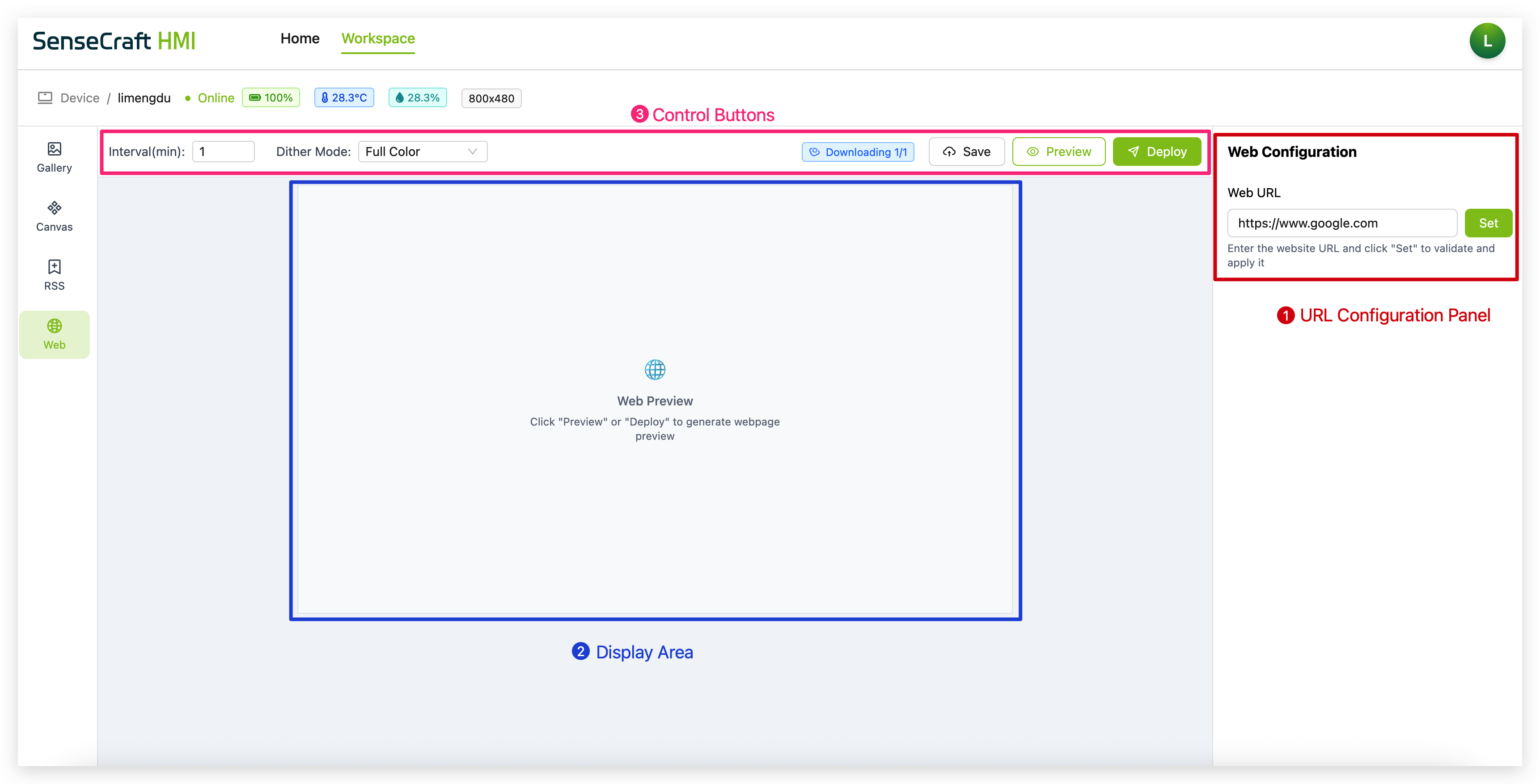

Understanding the Web Interface
The Web interface consists of three main sections:
  1. URL Configuration Panel: Located on the right side, where you can enter web addresses
  2. Display Area: The main section where web content will be displayed after preview or deployment
  3. Control Buttons: Located at the top, including Preview, Save, and Deploy options
When first accessing the Web function, the display area will be empty until you configure and preview a web page.

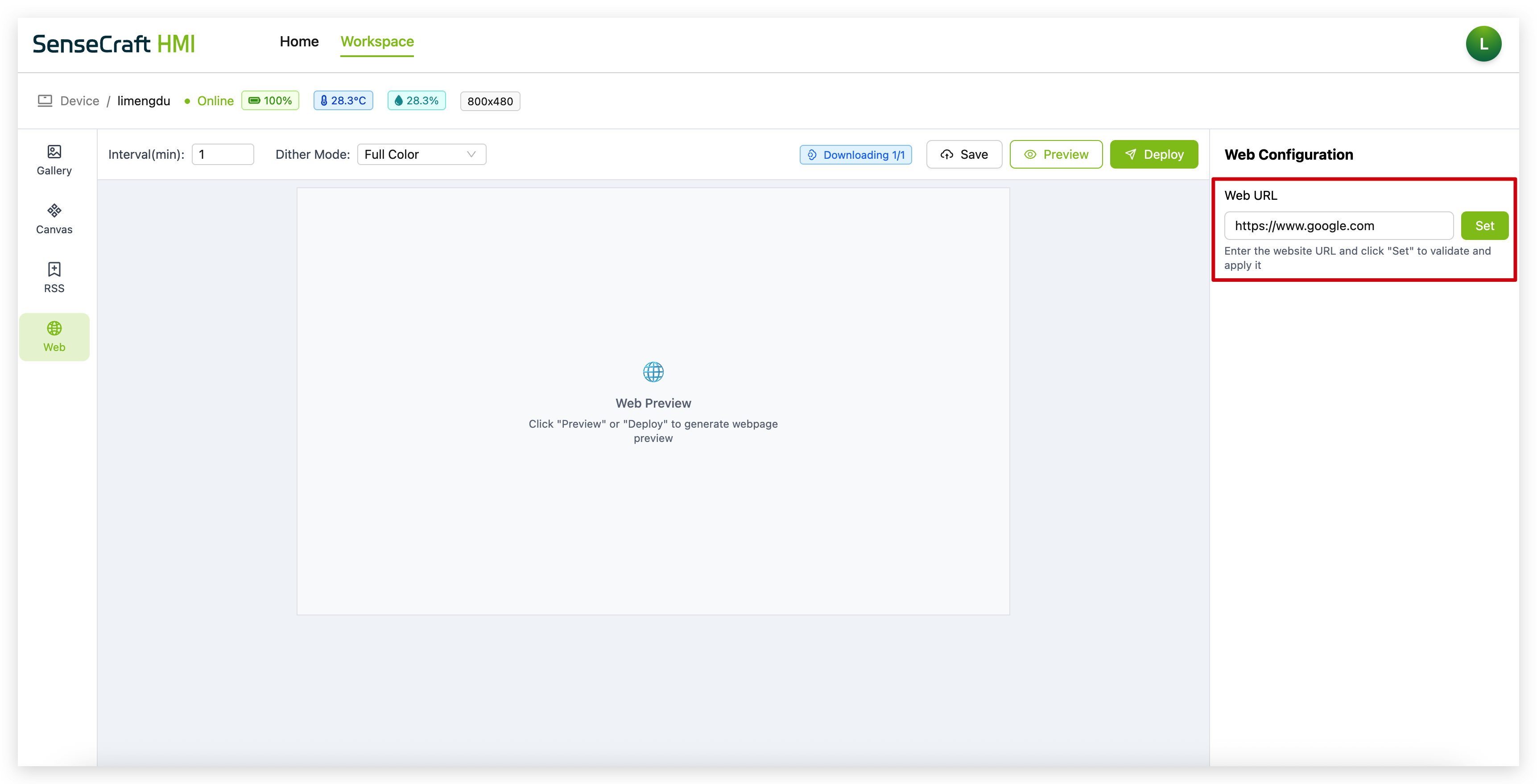

Step 1. Locate the Web Configuration panel on the right side of the screen
Step 2. Find the "URL" input field
Step 3. Enter a valid web address in the field (e.g., https://weather.gov/)
tip
Make sure to include the complete URL including the https:// or http:// prefix.
Step 4. Click the "Set" button to validate the URL

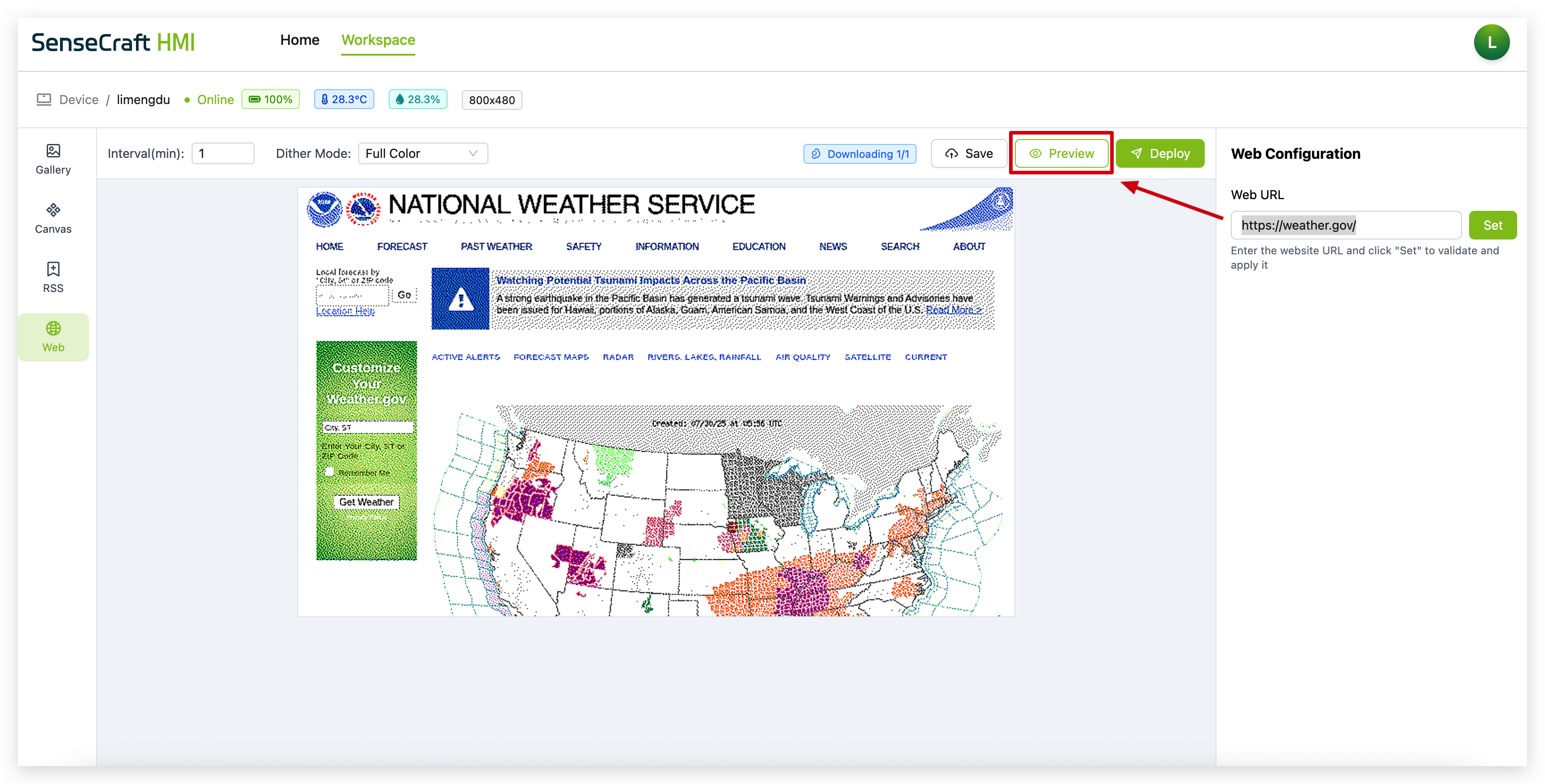

Previewing Web Content
Unlike other functions in SenseCraft HMI, the Web function requires an explicit preview step to display content:
Step 1. After entering and setting a URL, click the "Preview" button in the top toolbar
Step 2. Wait for the web page to load in the display area
Step 3. Check if the web content displays correctly and is appropriate for your device's screen size
note
The preview step is crucial as it allows you to verify that the web content will display properly on your device before deployment.

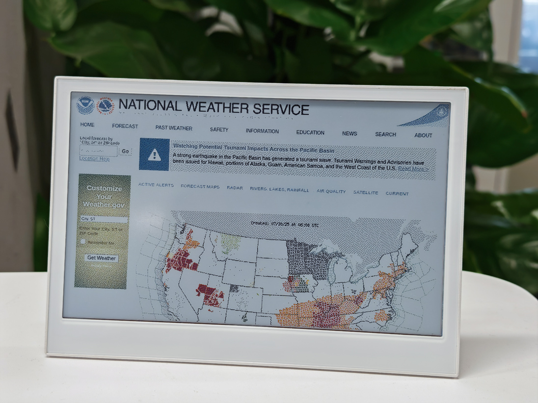

Step 2. Click "Deploy" to send the configuration to your connected device
Step 3. Wait for the deployment confirmation message
After successful deployment, your device will display the configured web page.
