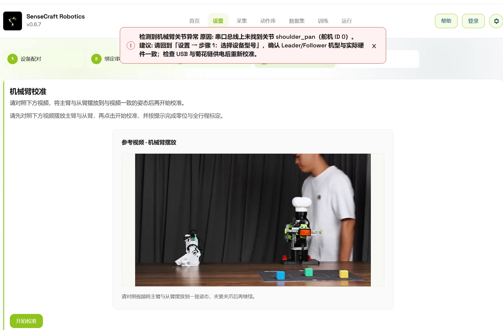

What should I do if calibration reports "robotic arm joint abnormality detected"?​
If this error appears after clicking "Start Calibration", check the leader arm first.
Check in this order:
  1. Make sure the robotic arm power supply is on and the voltage meets the device requirements.
  2. Return to "Device Pairing" and confirm that the selected device model matches the actual robotic arm.
  3. Check the "Bind Serial Port" step and confirm that the leader and follower serial ports are not reversed.
  4. Check the leader arm wiring, daisy-chain connection, and USB connection.
Robotic arm joint abnormality error example

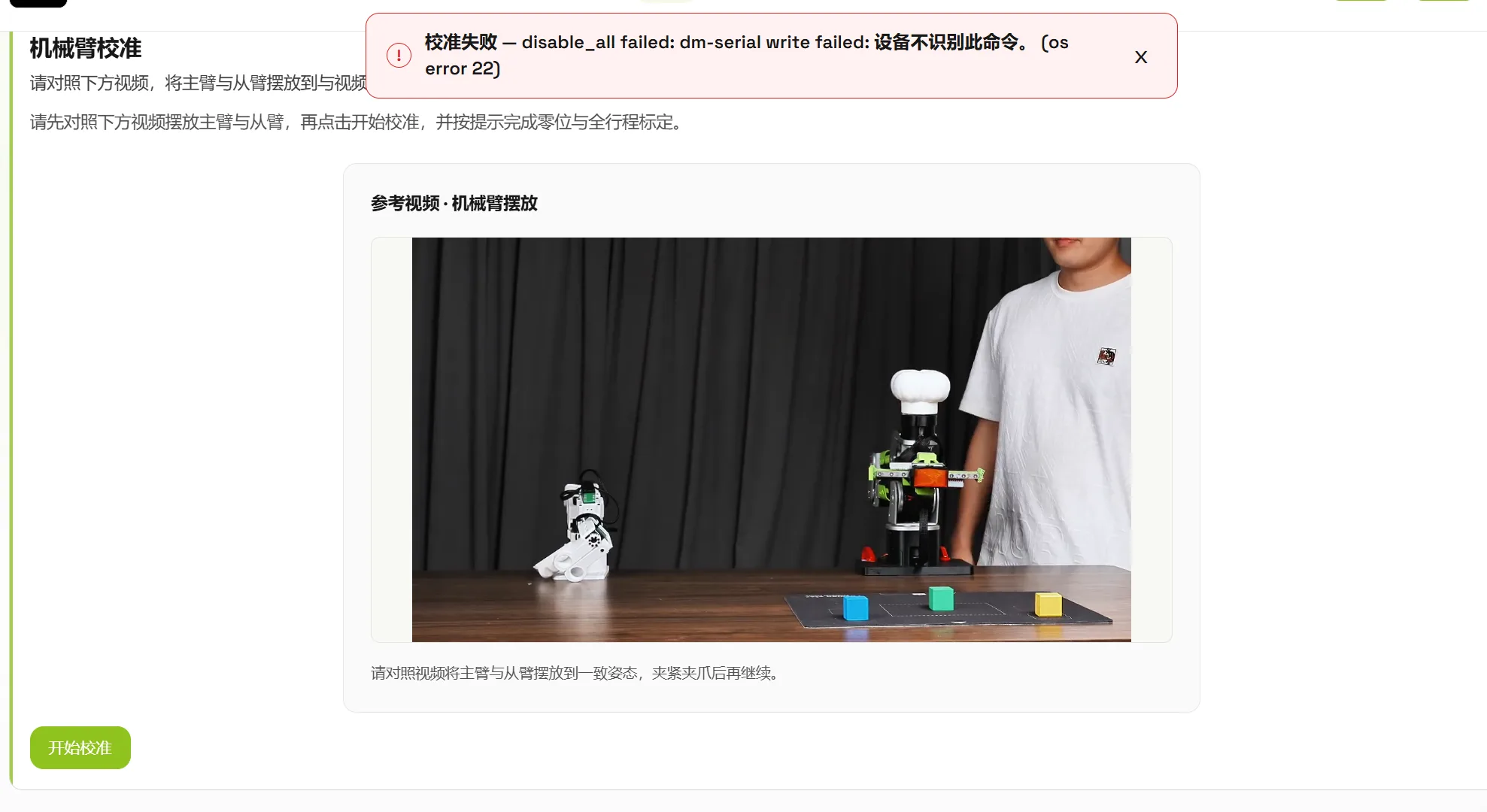

What should I do if calibration reports that the serial port is disconnected or write failed?​
If an error such as "dm-serial write failed" or serial write failure appears during calibration, the serial link is usually not connected correctly, the device is not recognized, or the serial roles are bound incorrectly.
Stop calibration first, then check the leader and follower power supplies, USB cable, serial port bindings, and device model. After the connection is restored, click "Scan Serial Ports" again and recalibrate.
Serial write failure error example

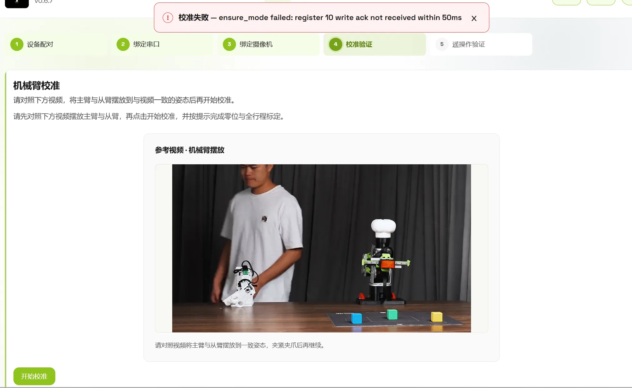

What should I do if the follower arm reports an error after leader arm calibration is complete?​
If leader arm calibration is complete but an error appears when switching to follower arm calibration, focus troubleshooting on the follower arm.
Check whether the follower arm is powered on, whether the voltage meets the standard, and whether the follower wiring, servo chain, CAN, or serial connection is normal. If needed, bind the follower port again before starting calibration.
Follower arm calibration error example

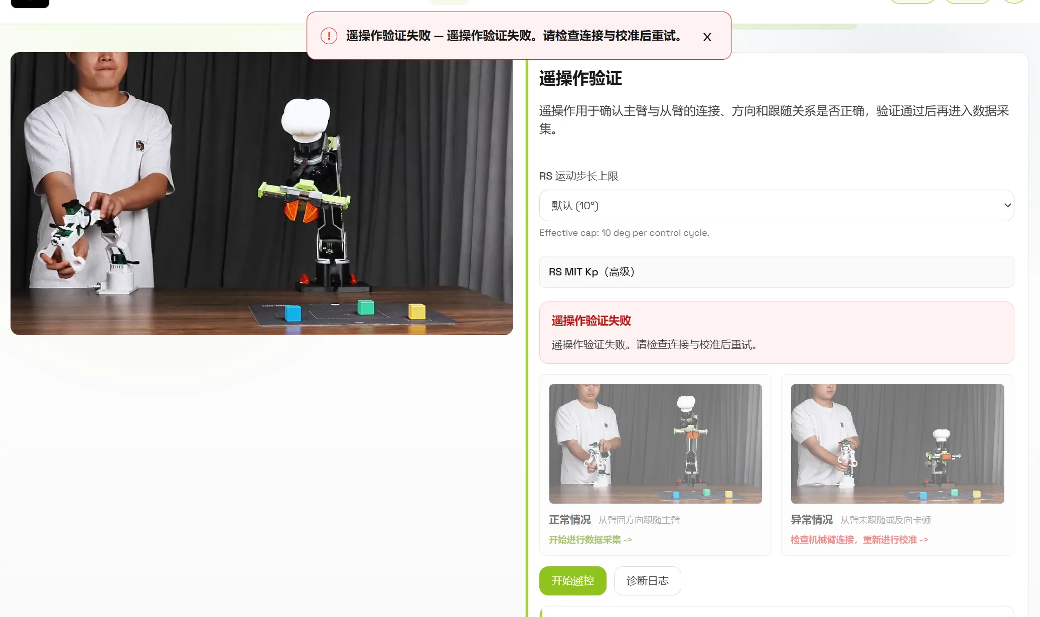

What should I do if teleoperation validation fails?​
If teleoperation validation fails, first confirm that the leader and follower arms are connected and paired correctly.
  1. Make sure power is on and the voltage meets the standard.
  2. Make sure the device selected in Device Pairing matches the actual robotic arm model.
  3. Check whether the leader and follower serial ports are reversed.
  4. Check whether the leader arm wiring is normal.
  5. Calibrate again, then perform teleoperation validation with small and slow movements.
Teleoperation validation failure example
