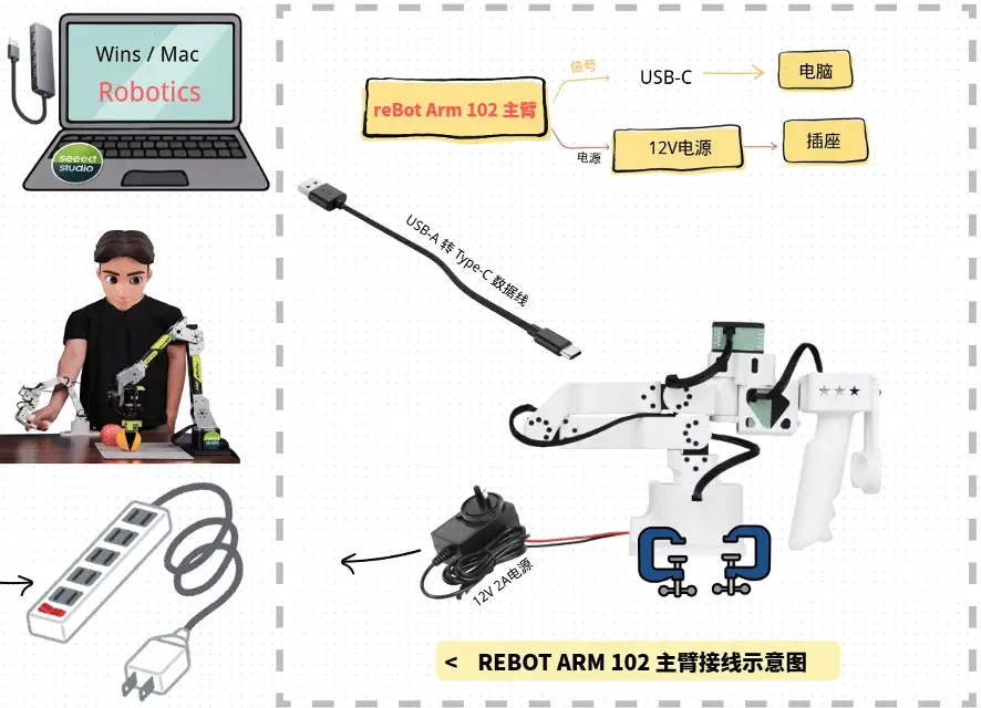

Step 2: Connect the Cables​

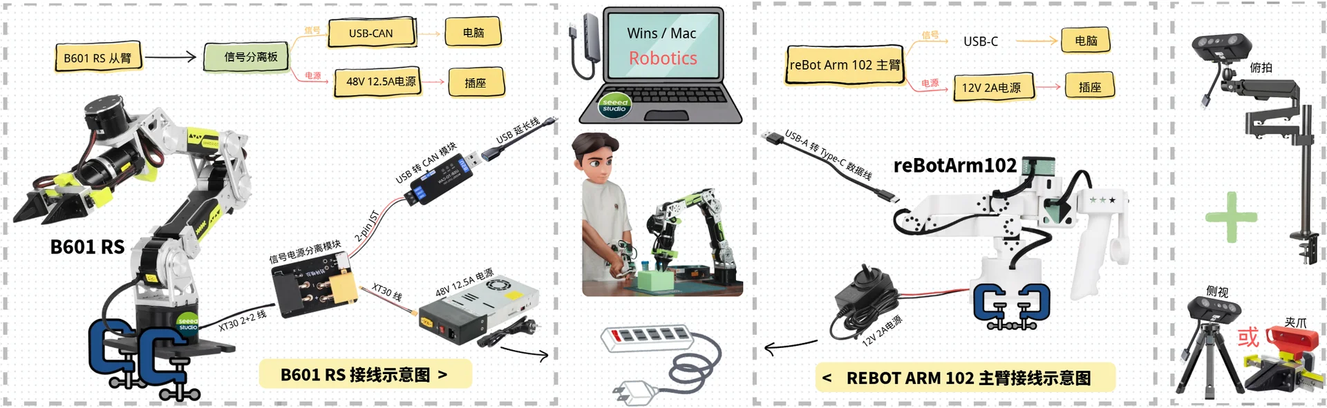

The connections consist of two paths:
  • Signal path (arm -> USB-C cable -> computer)
    1. Prepare a USB-C cable to connect the arm to the computer (do not plug it into the computer yet; connect it when you reach serial-port binding and scan for devices).
  • Power path (arm -> 12 V 2 A power supply -> power strip)
    1. Connect the 12 V 2 A power adapter to the arm's power connector.
    2. Connect the adapter to the power strip to power on the arm.
2.2 Mount and Connect the B601 RS (Follower Arm)​
B601 RS cable connection
Step 4: Mount the B601 RS​
Use G-clamps to secure the B601 RS to a flat tabletop. Gently rotate the arm left and right to confirm that the base does not move.

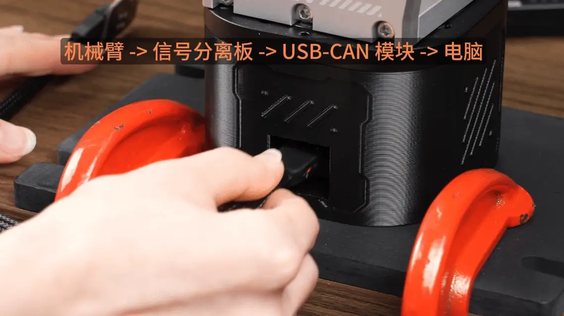

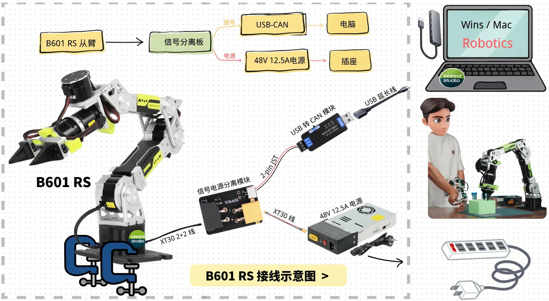

Step 5: Connect the Cables​
Make sure the power is disconnected before starting. The connections consist of two paths:
  • Signal path (arm -> signal separation board -> USB-CAN -> computer)
    1. Use an XT30 2+2 cable to connect the arm base to the signal separation module.
    2. Cut the 2-pin cable. Connect one end to the signal separation module; connect the red wire on the other end to H on the USB-CAN and the black wire to L.
    3. Connect one end of the USB-CAN to the computer through the USB extension cable (do not plug it into the computer yet; connect it when serial-port binding is ready and scan for devices).
  • Power path (arm -> signal separation board -> 48 V 12.5 A power supply -> outlet)
    2. Use the power XT30 cable to connect the signal separation module to the 48 V 12.5 A power supply.
    3. Connect the power supply to the outlet. After confirming that the arm is secured, the cables are correct, and the surrounding area is clear, turn on the power.
Connecting power to the B601 RS

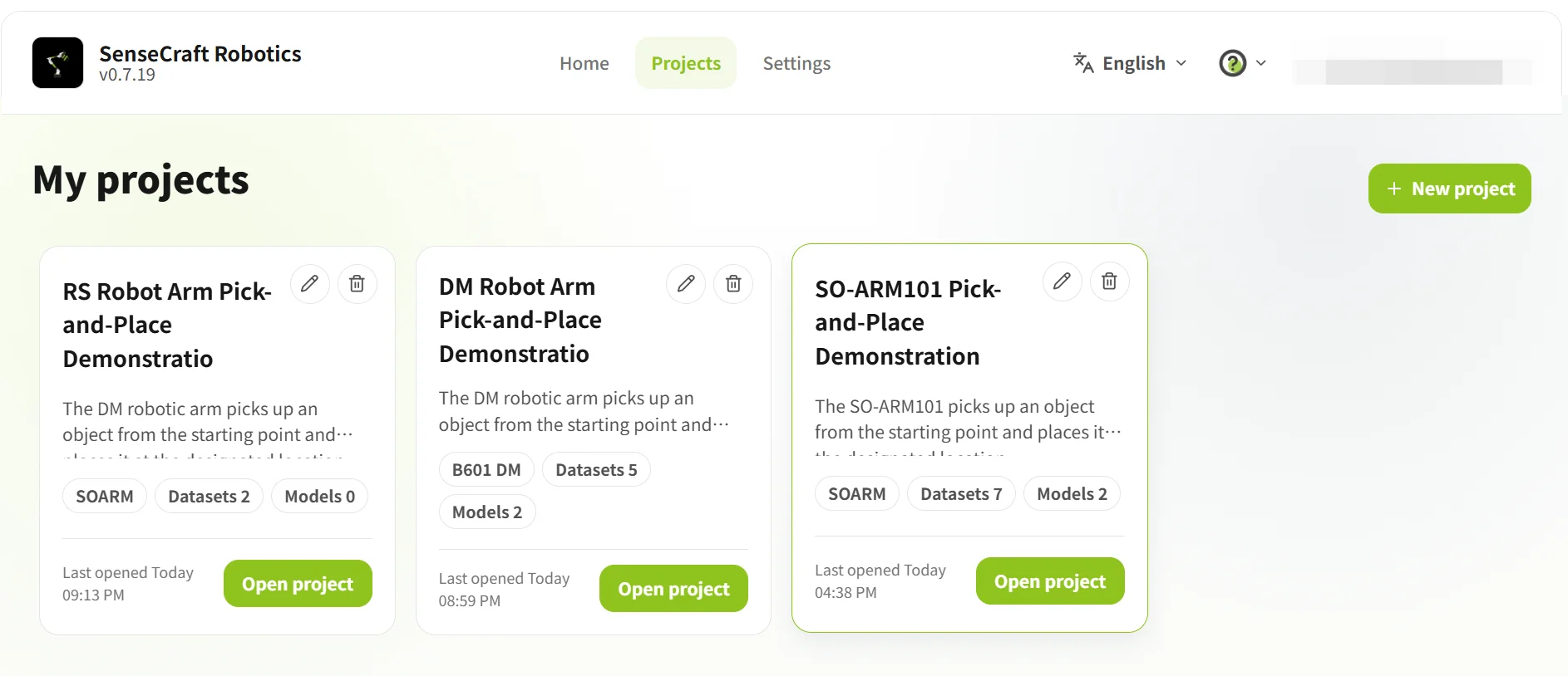

3. Project​
After signing in, open the Projects page. Create a new project for first-time use, or open an existing project. In a project, the Project Overview provides access to device setup, action replay, datasets, training, models, and operation.
OperationSteps
Create a projectClick New Project → enter the project name and description → click Create and Start
Open an existing projectSelect a project from the project list → open the project
New project window

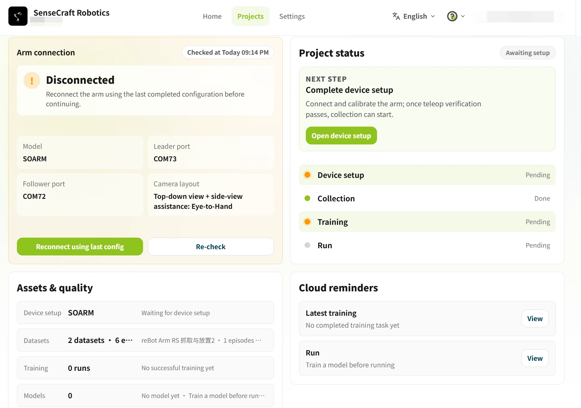

3.1 Project Overview​
Project Overview displays the current project status, including arm connection, device setup, dataset, training, model, and operation status.
If the page shows Pending configuration or Not connected, click Go to Device Setup to configure the arms.
Project overview

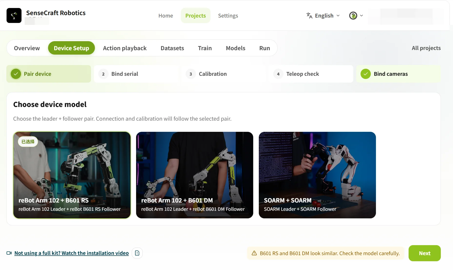

3.2.1 Select the Device Model​
In the Device Pairing step, select reBot Arm 102 + B601 RS, then click Next to bind the serial ports.
Select reBot Arm 102 + B601 RS

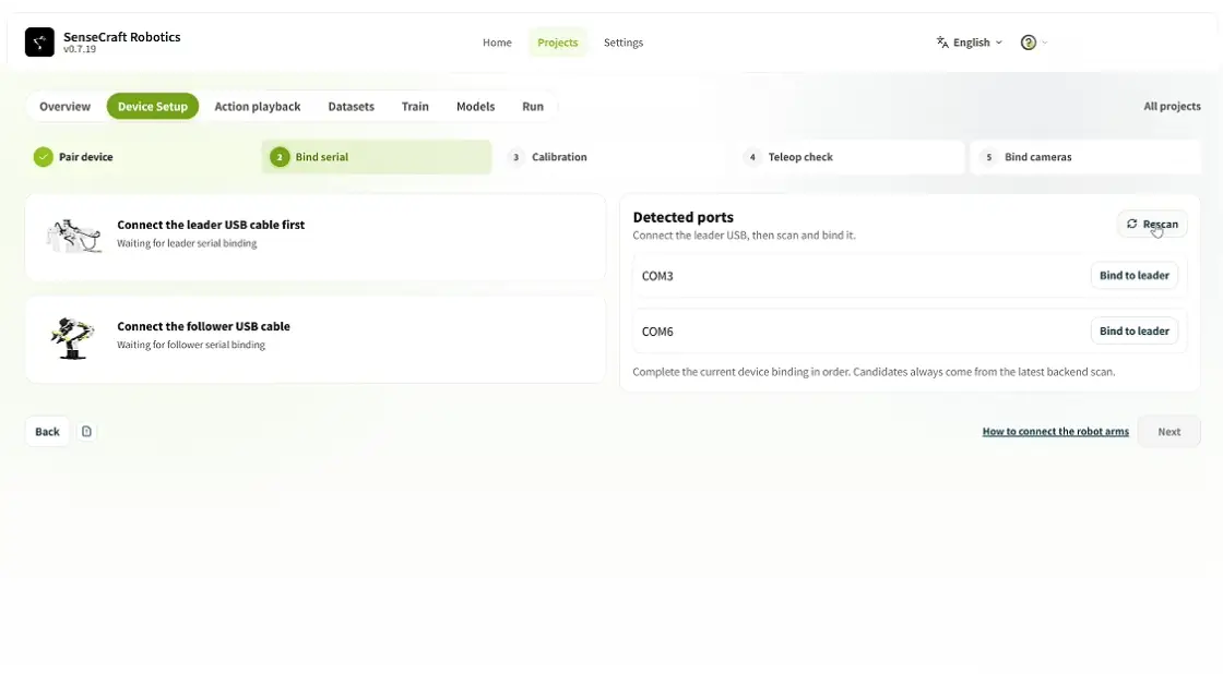

3.2.2 Bind the USB Serial Ports for the Leader and Follower Arms​
  1. Initial scan: Disconnect the USB cables from both arms, click Rescan, and record the serial ports currently displayed.
  2. Bind the leader arm: Connect the reBot Arm 102, click Rescan again, and bind the newly appearing serial port to the leader arm.
  3. Bind the follower arm: Connect the B601 RS, click Rescan again, and bind PCAN channel (can0) to the follower arm.
  4. Confirm that both arms show Connected, then click Next.
Bind the serial ports for the leader and follower arms
Serial-port binding and troubleshooting:
  • After each scan, bind only the newly appearing serial port. Do not identify devices solely by their COM numbers.
  • If a serial port is not shown, reconnect the USB cable and scan again. If only one serial port is shown, check the other USB cable and the device power.

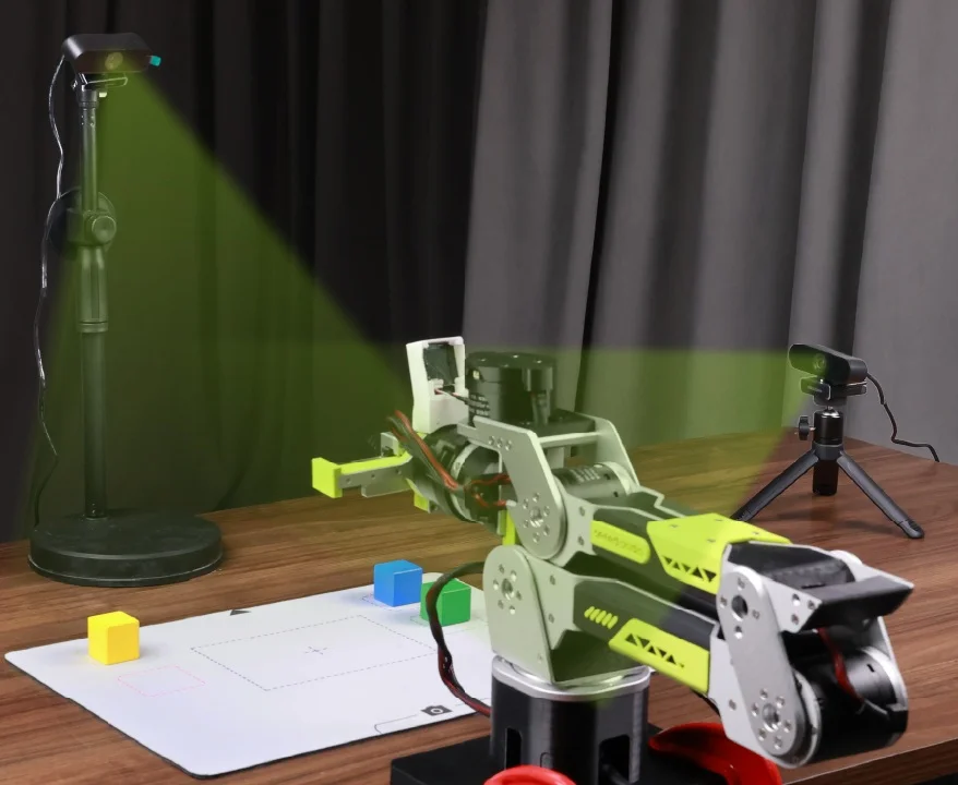

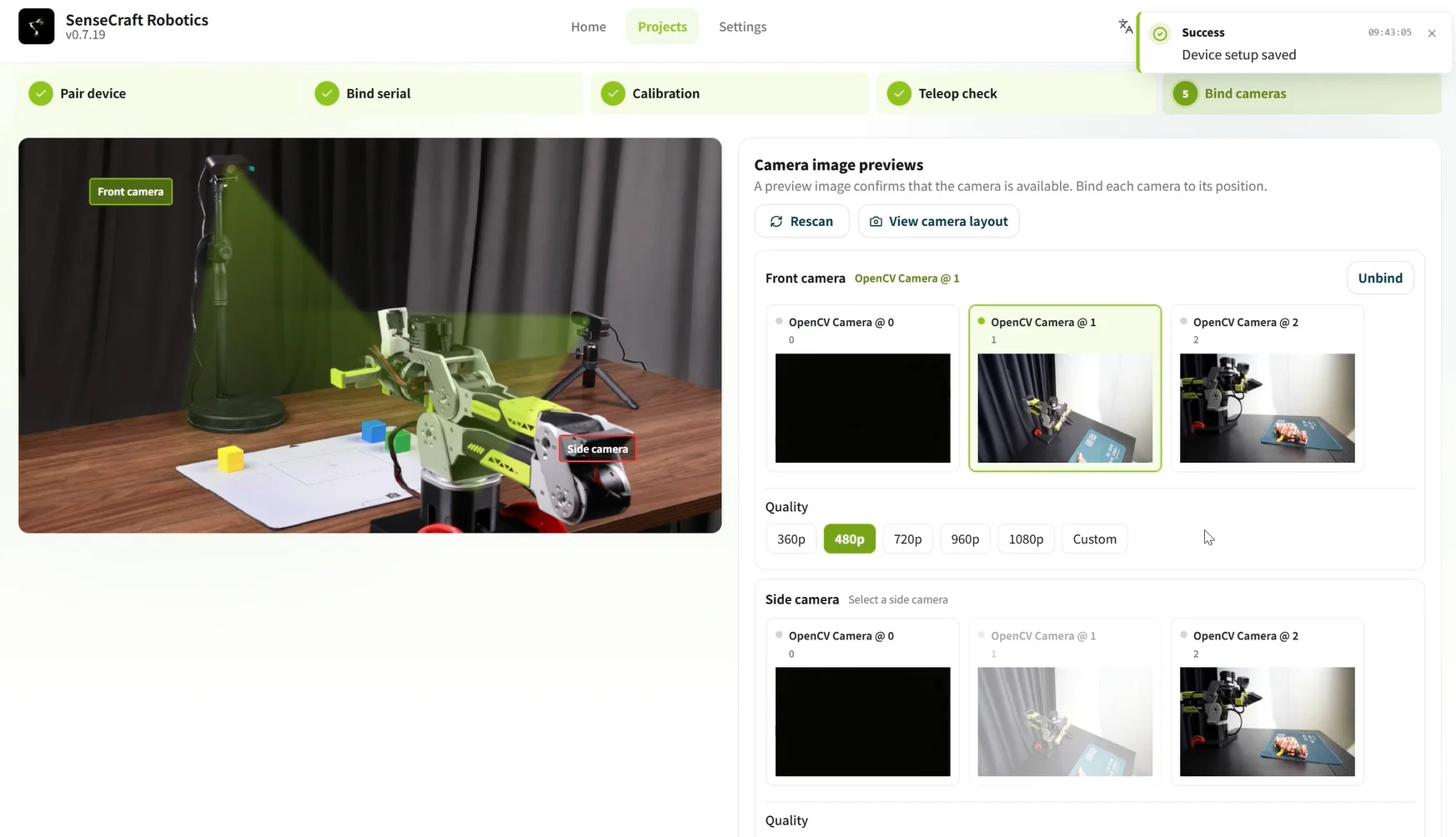

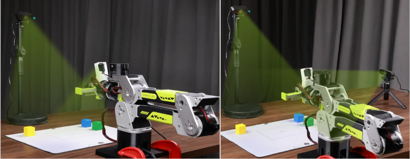

3.2.5 Bind the Cameras​
Cameras record visual information while the arm performs a task. Depending on the camera mounting position, the following two layouts are commonly used:
LayoutInstallation and purposeSuitable scenariosIllustration
Gripper view
Top-view camera: mounted above the front of the workbench to cover the work area.
Gripper camera: mounted near the gripper to observe grasping details.
Fine operations that require observing contact between the gripper and the object.Gripper-view layout
*Note: You may design your own 3D camera mount.
Side-view assistance
Side-view camera: mounted at the front side of the workbench to observe arm height and gripper motion.
Tasks such as grasping, handling, and placing.Side-view assistance layout
This tutorial uses the side-view assistance layout. After installing and positioning the cameras:
  1. Connect the cameras to the computer and click Rescan.
  2. Select the corresponding video streams in the Front Camera and Side Camera areas.
  3. Check both preview windows to confirm that the arms, object, and target position are clearly visible. Click Next after confirming.
Bind the front and side cameras
To check whether the cameras correspond to their mounting positions, click View Camera Layout. If the preview is black or abnormal, rescan, restart the cameras, or change the USB ports.

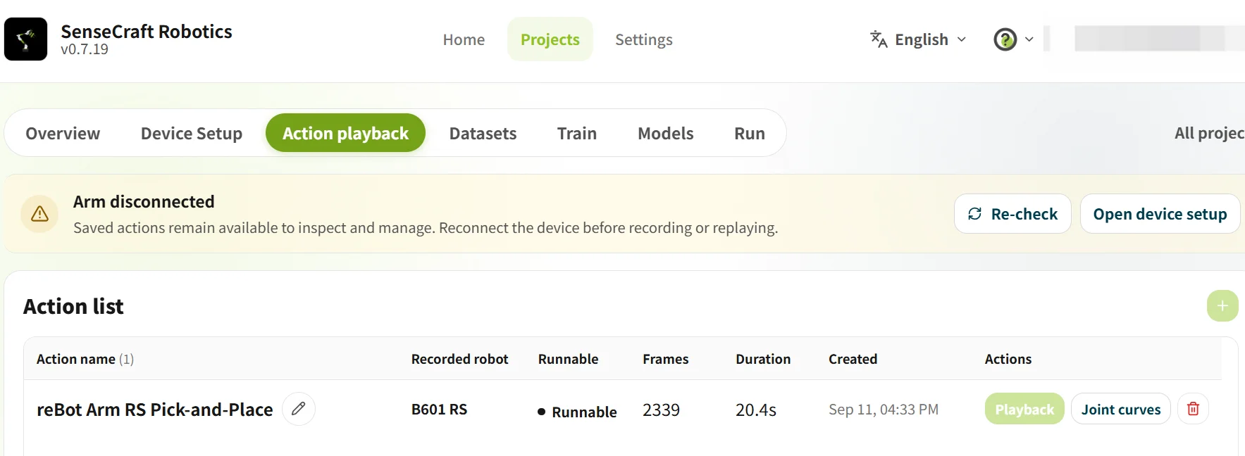

3.3 Action Replay​
Action Replay records arm actions through leader-arm teaching and saves them in the action list for replay. After recording, check whether the action is continuous and whether the movement direction and gripper opening and closing are correct.
FunctionOperationPurpose
Record an actionClick + to create an action → use the leader arm to control the follower through the task
Click Stop Recording → save
Record target actions such as grasping, moving, and placing
Replay an actionClick ReplayCheck that the action is complete and continuous, and confirm the movement direction and gripper opening and closing
Before recording an action for the first time, complete device connection and teleoperation verification in Device Setup, and click Confirm Teleoperation Normal. If replay is abnormal, delete the action and record it again.
Action list and replay operation

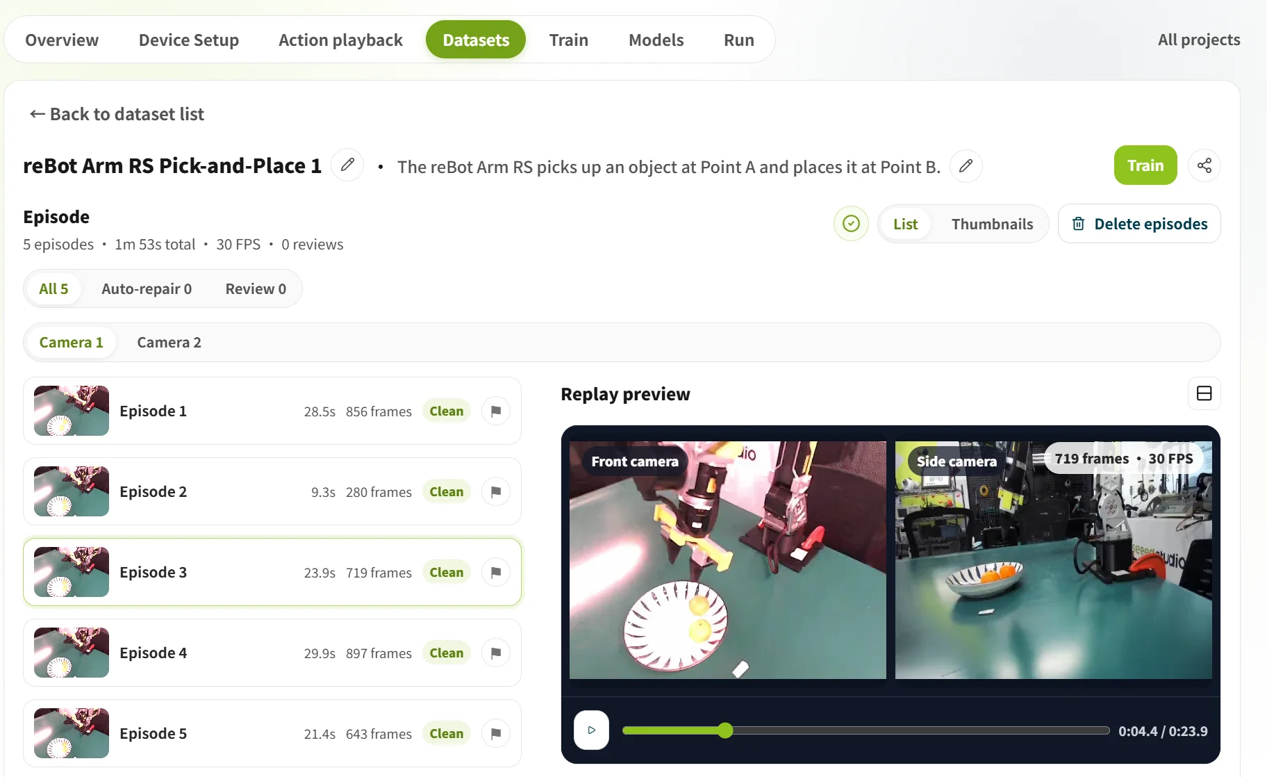

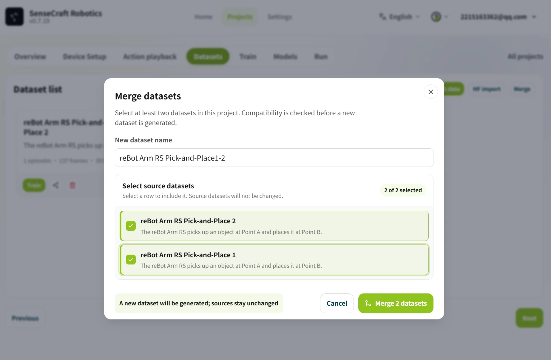

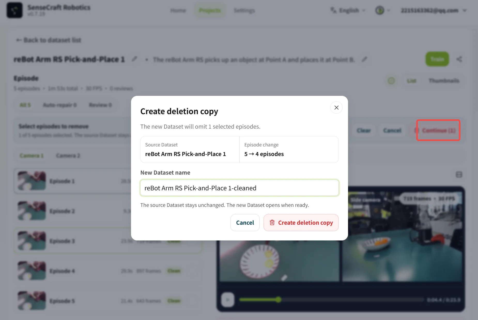

3.4 Dataset​
Dataset is used to create collection tasks and to record, inspect, clean, and merge task episodes. We recommend collecting data in small batches to detect disconnections, software problems, or video stuttering early and reduce the risk of losing all data because of a single failure.
  • Record about 10 task episodes per batch;
  • After completing 2–3 batches, keep about 20–30 valid episodes for the first training run;
  • Add more data for complex tasks according to the training results.

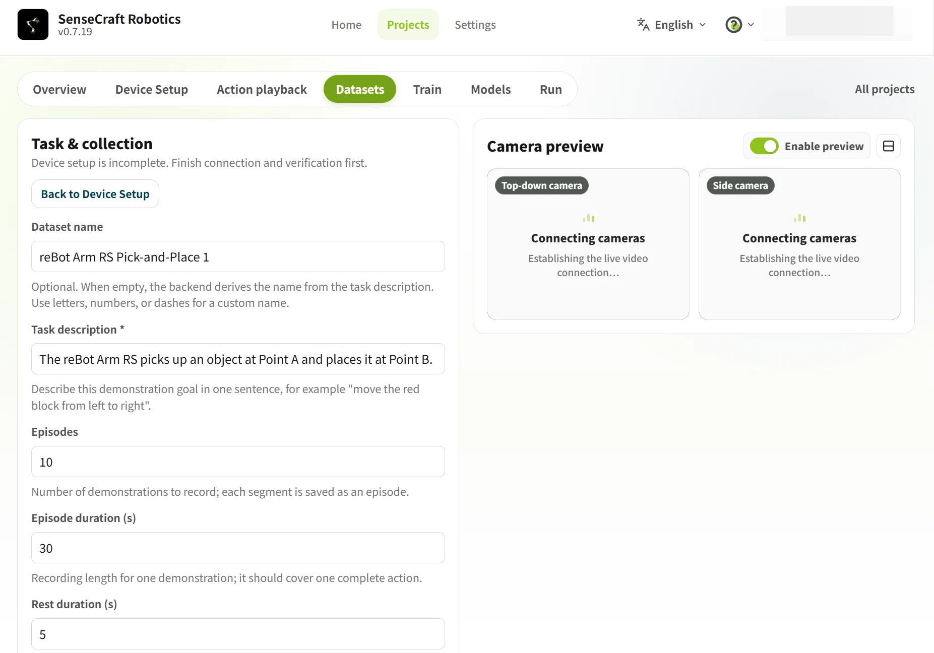

3.4.1 Configure a Data Collection Task​
Go to Dataset → Collect Data and enter the task information. If multiple datasets will be merged, the task descriptions for all batches must be exactly the same. Before collection, keep the A and B positions, object category, camera positions, tabletop background, and lighting conditions as consistent as possible.
FieldExample valueInstructions
Dataset nameRS arm pick object from A to B-01Use the format “device + task + batch”
Task descriptionMove the object from the left to the rightState the task goal clearly; descriptions must be exactly the same when batches are merged
Number of episodes10Each episode should contain one complete task
Duration per episode20–30 secondsCover the complete action sequence
Rest duration5 secondsAllow the arm to reset and the scene to be adjusted
Configure a data collection task

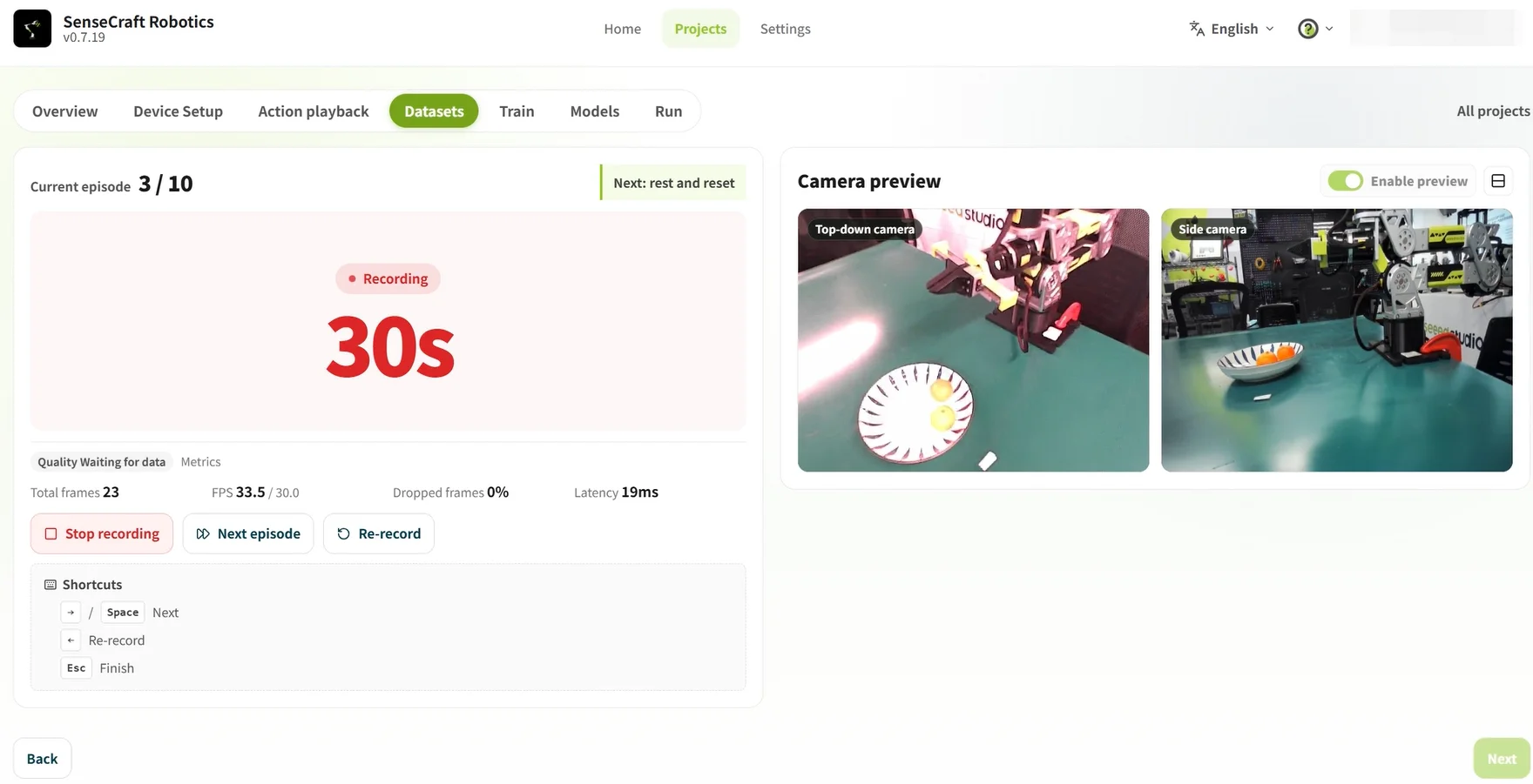

3.4.2 Record Task Episodes​
Recording task episodes is the core of the training data. Each episode should fully record the process of grasping the object at Point A, moving it to Point B, and releasing it. To help the model learn quickly, keep the task procedure generally consistent. To improve generalization, add data with different positions, angles, and motion variations.
  1. Place the object at Point A, confirm that the arm is in its initial posture, and click Start Recording.
  2. Use the leader arm to control the follower through the task, then return the arm to its initial posture.
  3. After the task is complete, wait for the remaining time to end or click the arrow (or press Space) to end the current episode early.
  4. During the rest period, return the object to Point A and make sure the arm is ready. Start the next episode when the rest period ends.
Record task episodes
Important reminder ⚠️
  • Before collection, adjust and secure the cameras. Make sure the arms, gripper, object, and Points A and B are all visible.
  • Key actions must not be 🚫 obstructed or outside the camera view, or the data may not be usable for training.
  • If a task fails, the object is not securely grasped, the video stutters, or a camera is obstructed, click Record Again or press Esc to stop collection.
  • You can complete the current batch first, then inspect and delete abnormal episodes.
  • If the arm behaves unexpectedly or there is a collision risk, stop 🛑 immediately.
3.4.3 Inspect, Delete, and Merge Data​
After collection, inspect abnormal episodes, delete invalid data, and merge multiple datasets when needed.
OperationMethodDescription
Inspect abnormal episodesSelect an episode and play the video or replay the actionConfirm that the task is complete and the gripper action is normal. You can note abnormal episode numbers during recording and inspect them directly later
Delete abnormal episodesClick Batch Delete Episodes, select the abnormal episodes, and confirm; then click Generate Deleted CopyEnter a new dataset name and confirm. The original dataset will not be overwritten
Merge datasetsClick Merge, select the datasets, and enter a new dataset nameMerge datasets with matching task descriptions, device combinations, and camera configurations
Inspect the dataset
Inspect the dataset
Merge datasets
Merge datasets

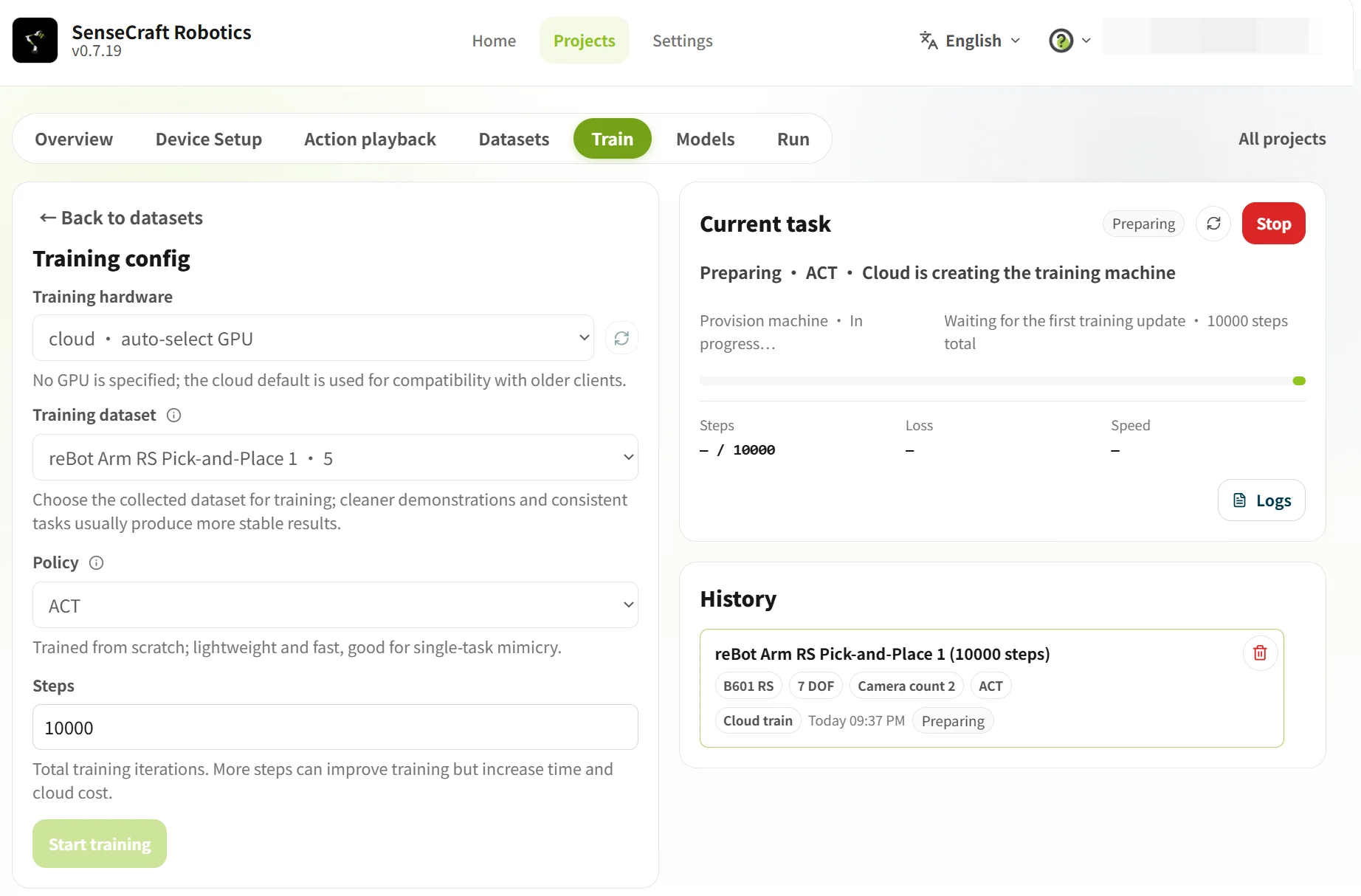

3.5 Training​
Training generates an action model for the arm (that is, an action-control program created from the teaching data). SenseCraft Robotics reads the recorded task data, analyzes how the arm performs the target action, and generates a model that can be used for autonomous operation.
Use the following table to configure the training parameters:
ParameterOption / valueDetails
Training hardwareCloud · automatically select GPUUses a cloud server for training and consumes the corresponding credits.
Local · freeUses the current computer for training. No credits are consumed, but a compatible local GPU is required.
Training datasetSelect the target datasetSelect the dataset you recorded and prepared for this training run.
PolicyACTThe currently supported default action-control policy.
Training steps1000010,000 is recommended as the initial value. Adjust it later according to the model's actual performance.
Credits notice Cloud training with Cloud · automatically select GPU consumes credits. Local · free training does not consume cloud-training credits. Refer to Credit Rules for information about obtaining and using credits.
Recommended training steps and episode counts:
Task difficultyTask descriptionRecommended episodesRecommended training steps
BeginnerFixed Point A to Point BAbout 2010,000–15,000 steps
IntermediateGrasp and place at random positionsAbout 5030,000–40,000 steps
AdvancedMultiple steps or long durationAbout 10080,000–100,000 steps
Training duration: Total training time depends on both the selected GPU model and the number of training steps. For example, training for 20,000 steps (20K) in the cloud typically takes anywhere from several minutes to dozens of minutes on most GPUs. Training for 100,000 steps (100K) takes approximately five times as long as training for 20K steps.
After confirming the settings, click Start Training. Once training starts, view the progress and training history in the Current Training Tasks list.
Training configuration

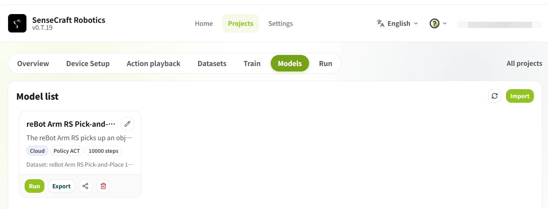

3.6 Model​
Model is used to view training results and select a model for subsequent operation. Before use, confirm that training is complete and that the task and device combination match the current project.
Model list

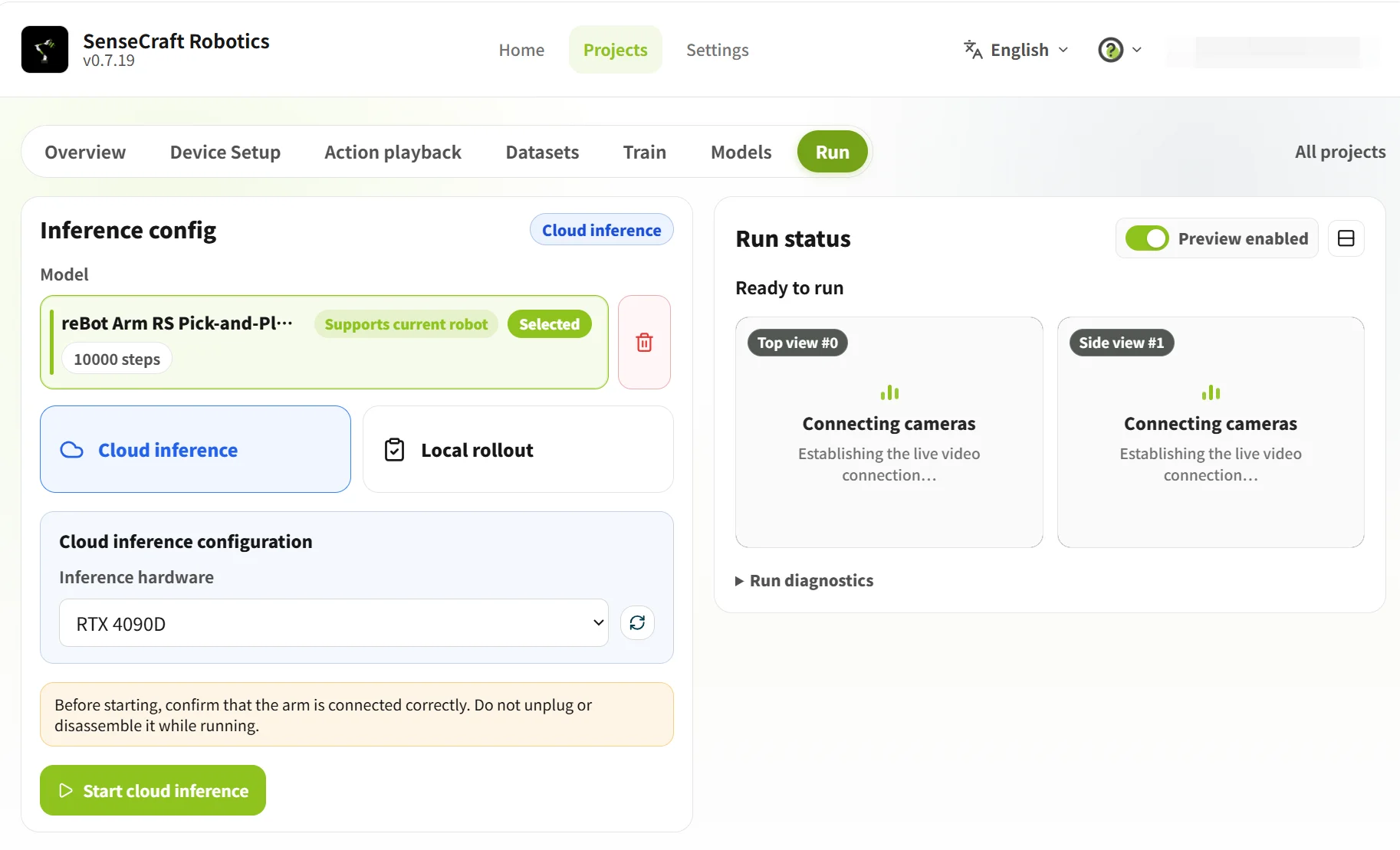

3.7 Operation​
Operation loads a trained model onto the arms to verify whether it can complete the task correctly.
Steps:
  1. Select a model: Select a model labeled Supports current arm.
  2. Select an inference method: Select Cloud Inference or Local Inference, then configure the corresponding parameters.
  3. Start inference: After confirming the settings, click Start Cloud/Local Inference.
Key differences between cloud inference and local inference:
ComparisonCloud inferenceLocal inference
Computing hardwareUses a high-performance cloud GPU for inference.Uses the computer's local CPU (the current platform does not support using a local GPU).
Performance impactComputing power is generally not a limitation, but results depend heavily on network transmission quality.Results depend on the local CPU's computing power.
ParametersAction chunks (default 120): number of action steps predicted in one inference.
Chunk threshold (default 0.9): affects motion smoothness and accuracy. A higher value makes the arm more cautious and may cause pauses; a lower value makes motion smoother but may increase errors.
(Defaults are usually recommended.)
Run count: total number of times (episodes) to repeat the task.
Time limit per run (seconds): maximum duration of one task run; the run ends automatically when it times out.
Data outputOnly performs inference verification.Automatically generates a corresponding dataset from the inference runs after operation ends.
Cost and limitationsSubject to platform pricing; the stronger computing power is suitable for getting started quickly.Usually does not consume cloud credits, but is limited by local CPU performance.
Notes
  • Before starting: Confirm that the arms are connected correctly and that the workspace is safe.
  • During operation: Do not disconnect or disassemble the arms, and observe whether their movements are normal.
  • If the result is unsatisfactory: Return to Dataset, delete abnormal episodes, add valid data, and train again.
Model operation interface
