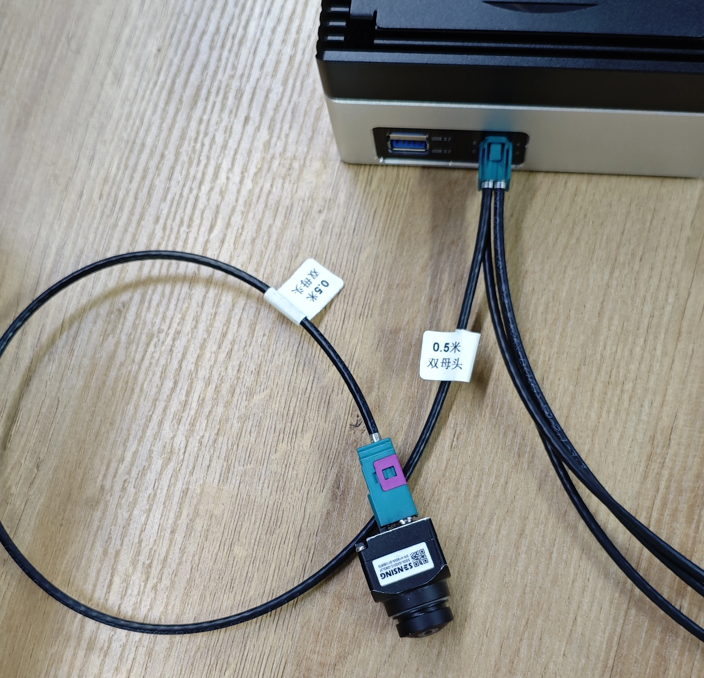

Connect the Mini Fakra cable with camera, there were 4 channels on reComputer Robotics J30/J40, we used the SG3S-ISX031C-GMSL2-F camera and it's connected to the '1' channel (silk screen letter 'B').

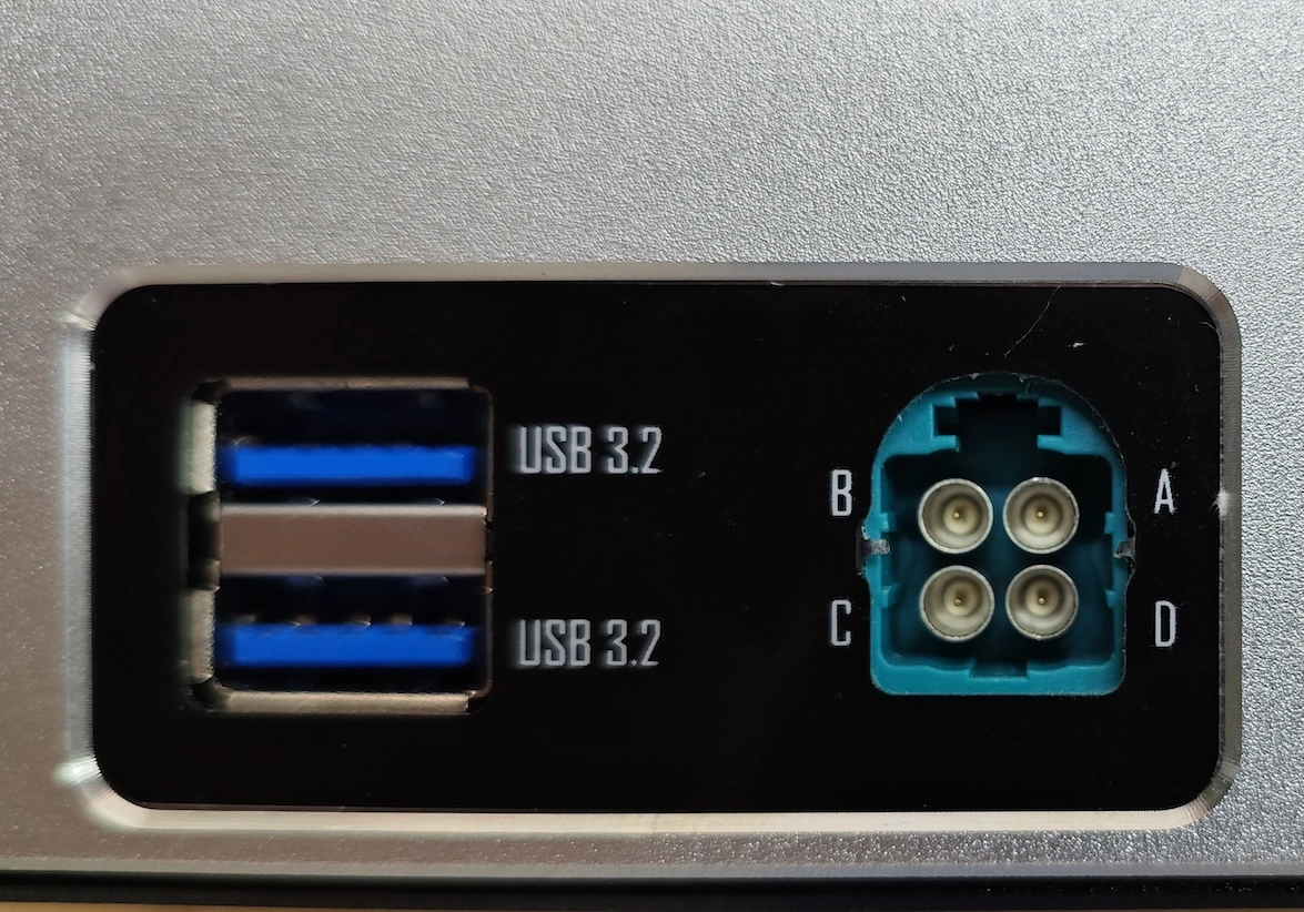

Before you begin, let's get familiar with the 4 channels since we'll use it during our configurations later.
Preview
These 4 channels are labelled as 'A', 'B', 'C' and 'D' on device, we recommend our customer to connect the camera with given alphabet order, in which case your video devices will be mapped as '/dev/video0', '/dev/video1', '/dev/video2', '/dev/video3' on your Jetson Linux correspondingly.
But if you have only one camera connected, only 'video0' will be displayed.

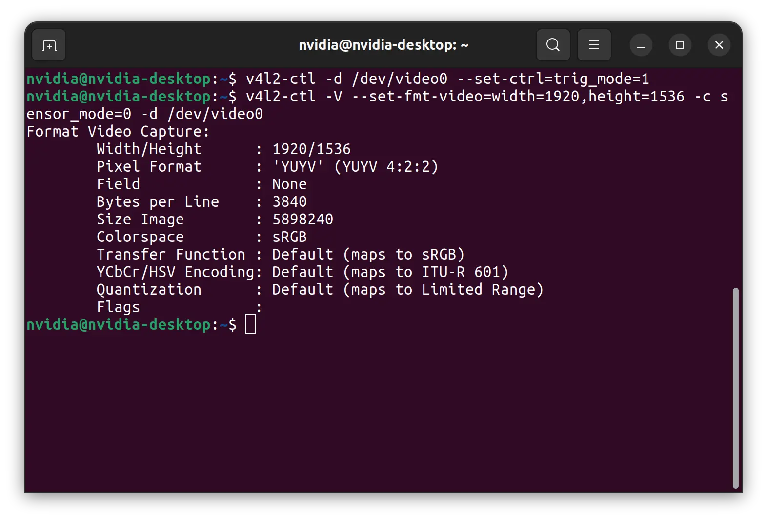

  • Frame Synchronization
v4l2-ctl -d /dev/video0 --set-ctrl=trig_mode=1
You can toggle 'trig_mode=0' to disable frame synchronization. Or use 'trig_mode=1' to enable frame synchronization when you have multiple cameras connected.
  • Video Format
v4l2-ctl -V --set-fmt-video=width=1920,height=1536 -c sensor_mode=0  -d /dev/video0
Depend on which camera you are using, there might be different 'sensor_mode' as pre-defined here, mainly:
Sensor ModeFrame Type
0YUYV8_1X16/1920x1536
1YUYV8_1X16/1920x1080
2YUYV8_1X16/3840x2160
Preview
