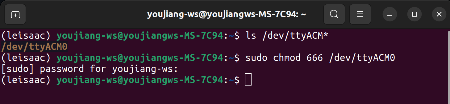

Connect the SO-ARM101 leader to an Ubuntu computer via USB cable, then use commands to grant serial port permissions.
ls /dev/ttyACM*
sudo chmod 666 /dev/ttyACM0
If everything works properly, you should see similar log output.

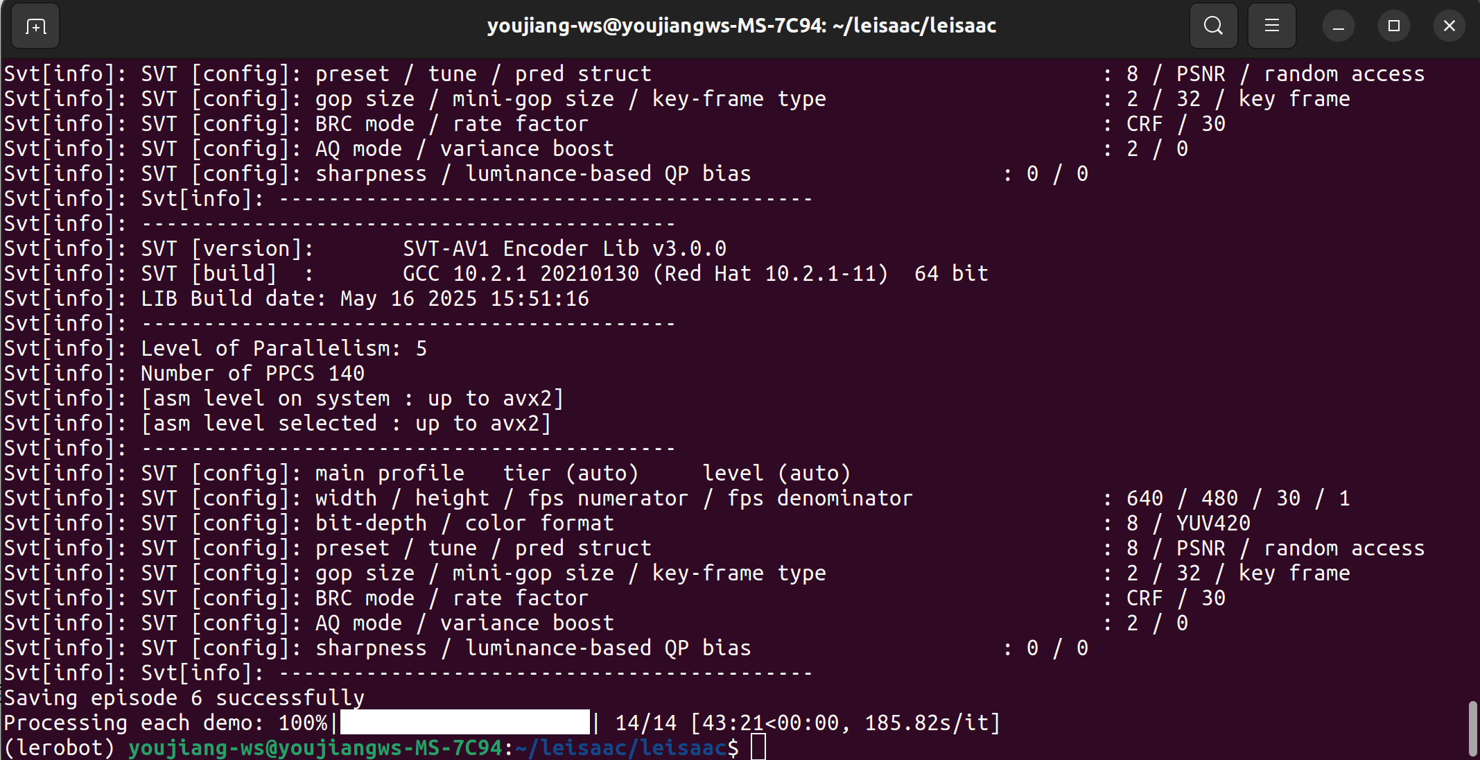

Data Conversion
Collected teleoperation data is stored in HDF5 format in the specified directory. If using this data to train a proxy model, the dataset must be converted to LeRobot-compatible format using LeIsaac's conversion scripts.
This script must be executed within the LeRobot virtual environment. Please create a new LeRobot environment by following the steps in this wiki.
cd ..
git clone https://github.com/huggingface/lerobot.git
cd lerobot
conda create -y -n lerobot python=3.10
conda activate lerobot
pip install -e .
Then, we can modify the parameters in the script and run the following command:
cd ../leisaac
python scripts/convert/isaaclab2lerobot.py
If you modified the dataset storage path during data collection, you must update the corresponding path in the conversion script prior to execution.
After the program completes execution, the converted dataset can be found at: ~/.cache/huggingface/lerobot/

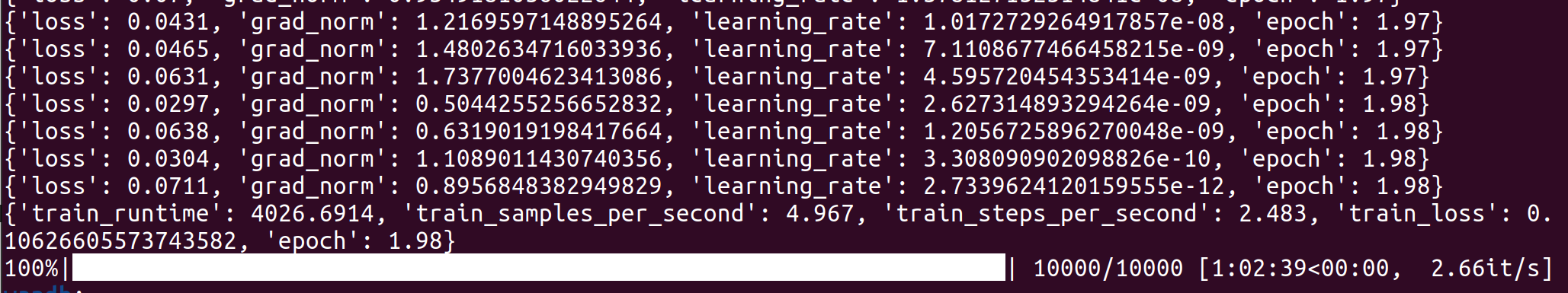

Run the following command in terminal to launch training:
cd <path-to-Isaac-GR00T>
cp ./getting_started/examples/so100_dualcam__modality.json ~/.cache/huggingface/lerobot/EverNorif/so101_test_orange_pick/meta/modality.json
python scripts/gr00t_finetune.py \
--dataset-path ~/.cache/huggingface/lerobot/EverNorif/so101_test_orange_pick \
--num-gpus 1 \
--output-dir ./so101-checkpoints \
--max-steps 10000 \
--data-config so100_dualcam \
--video-backend torchvision_av \
--batch_size 2

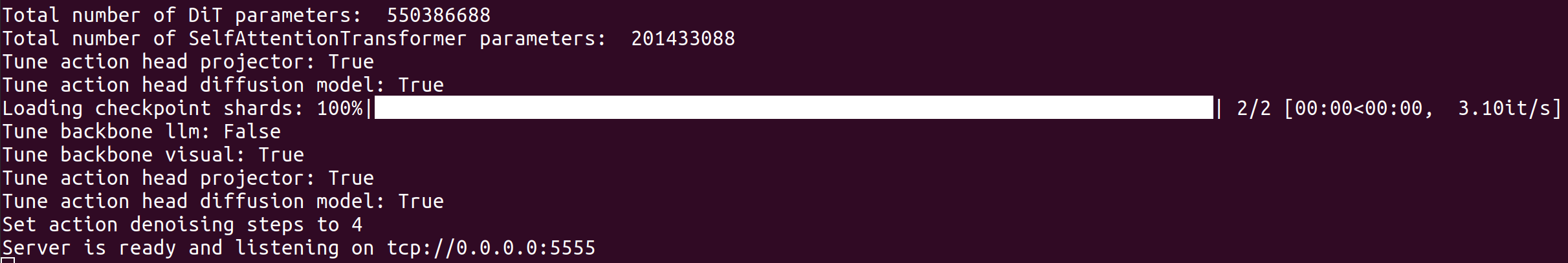

Server Open a new terminal window and run:
conda activate gr00t
python scripts/inference_service.py --server --model_path ./so101-orange-checkpoints/checkpoint-10000 --embodiment_tag new_embodiment --data_config so100_dualcam --port 5555
