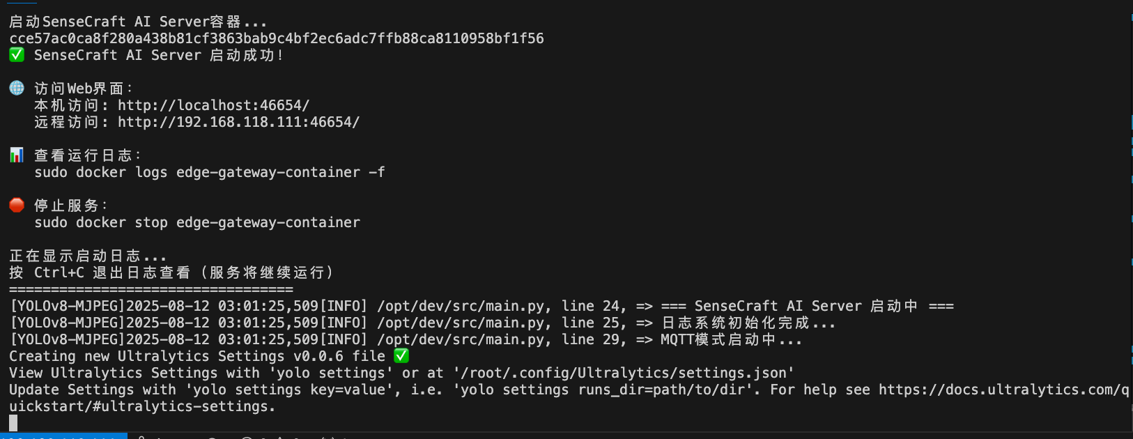

📷 Command Line Output (Example)​
Command

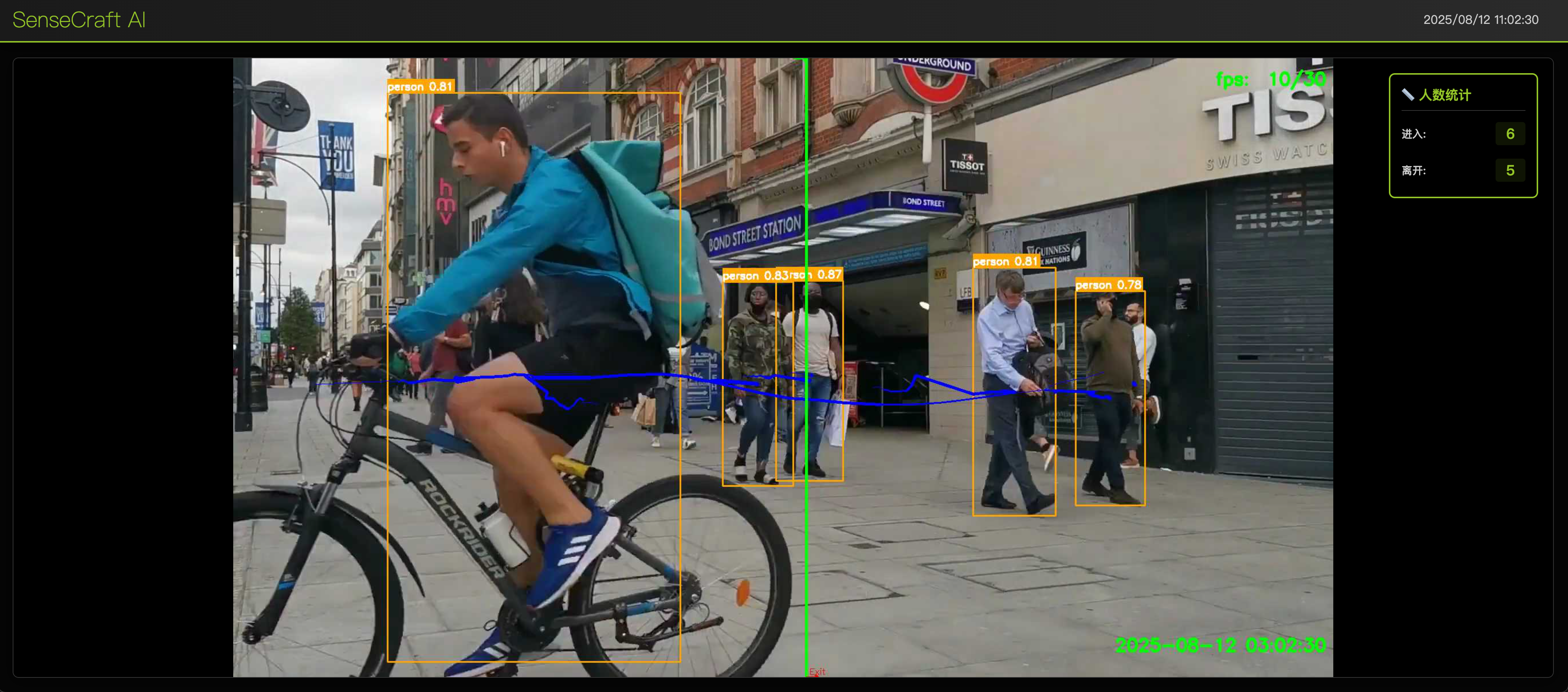

  1. Access the main page
    • In your browser:
      http://<JETSON_IP>:46654
    • Default parameters are preconfigured; start to see results
📷 Web Interface (Example)​
  1. Access the configuration page
    • In your browser:
      http://<JETSON_IP>:46654/config.html
    • Here you can adjust video sources, models, inference parameters, etc., and save them to the server
