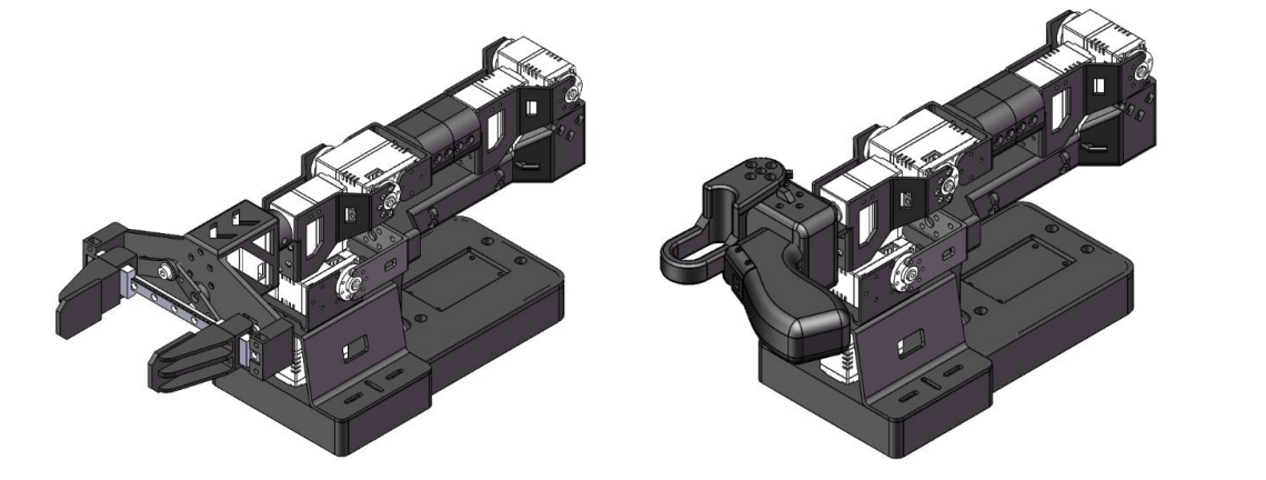

  • Ready to Go -- No Assembly Required. Just Unbox and Dive into the World of AI.
  • 6+1 Degrees of Freedom and a 470mm Reach -- Built for Versatility and Precision.
  • Powered by Dual Brushless Bus Servos -- Smooth, Silent, and Strong with up to 300g Payload.
  • Parallel Gripper with 66mm Maximum Opening -- Modular Fingertips for Quick-Replace Flexibility.
  • Exclusive Hover Lock Technology -- Instantly Freeze Leader Arm at Any Position with a Single Press.

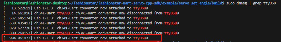

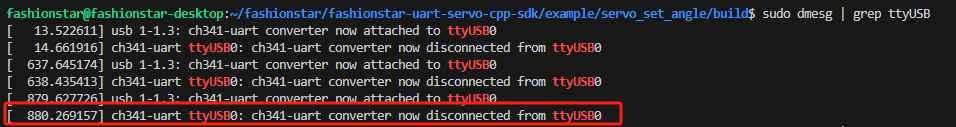

If the ttyUSB0 serial port cannot be identified, try the following solutions:
List all USB ports.
lsusb
Once identified, check the information of the ttyusb.
sudo dmesg | grep ttyUSB
The last line indicates a disconnection because brltty is occupying the USB. Removing brltty will resolve the issue.
sudo apt remove brltty
Finally,use chmod command.
sudo chmod 666 /dev/ttyUSB0

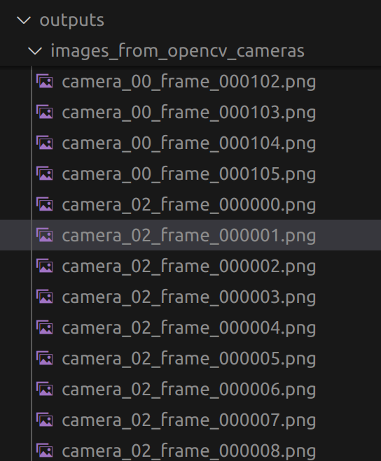

After inserting your two USB cameras, run the following script to check the port numbers of the cameras. It is important to remember that the camera must not be connected to a USB Hub; instead, it should be plugged directly into the device. The slower speed of a USB Hub may result in the inability to read image data.
python lerobot/common/robot_devices/cameras/opencv.py \
--images-dir outputs/images_from_opencv_cameras
The terminal will print out the following information. For example, the laptop camera is index 0, and the USB camera is index 2.
Mac or X86 Ubuntu detected. Finding available camera indices through scanning all indices from 0 to 60
Camera found at index 0
Camera found at index 2
Connecting cameras
OpenCVCamera(0, fps=30.0, width=640, height=480, color_mode=rgb)
OpenCVCamera(2, fps=30.0, width=640, height=480, color_mode=rgb)
Saving images to outputs/images_from_opencv_cameras
Frame: 0000 Latency (ms): 39.52
Frame: 0046 Latency (ms): 40.07
Images have been saved to outputs/images_from_opencv_cameras
You can find the pictures taken by each camera in the outputs/images_from_opencv_cameras directory, and confirm the port index information corresponding to the cameras at different positions. Then complete the alignment of the camera parameters in the lerobot/lerobot/common/robot_devices/robots/configs.py file.

  • If you encounter the following error, you need to check whether the robotic arm connected to the corresponding port is powered on and whether the bus servos have any loose or disconnected cables.
    ConnectionError: Read failed due to comunication eror on port /dev/ttyACM0 for group key Present_Position_Shoulder_pan_Shoulder_lift_elbow_flex_wrist_flex_wrist_roll_griper: [TxRxResult] There is no status packet!

  • During data collection, ensure that the camera's position, angle, and environmental lighting remain stable, and minimize capturing excessive unstable backgrounds and pedestrians; otherwise, significant environmental changes during deployment may cause the robotic arm to fail to grasp properly.
  • Ensure that the num-episodes parameter in the data collection command is set to collect sufficient data, and do not manually pause midway. This is because the mean and variance of the data are calculated only after data collection is complete, which is necessary for training.
  • If the program prompts that it cannot read the USB camera image data, please ensure that the USB camera is not connected to a hub. The USB camera must be directly connected to the device to ensure a fast image transmission rate.
