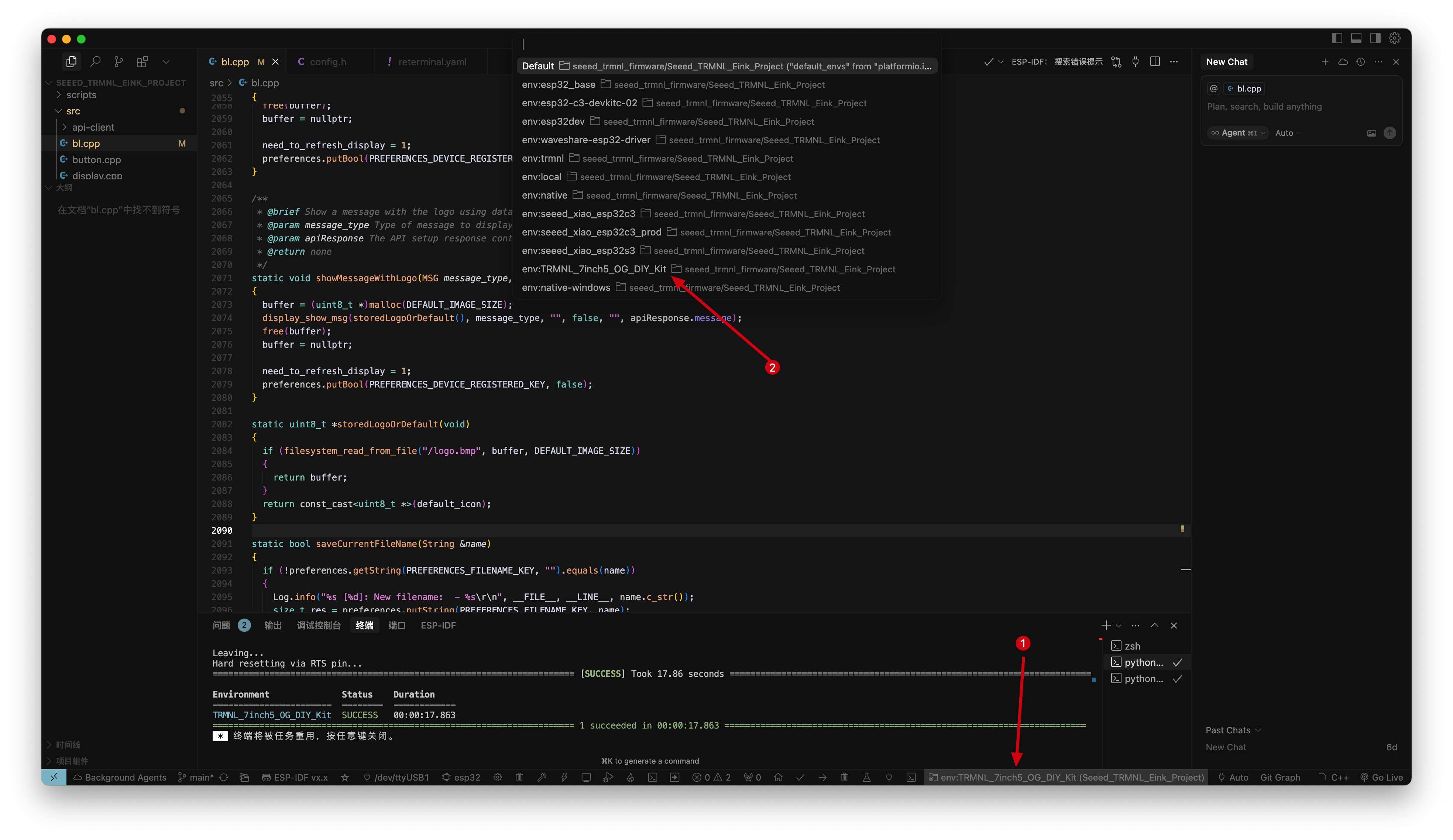

Select the Correct Environment
- In
platformio.ini
, select theTRMNL_7inch5_OG_DIY_Kit
environment.
