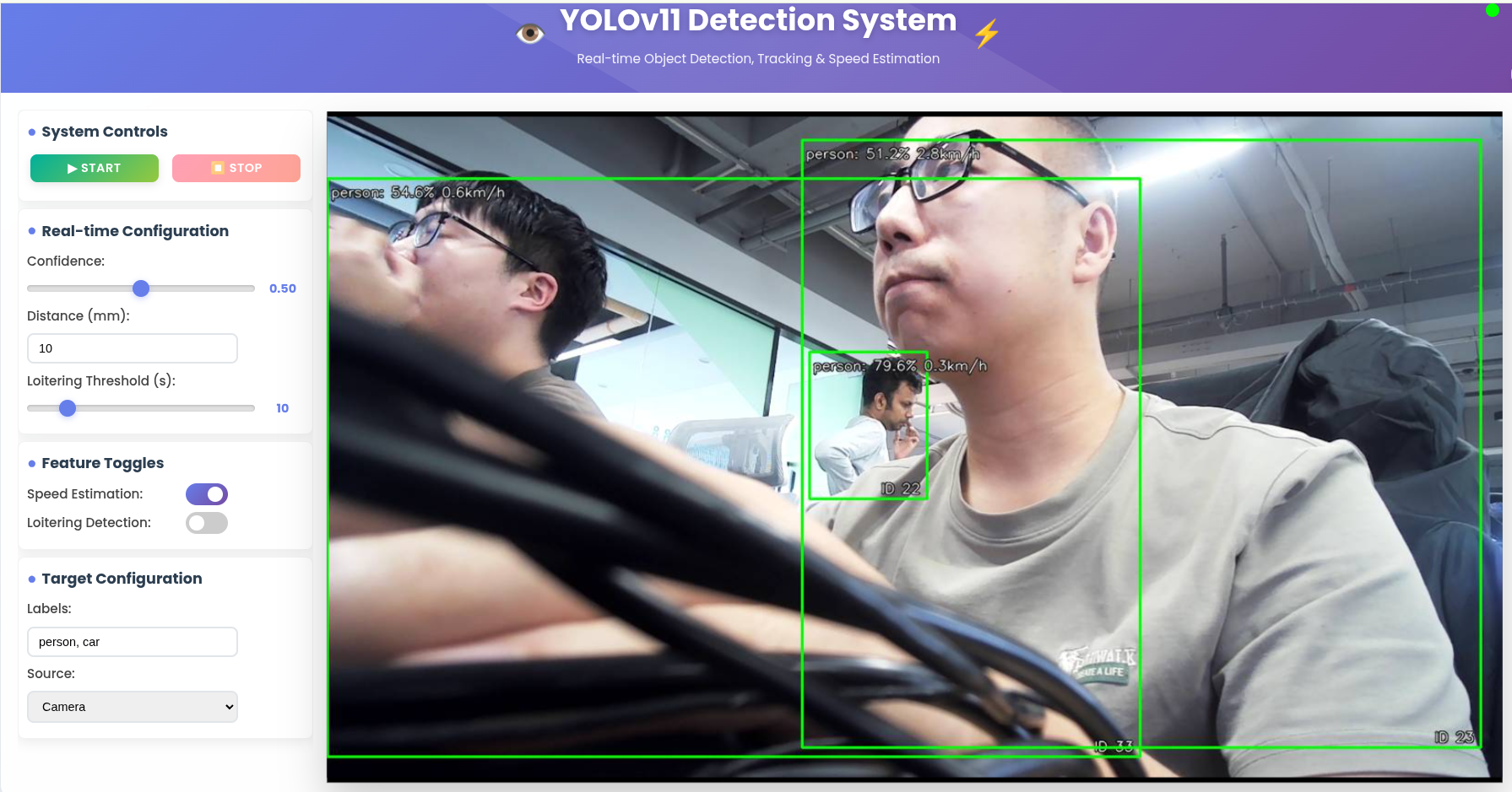

Run Project
Install Project
cd ~ && git clone https://github.com/Seeed-Projects/YOLOv11-Hailo-Tracker.git
cd YOLOv11-Hailo-Tracker
Prepare the environment
python -m venv .env --system-site-packages
source .env/bin/activate
pip install -r requirements.txt
Run the project
Access localhost:5000 to reach the frontend and configure settings.
 python run_api.py
pir
