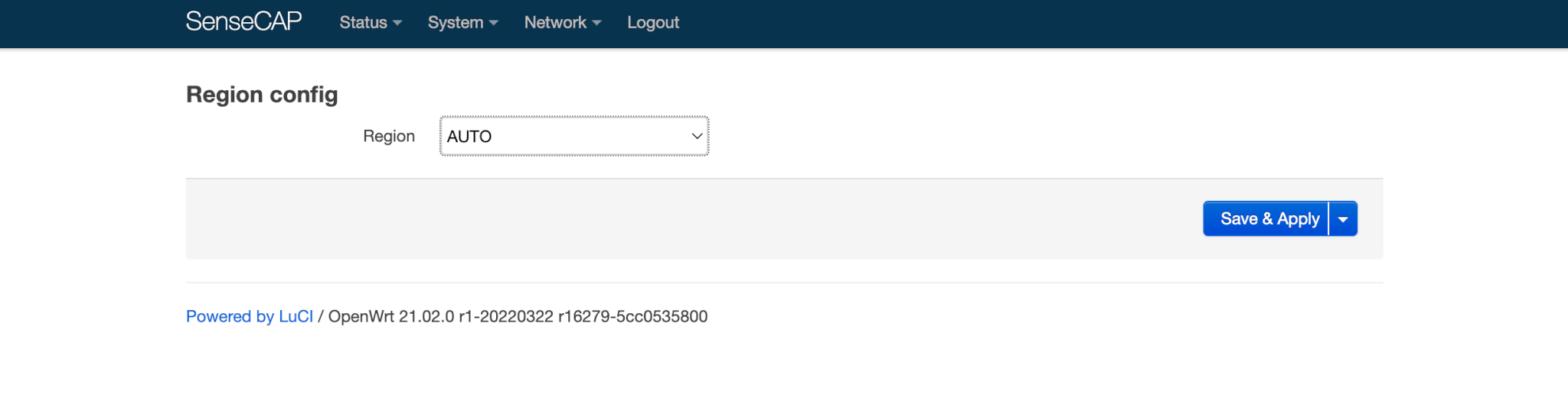

Region​
  • Page Path:System -> Region
Here you can change the region parameter. The factory default is ‘AUTO’, which means:
  • If you do not have an asserted location for the hotspot, the region used is based on your hotspot type, for example, the device model M2-EU868 uses the region EU868.
  • If you have asserted location on the hotspot, Automatic adjustment of the region according to location.
In general, you do not need to set a region. In special cases: If you do not have an asserted location for a hotspot( Data-Only), you can choose another region. For example, the device model of M2-US915 can be set to AU915 in Australia.
SenseCAP M2 Local Console Guide Breathing Region Config
NOTE: If you have asserted location on the hotspot, The Region config MUST be AUTO.

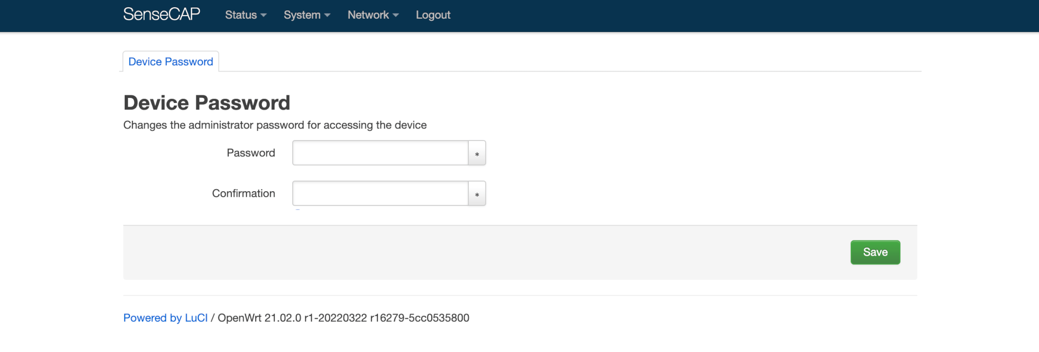

LuCi Password​
  • Page Path:System -> Administration
Here you can change the LuCi Password.
SenseCAP M2 Local Console Guide Breathing LuCi Password
