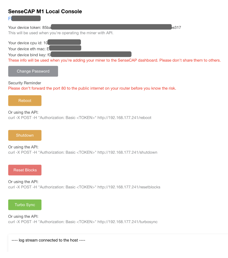

5. Get bind-key and add your Hotspot to SenseCAP Dashboard
Local Console Bind Key
Get the device CPU ID, device ETH MACand device bind key at the Local Console page above.

Reboot
Note: You will need to log in to the Local Console.
Click the orange "Reboot" button to start the reboot process.
  • When you see [reboot] request sent + [reboot going], the process as started.
  • When you see "----log stream disconnected from the host----" and "----log stream connected to the host----", you have finished the reboot process.
Reboot SenseCAP Hotspot
Note: Helium Blockchain ledger sometimes gets damaged by unexpected errors in the micro SD card resulting in the blockchain syncing process to halt on a block and fail in syncing.
Rebooting the hotspot in the Local Console may help to resolve the potential errors in the micro SD card.
IMPORTANT: Please do not reboot the hotspot frequently, only reboot it when necessary.
When the block height is stuck and does not increase, height stays at -1 or 1, please do a block reset. After following these steps, the hotspot will be fully synced again.
Shut Down
The shutdown feature is suggested to use before unplugging the device in order to prevent the device from being damaged caused by a suddenly powering off.
How To Use The Shutdown Feature
Click the "Shutdown" button and accept the prompt.
  • The shutdown will take a few minutes.
  • You will see the blue led and the Ethernet port LEDs are off when the shutdown is finished.
SenseCAP Shutdown Feature
ATTENTION: Please confirm you are next to the SenseCAP M1 when you shut down since you will need to re-plug the adapter if you want to power up the device again.
Reset Block
Click the Red "Reset Blocks" button to start the reset blocks process.
Reset Blocks SenseCAP
Note: SenseCAP M1 will start to load the latest blessed snapshot. The status in the dashboard may have delay and it is normal to temporary see "Unknown" sync status.
If you need to run Turbo Sync, please wait until the latest blessed snapshot is loaded (around 30 minutes).
